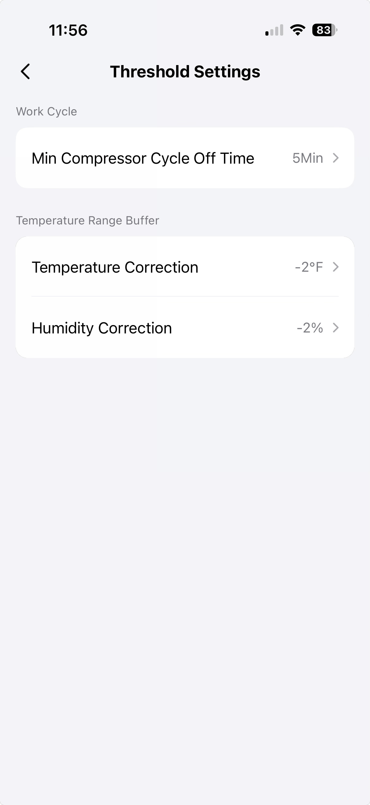

The W200 does offer these settings in the menu, are these any help?
That is only compressor off time and the basic adjusting of the thermostat for correcting room temp/humidity to be accurate.

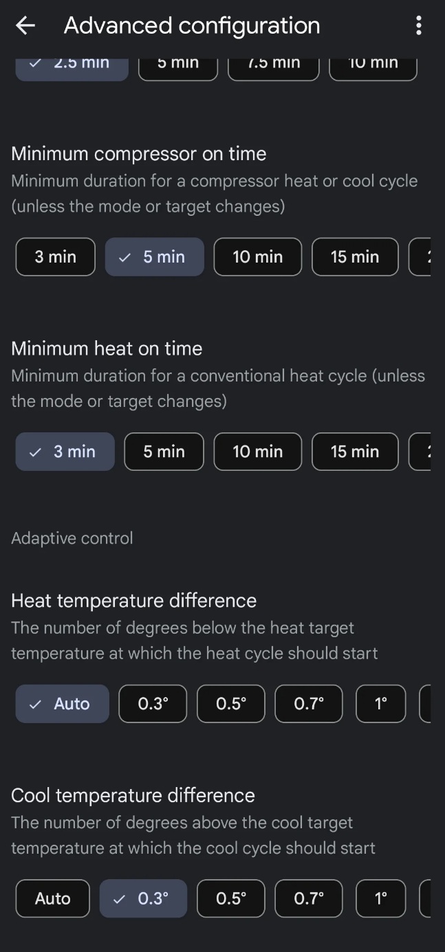

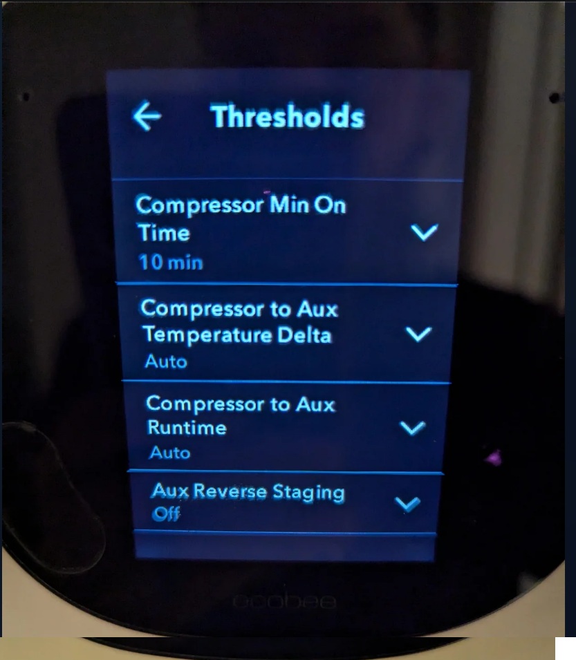

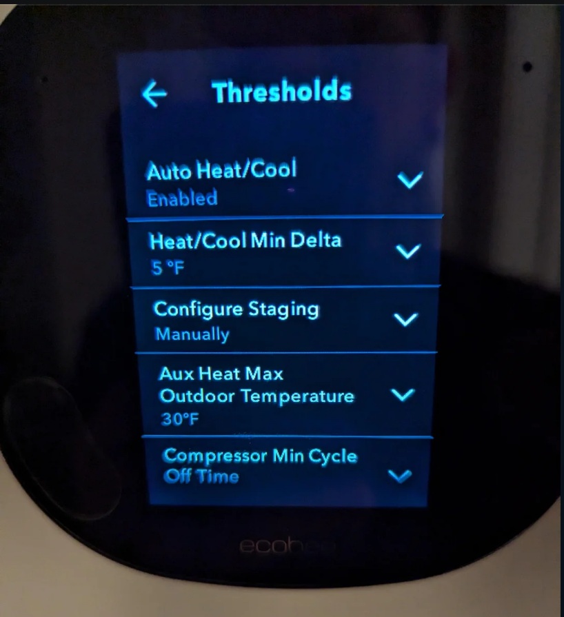

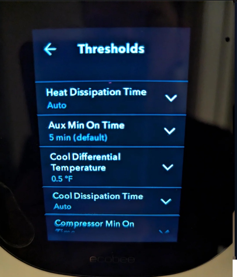

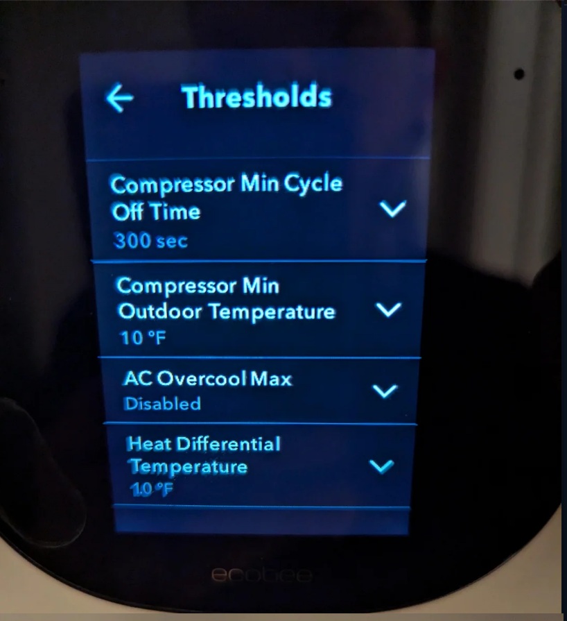

Those dont address any of the missing settings I mentioned or in the screenshots other thermostats have (min compressor on time not just off which prevents short cycles and wear on your AC equipment, differentials for cooling/heating when the system kicks on over/under the set temp, etc).
There are no advanced settings/adjustments really is the issue. Those are the most basic consumer-grade settings. Not my pic, from Reddit, but even Nest has it too. Have to have the basic settings the big players have. HVAC is not one size fits all as everyones is different or sightly over/undersized and needs tweaks.
