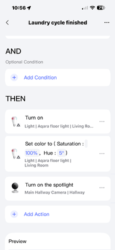

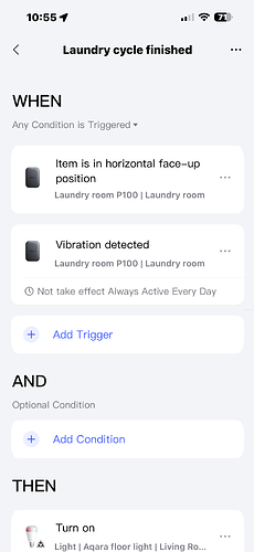

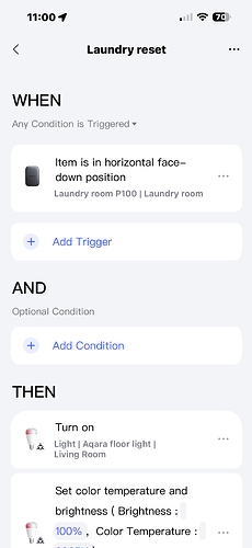

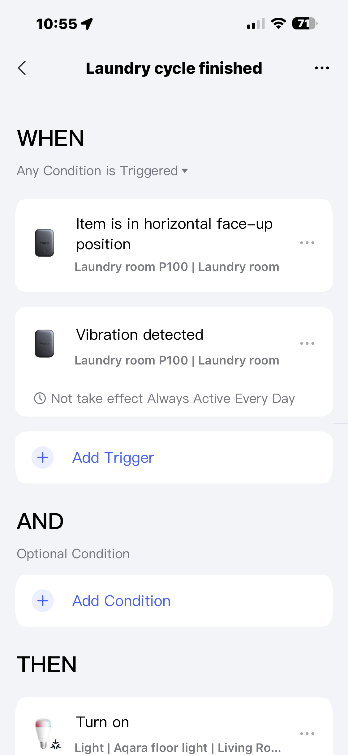

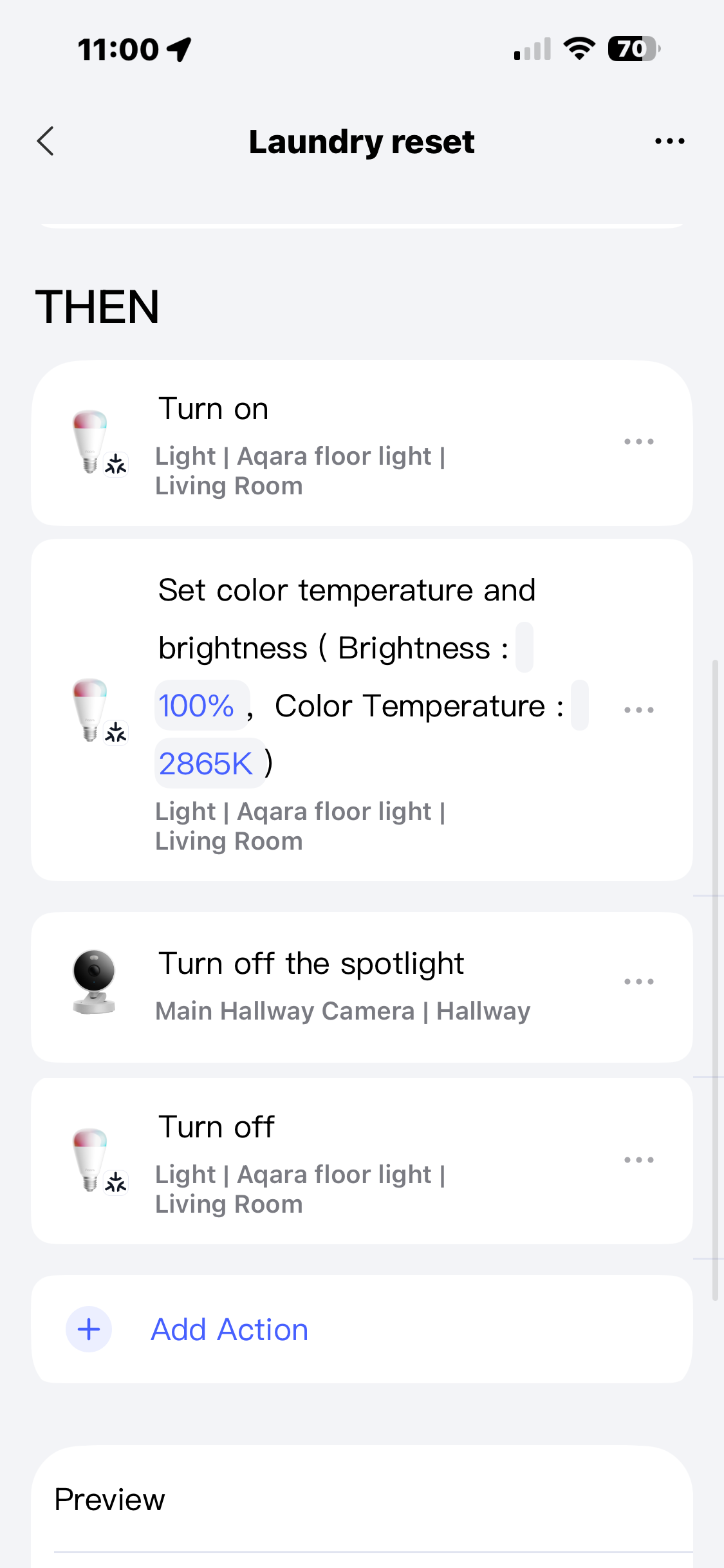

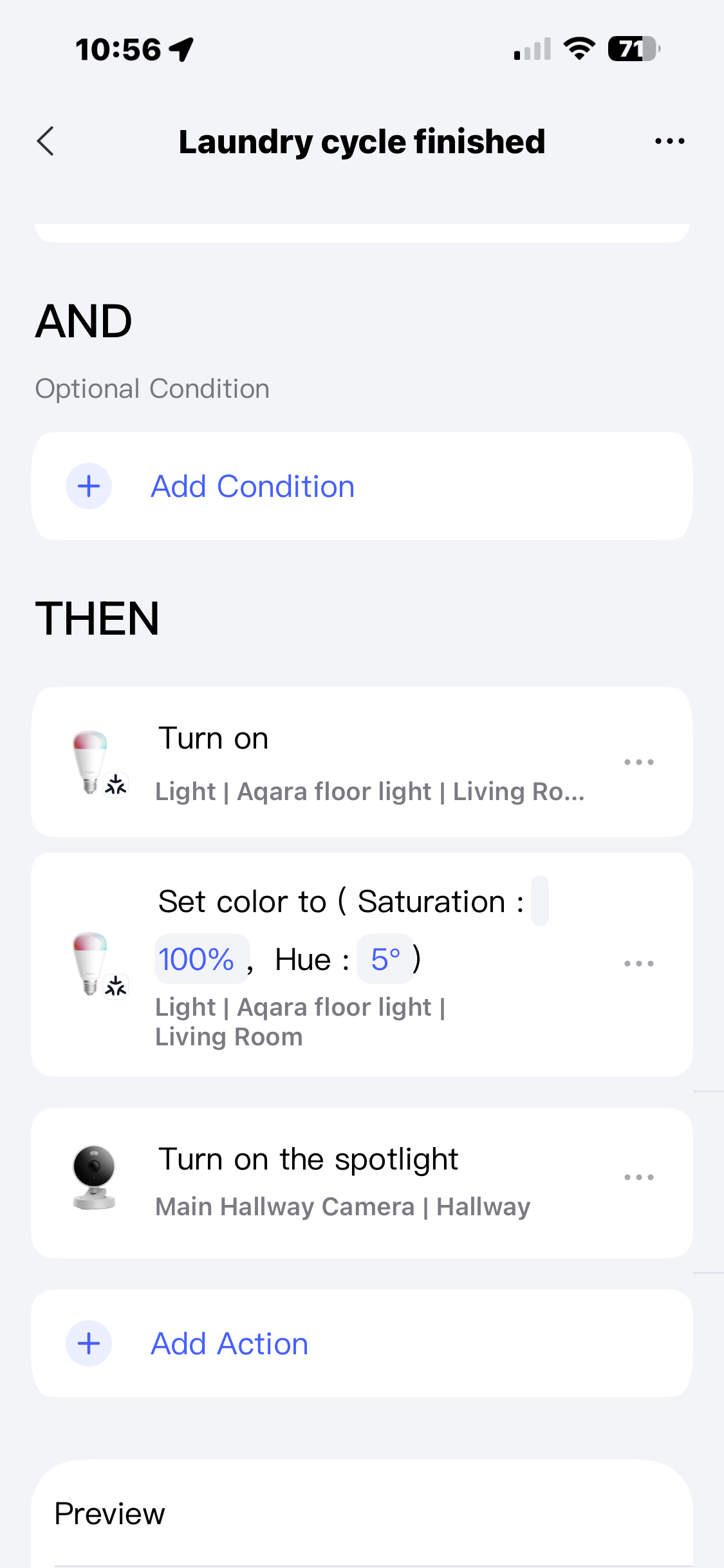

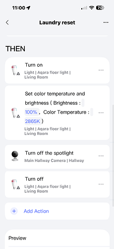

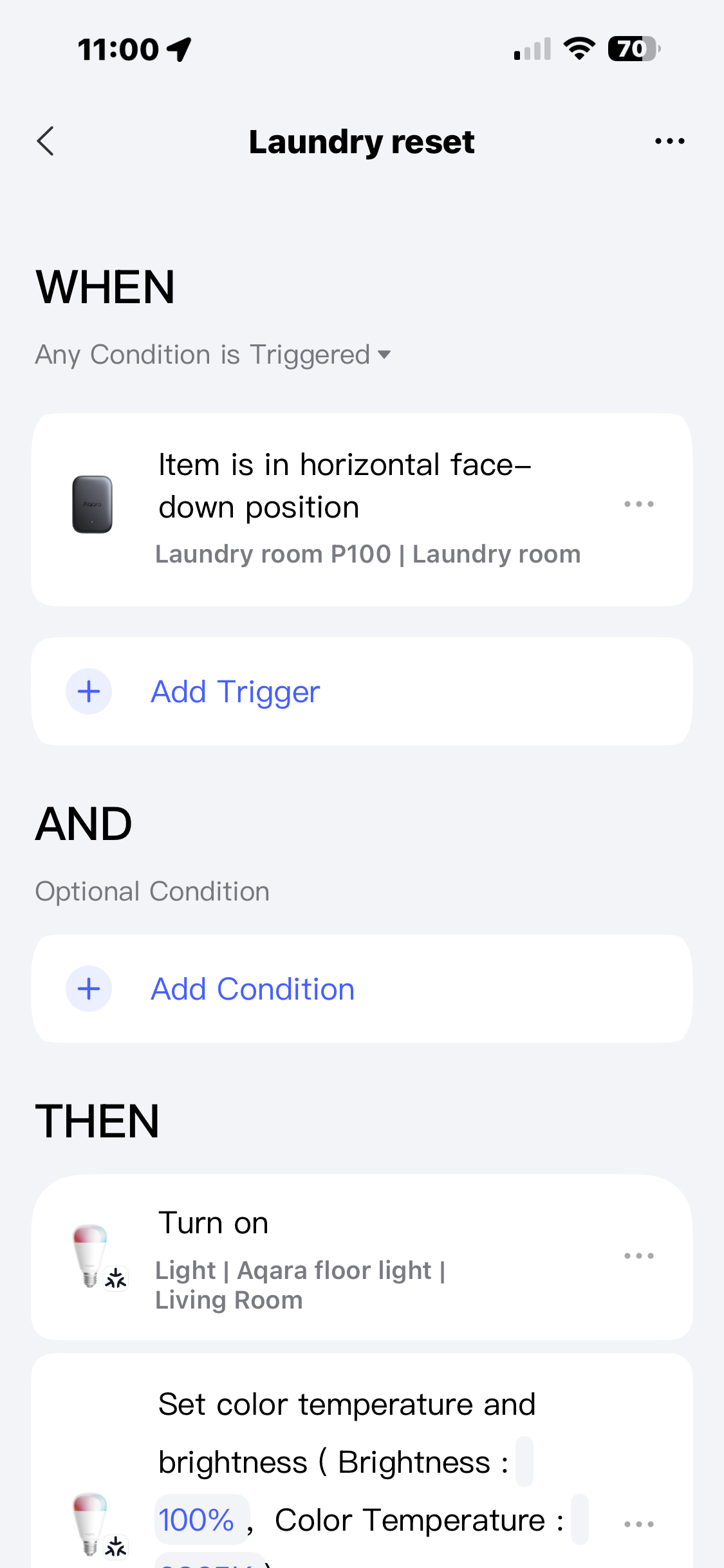

The P100 is an incredible multi state sensor with so much potential. I love all the different uses that users are setting up. I had considered a few ideas but couldn’t let go of the idea of a laundry finished alert. Still having trouble figuring out the washer bit as it stops momentarily between cycles. I have worked out how to get the dryer automation to work fairly well. It’s set up in two different automations one to start the dryer cycle automation and one to reset for the next dryer cycle. The alerting automation will turn on two lights (I also had custom audio alerts, and Aqara notification set up but felt it was a bit much). The P100 starts off facedown and when I start the drying cycle I turn it right side up. Then after the cycle completes I turn the P100 back to the face down position which triggers the reset automation.
I would make one recommendation to Aqara and that would be a Mount that can be rotated so you can initiate different automations on its orientation without removing it from the where you have it mounted. Needless to say, I had to leave mine on mounted so that I could flip it face down and face up to trigger the automations. But I believe if I could attach it to the side of the dryer and turn it similar, automations can be achieved.

hm, so you change the orientation of it manually to indicate the different states? that’s an interesting approach. But in my case, the sensitivity is certainly not enough to make it detect the vibration of my washer. Does it mean that for you it’s sensitive enough?
I try it on my dryer and working perfectly for me.
I tried on my dryer as well and with the sensitivity turned to a 9 it did detect some vibration, but not consistently.
For the dryer it is, but I haven’t tried it for the washer yet. The washer keeps stopping for different cycles, so I haven’t figured out how to account for that gap of no vibrations. So that it doesn’t trigger early. But so far the dryers worked really well.
