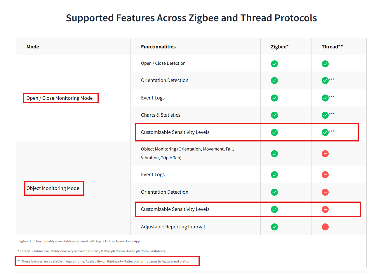

That depends on which mode (Open/Close Monitoring Mode or Object Monitoring Mode) you want to use.
Since Object Monitoring Mode is only available via Zigbee, you can, of course, only adjust the sensitivity there.
In Open/Close Monitoring Mode, you can adjust the sensitivity in the Aqara Home app. For third-party Matter platforms, it just depends on whether or not they support this feature.
Image Source: Aqara Multi-State Sensor P100: Detect Object/Door/Window Status
Therefore, an Aqara hub is not absolutely necessary for adjusting the sensitivity, either via Thread or Zigbee.

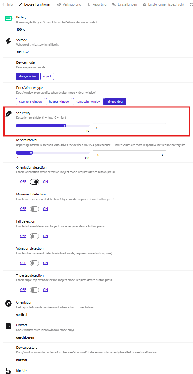

For example, this can be done using a Zigbee coordinator in Home Assistant via Zigbee2MQTT.

The Camera Hub G5 Pro, Camera G2H Pro, Camera Hub G350, Camera Hub G410, and presumably older hubs do not support the P100 currently via Zigbee.
