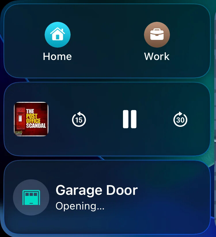

My Aqara U200 doesn't show on the CarPlay widget
Hi, my Aqara U200 isn’t showing up in the CarPlay widget while my garage door opener is. I’ve asked in an Apple forum and it seems the U200 is only recognised as a lock not a door. Has anyone else found a workaround? Other than that it is working well.

The code I posted above will allow apple carplay to show the lock natively while in the combined apple screen (the one showing the map as half a screen) When you get into range of your home the lock will appear on the bottom of the screen allowing to you interact with it. When leaving home the lock will show until you pass a certain distance and then it will disappear.
It is a “hack” by using home assistant, but by using the code I posted to create a “cover” inside home assistant and then exporting that new entry via homekit bridge to homekit.
IMO this is the most elegant way to do it.
