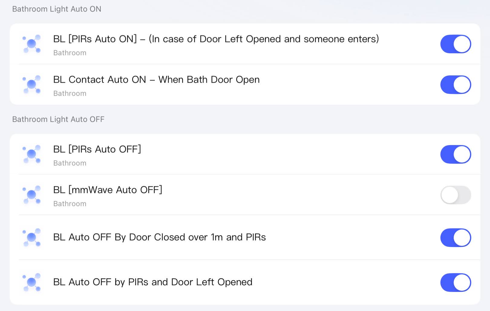

My goal to make this bathroom smart are automating lighting and ventilation (exhaust fan) for any bathroom circumstances, for example, when using toilet :poop:, when showering :shower:, when doing some sus business :thinking:, or anything. The light has to turn on automatically when someone gets inside, and has to stay on as long as they’re inside the room, and the exhaust fan has to run all the time when someone’s in the room to keep it well ventilated. And they have to be turned off shortly after someone gets out of the room.

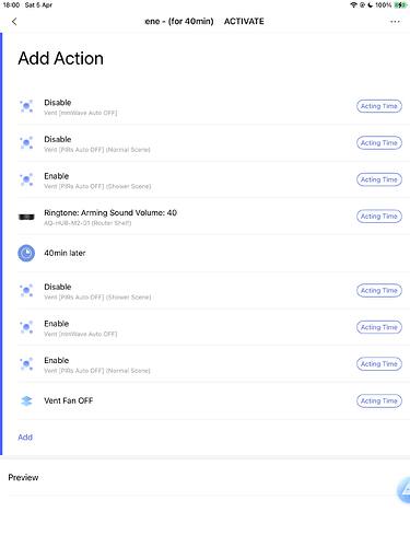

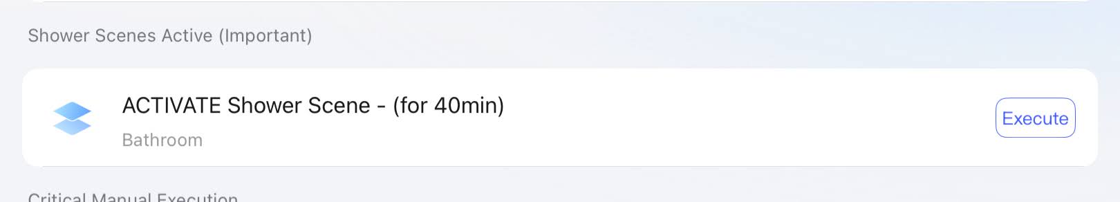

But there’s a special circumstance, showering. This is when the scenes (on the Aqara app) come into play. After showering, the exhaust fan has to run 10 more minutes after my shower valve shuts off to reduce moisture or steam that builds up in the room. With this showering circumstance, the light turns off shortly after I leave the room, but the exhaust fan will continue running [it will ignore the automation I mentioned above in this special (showering) circumstance]. It not only helps reduce the steam and humidity (even though it doesn’t help with humidity much for just 10 minutes of running fan), but something that’s clearly improved are tVOC and CO2 (tVOC and CO2 sensors are not parts of this automation but I usually read the values they collect) inside the bathroom and my living room (which is connected to the bathroom). So this solution is like a daily active ventilating time for my house whenever I take a shower (usually twice a day since the weather is too hot here in SEA.).

  • 1 x Aqara FP2 used to detect human presence. To get the exhaust fan running. To get it light on.

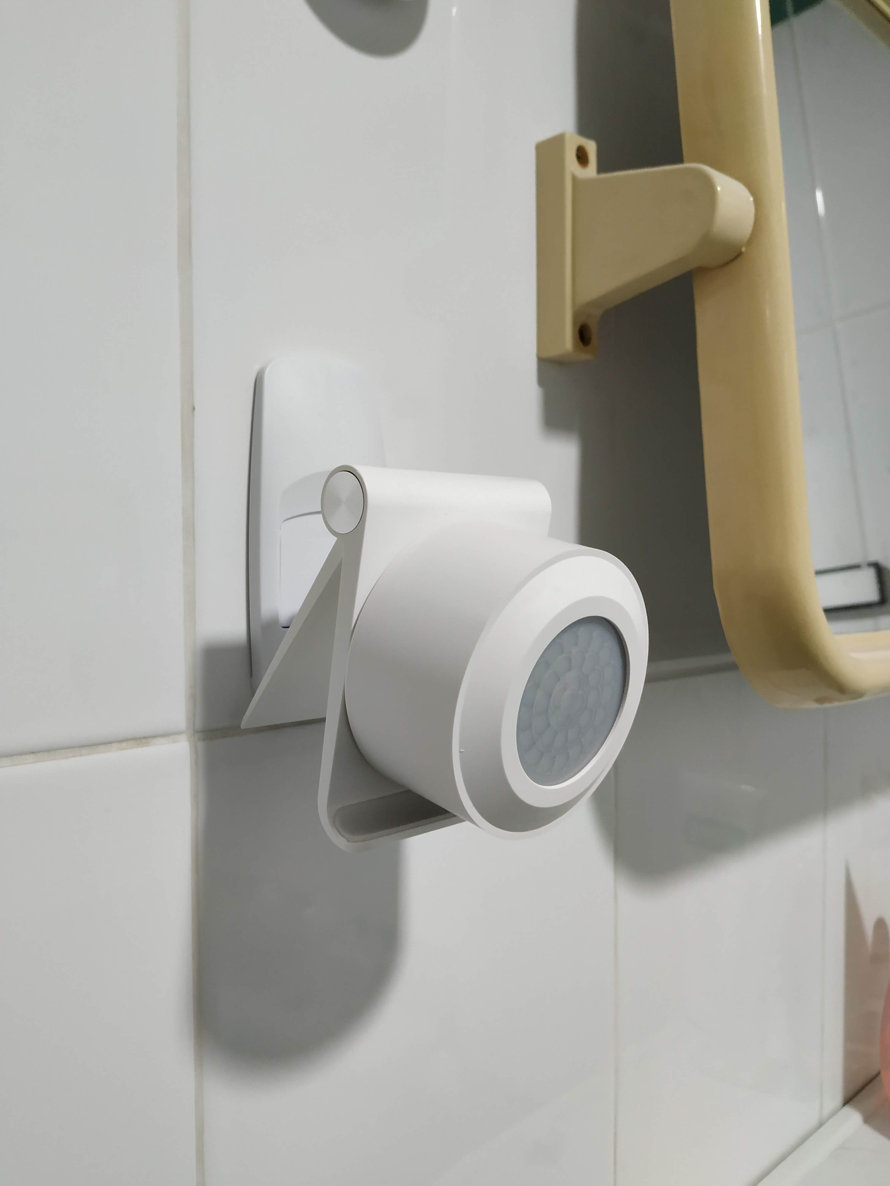

  • 2 x Aqara High Precision PIR Motion Sensor used to detect a quick motion (as you may know, the PIR is a bit faster to detect occupancy) so I used it to get the light on when detects motion, and to cross-check with the FP2 in case the FP2 fails to detect absence, these Aqara High Precision PIR Motion Sensors will get the light off automatically. The reasons I use this High Precision Motion Sensor model particularly (not the original Aqara PIR or the P1 or P2) are that it is very sensitive and precise with a very quick detection interval.
  • 2 x Aqara Contact Sensor
The first one is attached to the bathroom door to automate the lighting to be on instantly when the door is opened (to get the lights off, I use the FP2 Presence Sensor exit detection).

  • 2 x Aqara T1 Switch Module with Neutral used to control my LED bulb (dumb bulb) and the exhaust fan.
