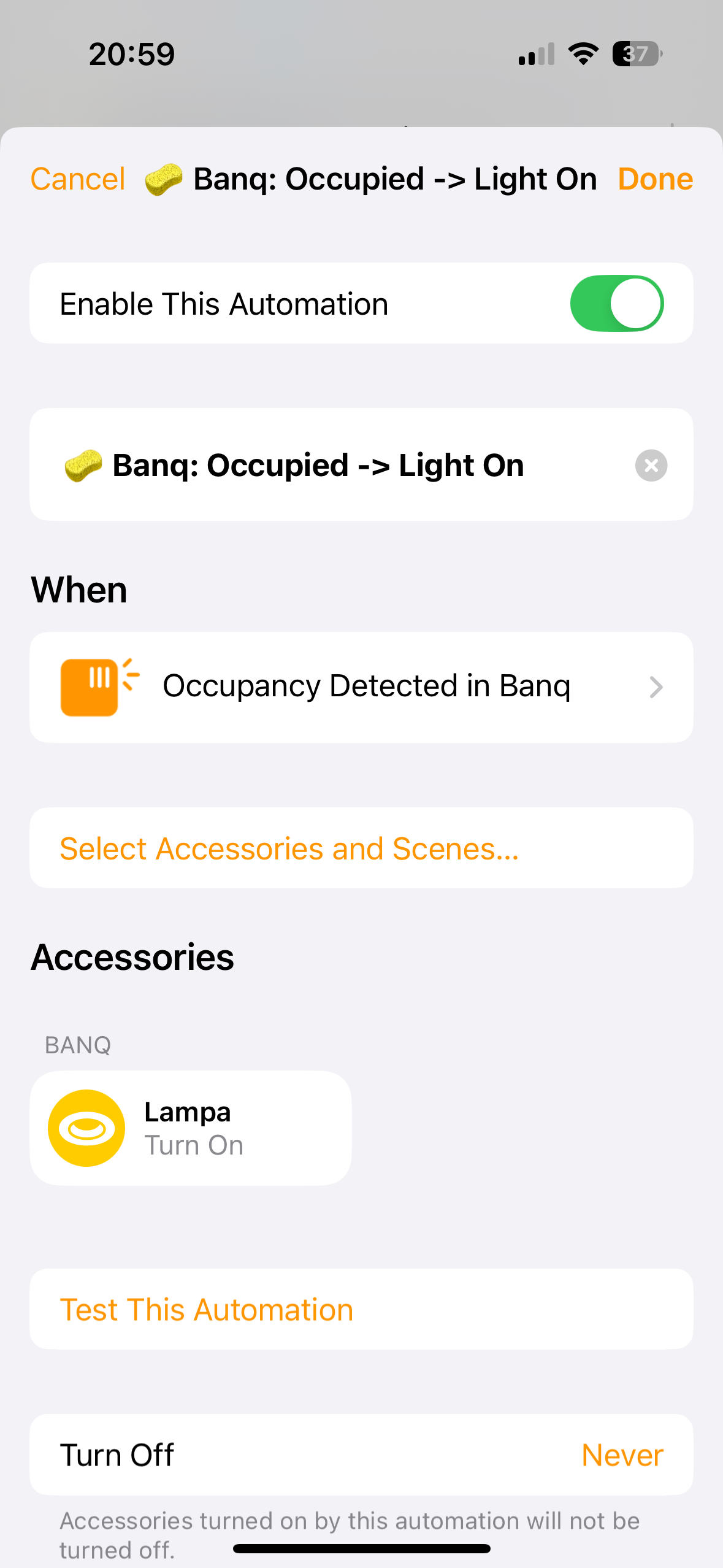

1. Bathroom lightning
This started as simple as door open → light on and when no presence → light off, however a UX bug appeared when people unaware of the automation started using it.
My light is controlled via the Single Switch Module T1, which is wired to a physical light switch and it turned out that every single person entering the bathroom was almost simultaneously first opening the door (or their presence was detected if door was already open) and then flipping the light switch which resulted in light turning on and off again, due to the light switch.
Their faces were always looking like a lightbulb was burned ![]()
So in order to solve this, I had to figure out a way to prevent people from turning the light off accidentally.
Device List:
- 1x Aqara Door and Window Sensor
- 1x Presense Sensor FP2
- 1x Single Switch Module T1 (With Neutral)
Automation Rules:
- when the door opens then turn the light on
- when the door closes and not occupied then turn the light of
- when not occupied then turn the light off
- when occupied then turn the light on
- [Keep light ON] if light turn off then turn light on - this automation is enabled/disabled via the next automations which allows selectively to keep the light on
- if door open then enable [Keep light ON], wait 5 seconds, disable [Keep light ON]
- if presence and door opened for over 1 min then enable [Keep light ON], wait 5 seconds, disable [Keep light ON]
