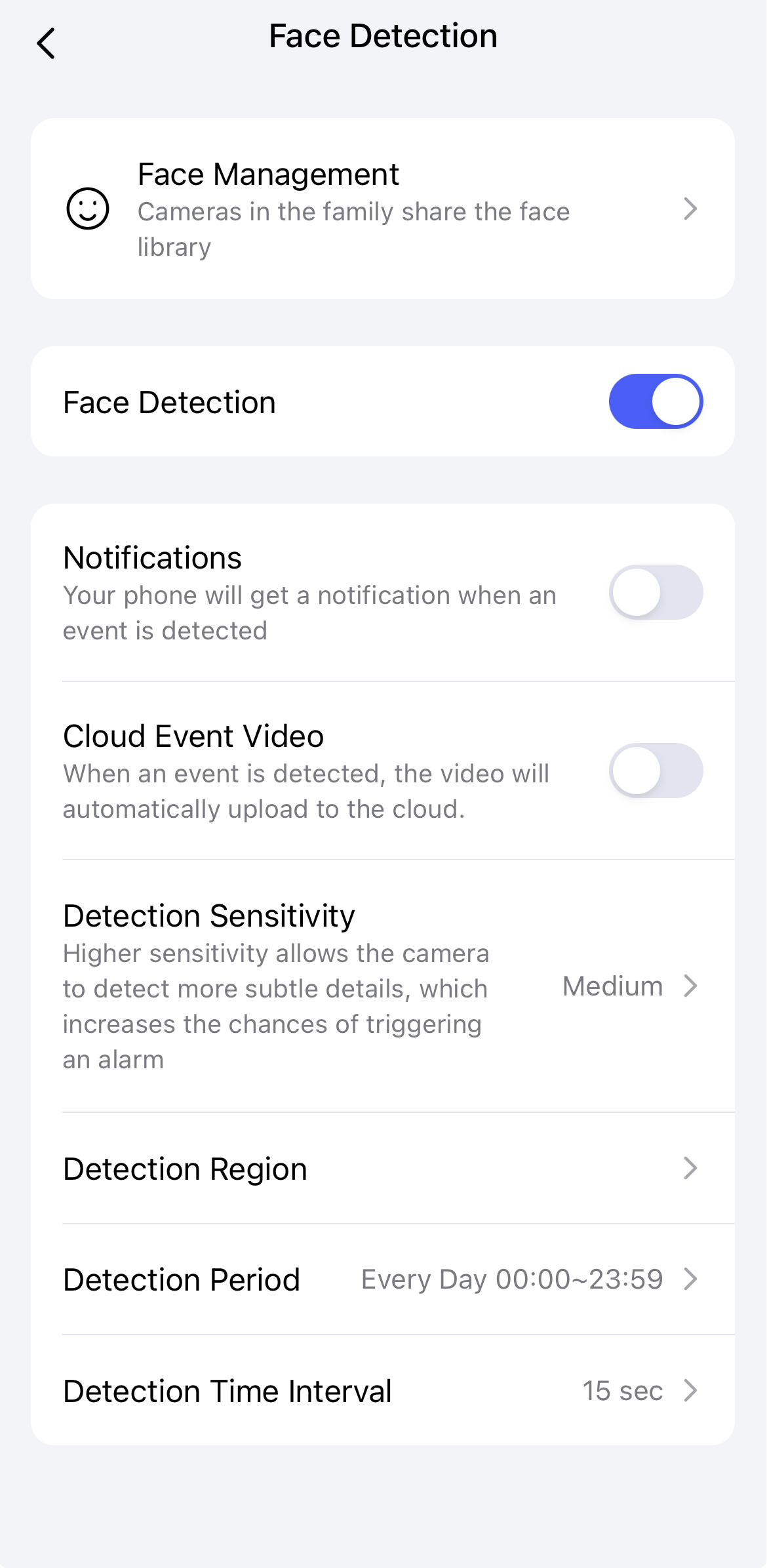

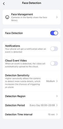

Under “AI Detection,” I have the following settings for “Face Detection”:
The default value for “Detection Time Interval” was particularly problematic for me. That’s why I set the value to 15 seconds.
Try setting “Detection Sensitivity” to “High”.

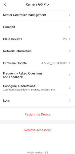

If that doesn’t help, click the “Restart the device” button. I think that button is new, too. Restarting sometimes works wonders.

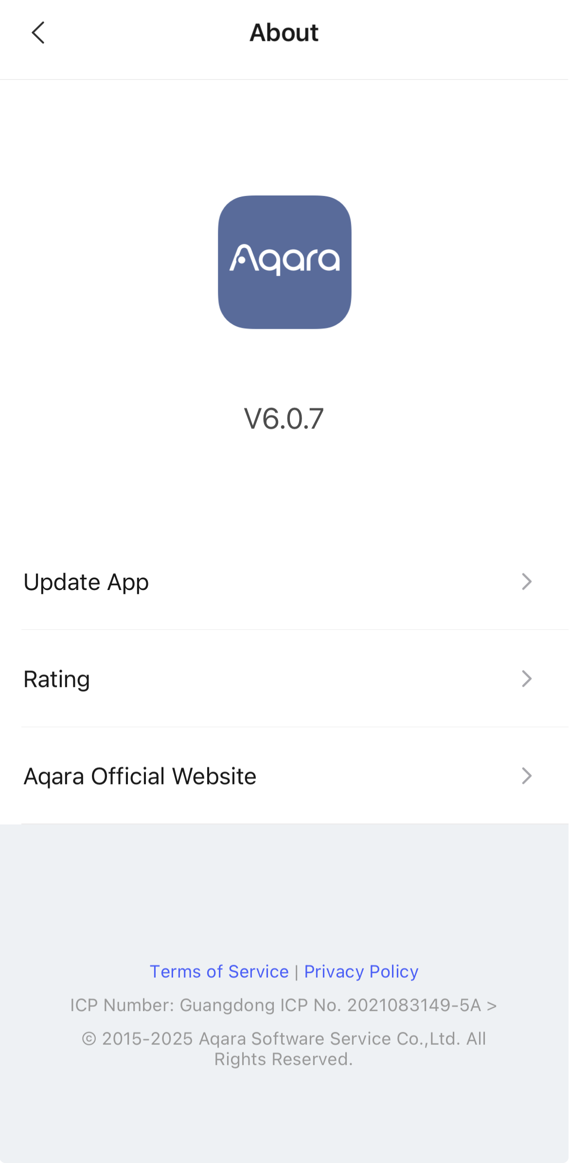

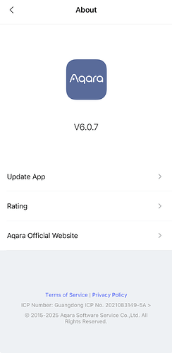

Do you really have the same firmware version installed? And tell me please, which app version do you have installed?

Hello, everything works! Insert a period of 3 minutes, for some reason it stopped working after a shorter time. I will make a request to explain the situation.
Note, once a shorter time (15s) required a subscription and was grayed out (inactive)
Do you mean the “Detection Time Interval”? Well, I can set 15 seconds on my G5 Pro WiFi and G5 Pro PoE without a subscription.

Finally we fixed this issue we were talking about.
New Firmware available today.
4.5.30_0004.0017
