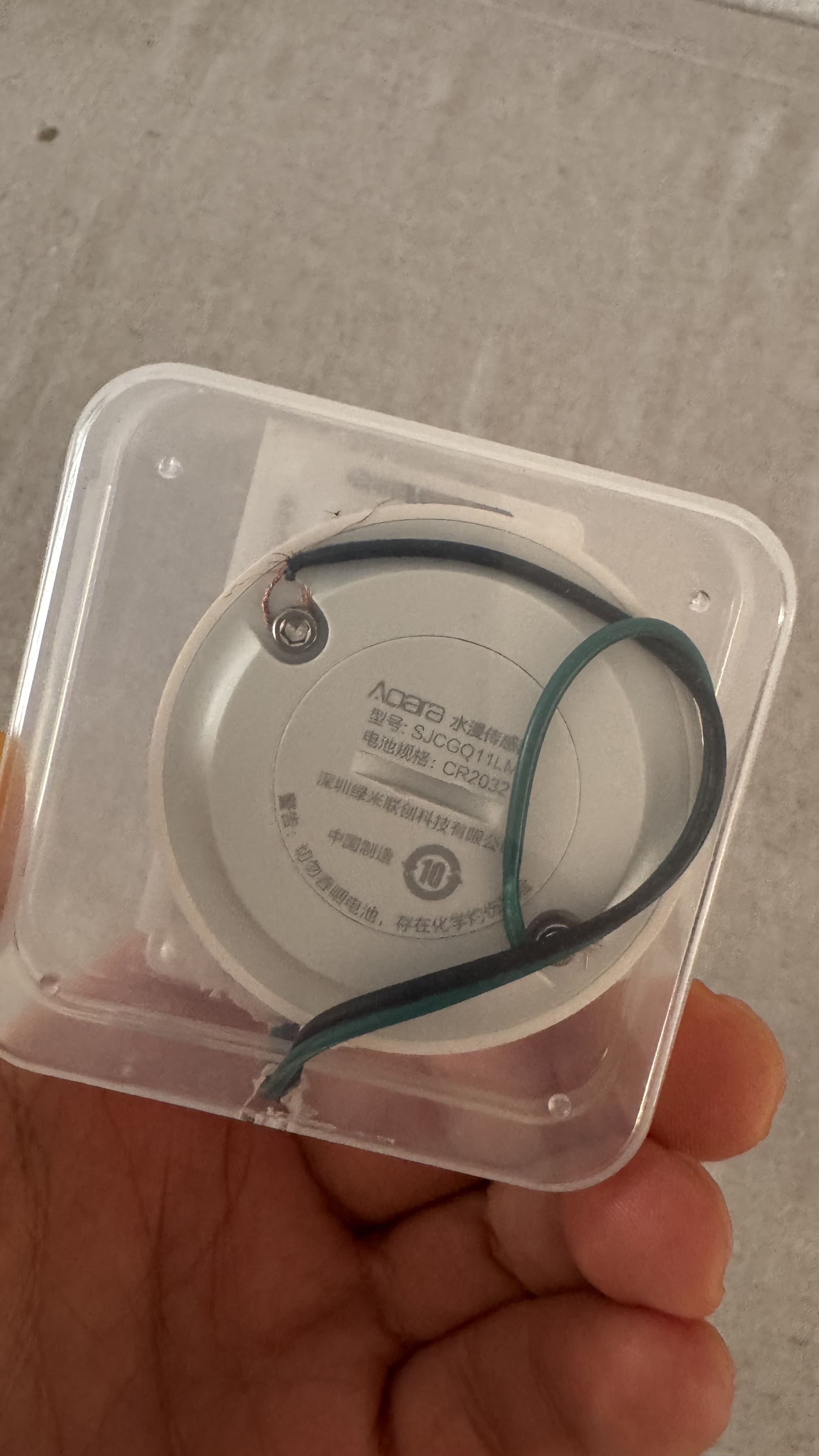

Hello to everyone!!! Today I like to present to all of you my new project, that I was thinking on it for quite some time to make it and I wasn’t sure how to do it in order to be less expensive, to make and be effective so I can integrate it on my smart home.So today I present to you my Rain sensor.

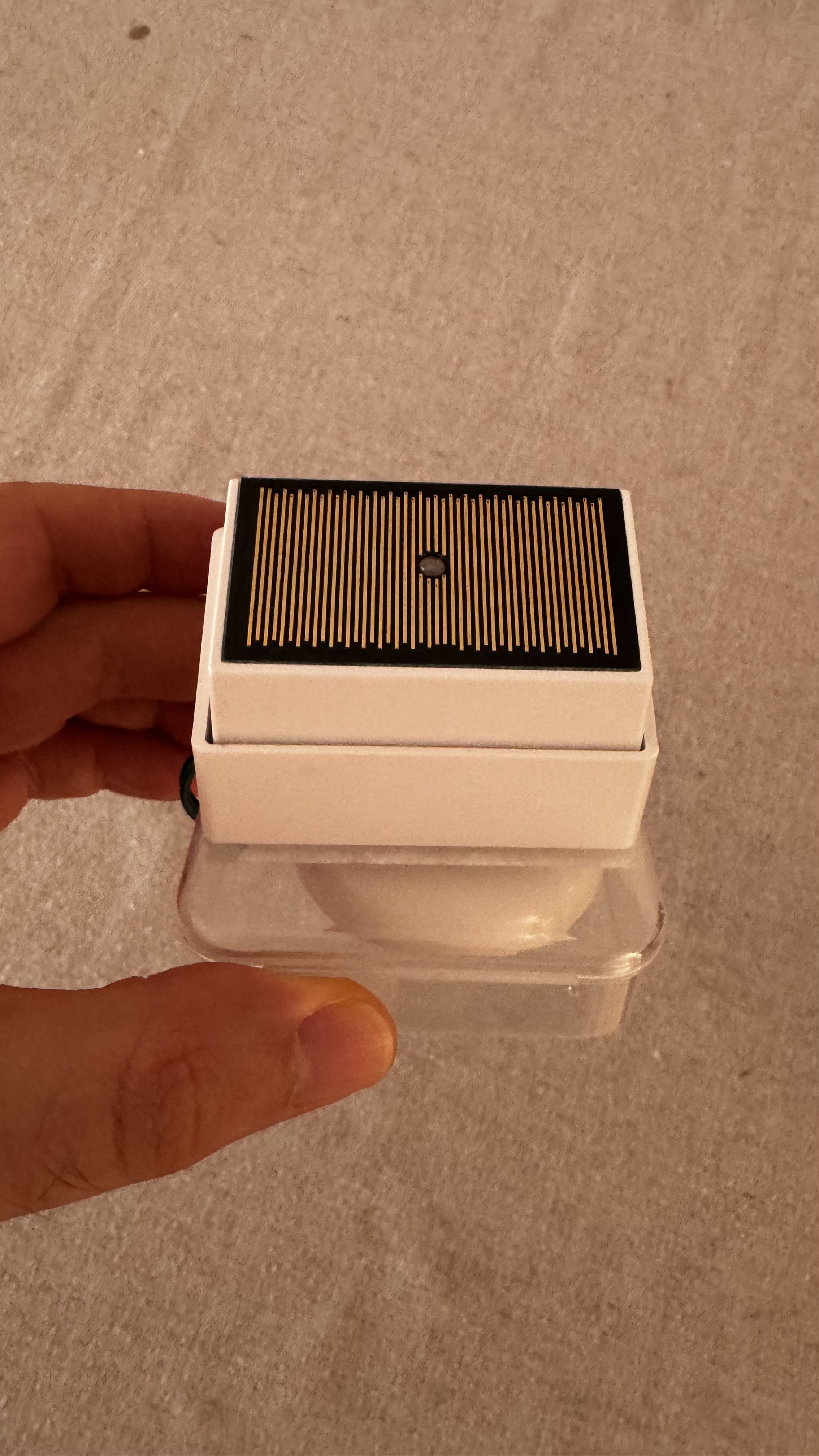

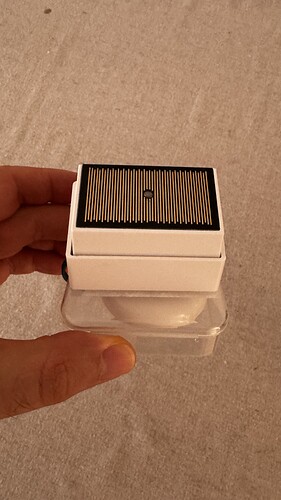

-this sensor is made from an rain sensor from tuya witch clearly I do not use so I take all out and just let the sensor plate and an Aqara water leak sensor.when I bought it from the pictures I tough will be a bit larger but when I got it I was a bit disappointed as the case was to small and the Aqara water leak sensor didn’t get inside that sow yesterday I stayed all day to think how or were to place the Aqara water leak sensor in order to not have to glue it.sow I was searching for an small box around my house and I found one witch suits well.there rest was easy to do as I just had to solder new cables to that sensor plate and screw them to the aqara water leak sensor.And it works perfectly.Why I did this you my ask?well in were I live in Spain when comes the rain many times it comes with dust and making this rain sensor it will help me to automate my roller blinds so my windows doesn’t get dirty as cleaning windows is an pain :rofl::rofl::rofl: more when I have to clean them mi self as my wife is smaller in height and can’t clean them all the way to the top.Now the only thing that I need to think is to we’re to place it as I have my patio but I also have an balcony and more important how to mount it.But at least it is ready to be used in automations.i hope you like it and I really hope that aqara will make such an sensor dedicated for rain snow and wind.just wanted to share my creation!!

Well you just get an notification from what I test it but is enough that least for me to lower my blinds :rofl::rofl: since this is not an normal rain sensor I do not know exactly how it will work once will rain but once I have an idea I will post it here how exactly works.as of now I just drop a bit of water on that top plate and in a few sec I get the notification not sure I think is 1/3 sec.also the great thing is that you can turn off the notification from HomeKit in my case and let the automation running only.ether way since is using an Aqara water leak sensor you can have an idea on how it will work more or less at it will be base on the water only that I take it off from my basic guard were are my others water leak sensors and the smoke detectors this way will work independently.

Well after a few weeks of testing this rain sensor i made I have to say that it works perfectly it detects water fast when it rain and I made an automation so when water is detected to lower my roller blinds shutter down and I have to say that I was surprised that worked very well.the only downside is that plate witch I have seen some rusty spots on it already but still works as the spots are small.
