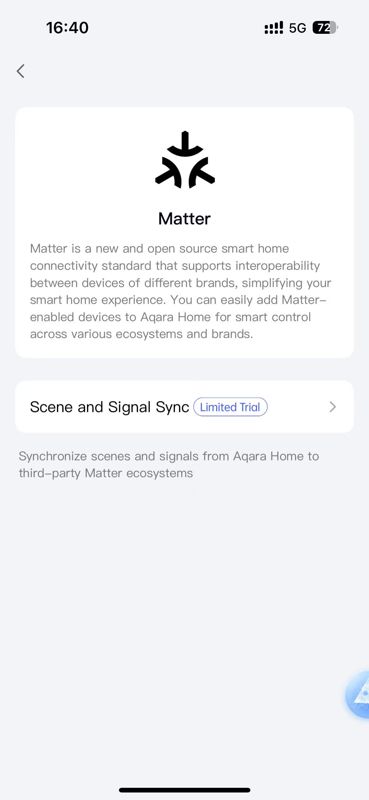

Due to the recent release of the Advanced Matter Bridging feature, it is currently in a “limited trial” phase, and therefore we have imposed a quantity restriction. Sorry for any inconvenience caused. We will also reconsider the quantity restrictions.
Actually, the main purpose of this “signal” is to bridge private features not supported by Matter to Home Assistant as automation triggers. Devices supported by Matter can be directly bridged to Home Assistant to create automations.

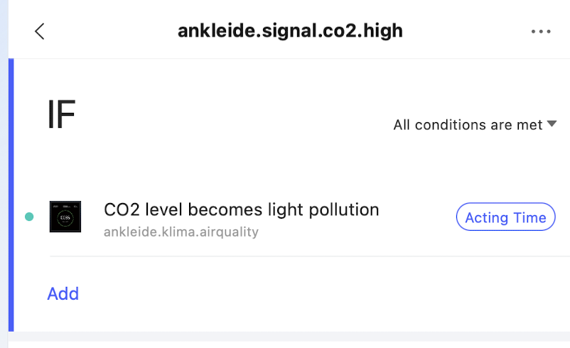

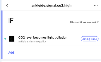

In my case, these are decentralized ventilation units in different rooms that ensure fresh air. Simply switching them on or off with a relay is not enough – they can push air out, pull fresh air in, or run in an oscillating mode (using a ceramic heat storage core to save energy in winter). On top of that, their performance can be adjusted from 0–100%. And in Home Assistant, I also combine this with other information such as indoor and outdoor temperature to make the automation smarter.

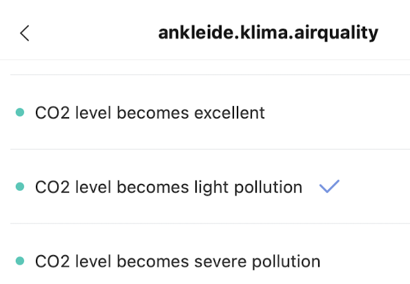

My plan was to use the Aqara S1 Air Quality Sensors to steer them, since the sensors provide signals like “CO2 level becomes excellent / light pollution / severe pollution.” With five sensors, that’s already 15 signals going to Home Assistant. Add a few more signals, and you hit the limit very quickly.
That’s why I would really appreciate it if Aqara could lift this restriction – otherwise, it’s almost impossible to use the signals in a meaningful way.

Since these button events are not exposed directly through Matter for all switch models, I rely on your Advanced Matter Bridging feature (Scene & Signal Sync).
Unfortunately, I have now reached the maximum number (15) of virtual signals, preventing me from integrating additional switches.
