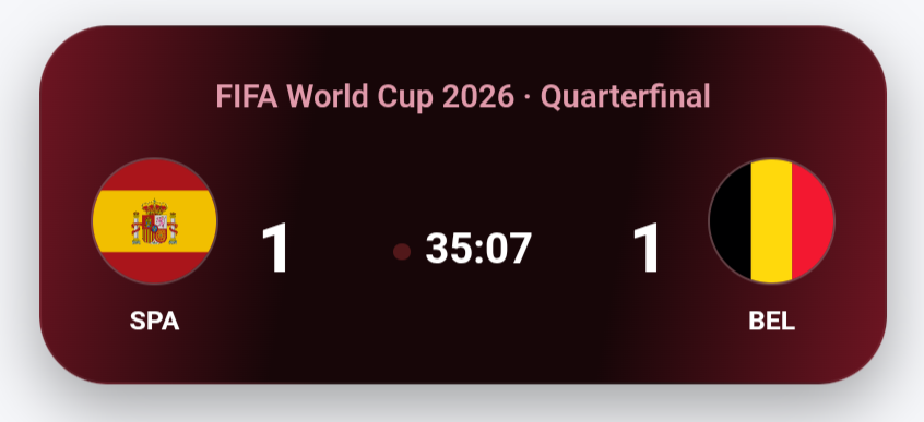

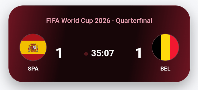

I want to thank you to open your Cloudflare worker with your API-Endpoint.

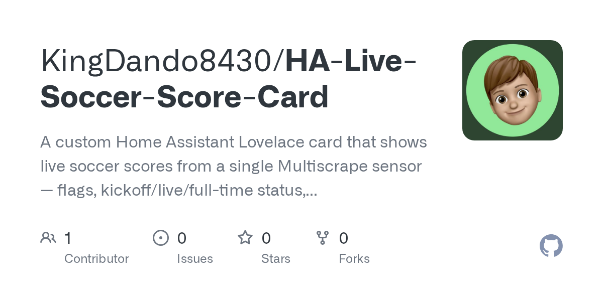

As I see, you also use Home Assistant, so you might be interested to test my custom
Card that works with your Multiscrape Sensor.
But to make it more accurate (especially the time) it would be nice if you could add two additional attributes to the Multiscrape Sensor and update your worker:
  • game_running to show something like live halftime fulltime (in addition to the Ongoing-Attribute, which stays true during halftime.
  • kickoff_time shows the exact second from the kickoff in the 1st and 2nd half as timestamp
Only some ideas for you :slight_smile:
Oh, this is great! Thanks for sharing @KingDando! I really love the clean look of the card.
Time to replace my crude Markdown-based card
If I find some time, I’ll try to extend it. That’s then probably also the time to switch to JSON
Thanks. It’s nice to hear if you like it.
If you updated your worker and sensor, let me know and I will update my custom card.
You see it then, if you used HACS
Sorry @KingDando, I didn’t find the time to extend the worker. We’ll do it for the next world cup :slight_smile:
No problem. As is seen in the code, you’re from Germany? Because your entity_id’s are German like the Wohnzimmerlampe :wink:.
So maybe your worker gets a job two years earlier to the Euro Cup 2028?
Haha… yeah, let’s see. Maybe we reactivate it then already :slight_smile:
