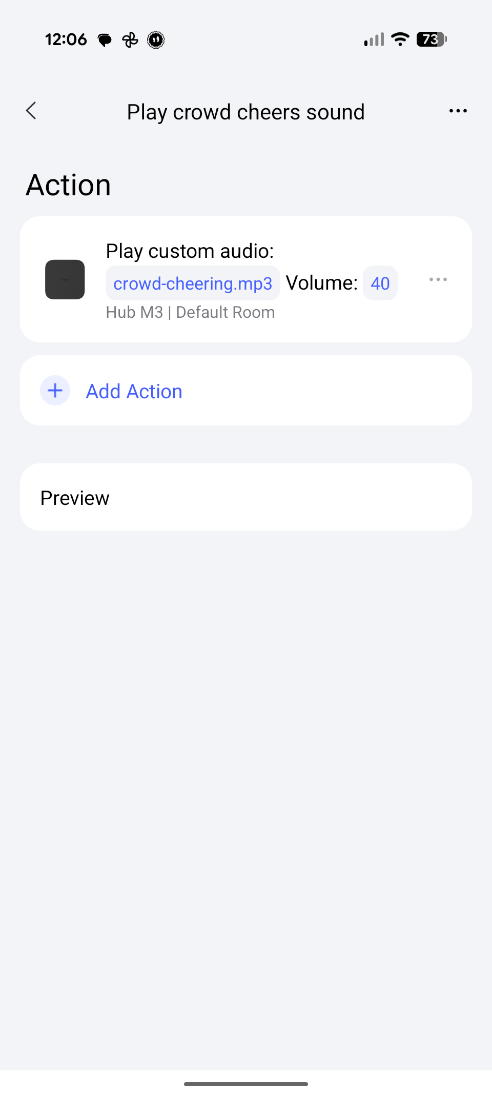

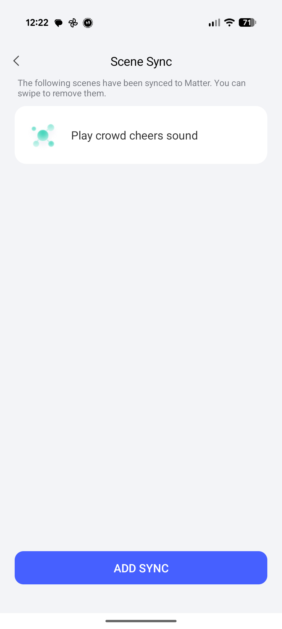

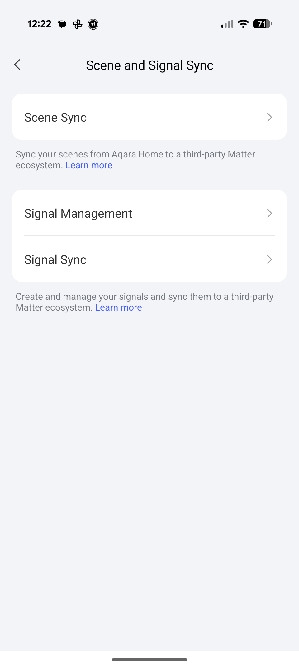

To pull this off, I’m leveraging the Aqara Hub M3 alongside my existing Home Assistant configuration. Here is how I got it working:
  1. Custom Sound Effects: I downloaded a great cheering crowd sound effect from Pixabay (specifically this one) and uploaded it directly to the Aqara M3 Hub.
  2. Matter Integration: I created a scene within the Aqara app to play that specific cheering sound, and then exposed that scene via Matter directly into Home Assistant.
