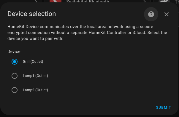

Tried adding the HomeKit Device integration, but it does not offer me the choice of FP2:

There is no HomeKit Controller integration in Home Assistant. All the HomeKit integrations I could find are HomeKit Devices and HomeKit Bridge.

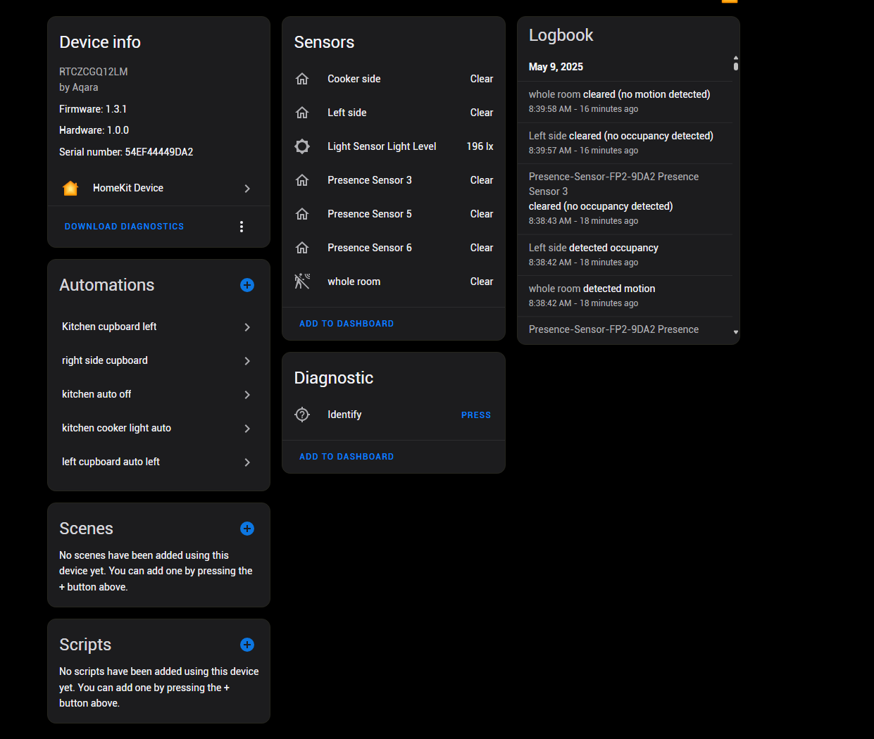

its easier to setup via homekit on a phone then remove and it adds it will be autodetected by home assistant, but reset the device, add it to the aqara app connect to wifi setup zones, then once done unplug it, wait about 20 seconds after plugging it in and go to settings/integrations/apple/homekit it should pick it up… its a pain but should work, node red is not needed but once added the zones will not have the names and you will need to work them out and rename in home assistant
I’ve successfully added 4 FP2s to HA by setting them up on Aqara app/HomeKit, then removing them from HomeKit, so HA discovers them.
But there’s a BIG black hole.
Only 3 entities are presented to HA: identity, light-sensor and presence (yes/no).
No room mapping, no persons count etc…
When will Aqara finally release a full official HA integration add-on?
you have done something wrong then, remove from homekit home assistant and then reboot you should get auto discovery as this is one of mine
