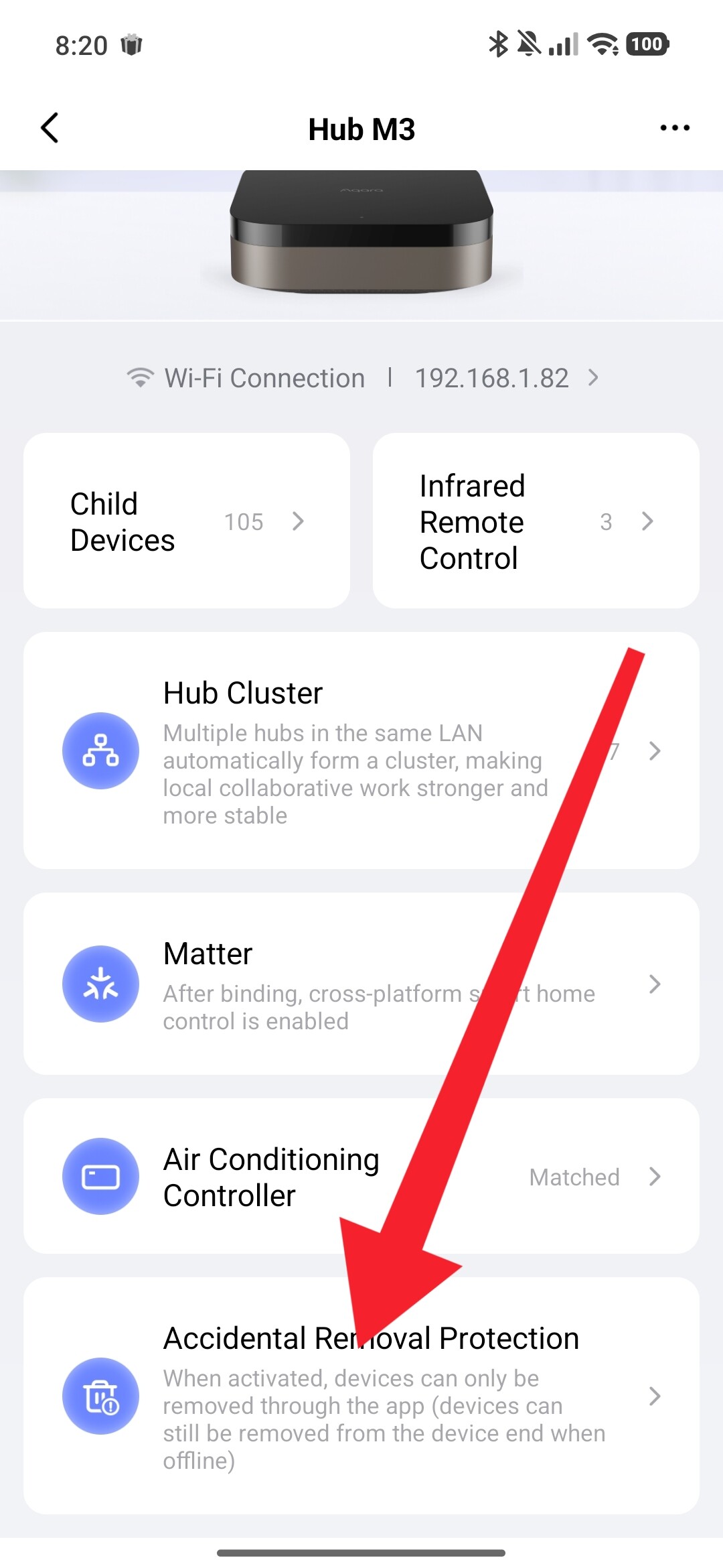

Hello all, I need some help on adding the (Matter) W500 back into my Aqara system and Apple home. I deleted senor in both Aqara app and Apple home. I’ve tried adding back via pressing down the reset button on the backside and it’s either not pairing or when it does and goes through the Matter information it’s saying in the Apple home app to try and reset before adding again.

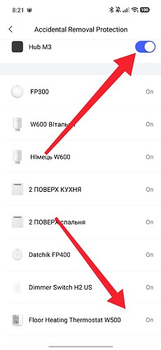

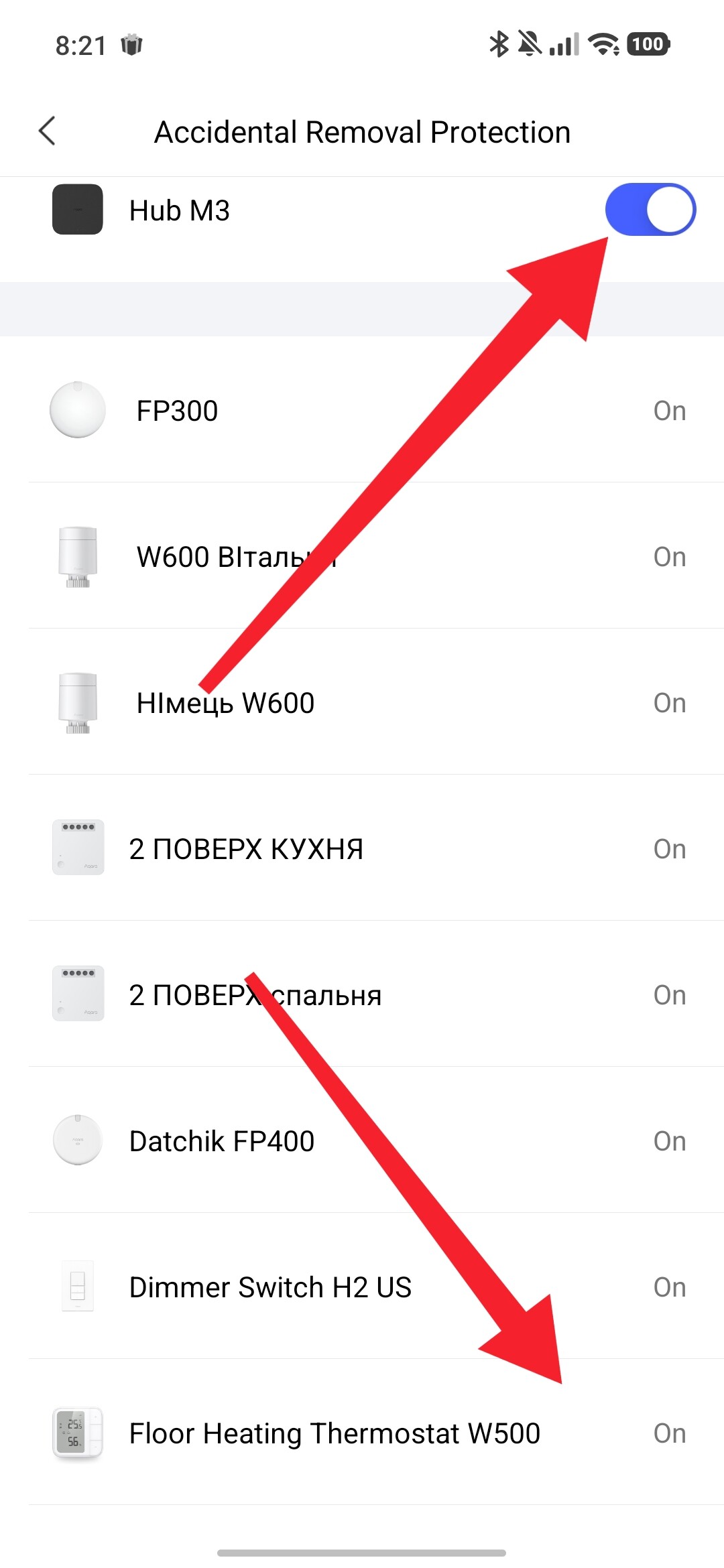

Hello, check if deletion protection is disabled in the gateway settings.
