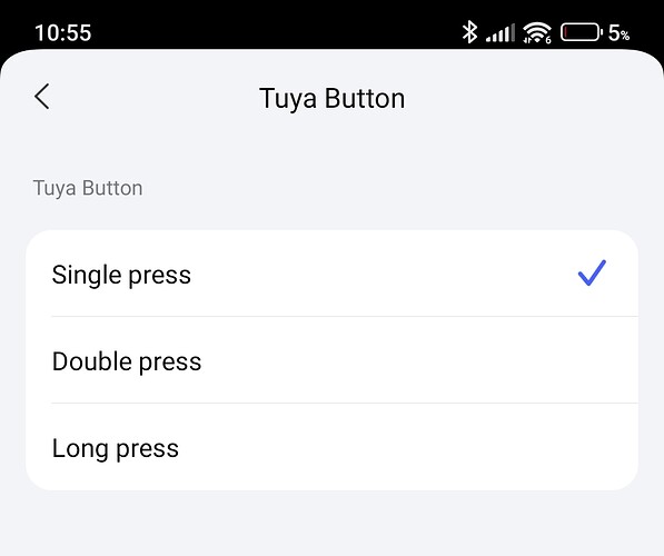

How it should be exposed to make it work with aqara? what type of device?
@mocelet @JohnD

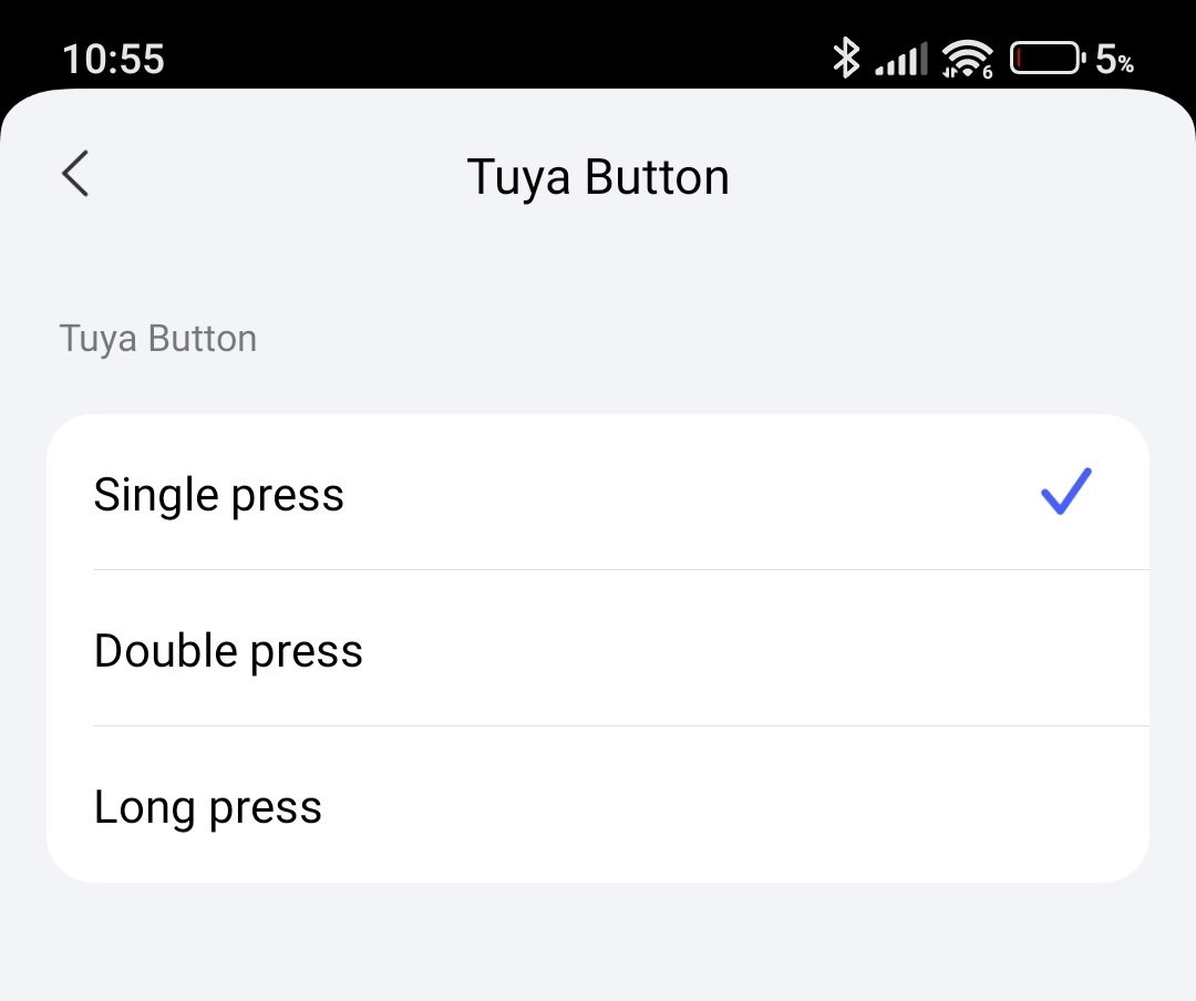

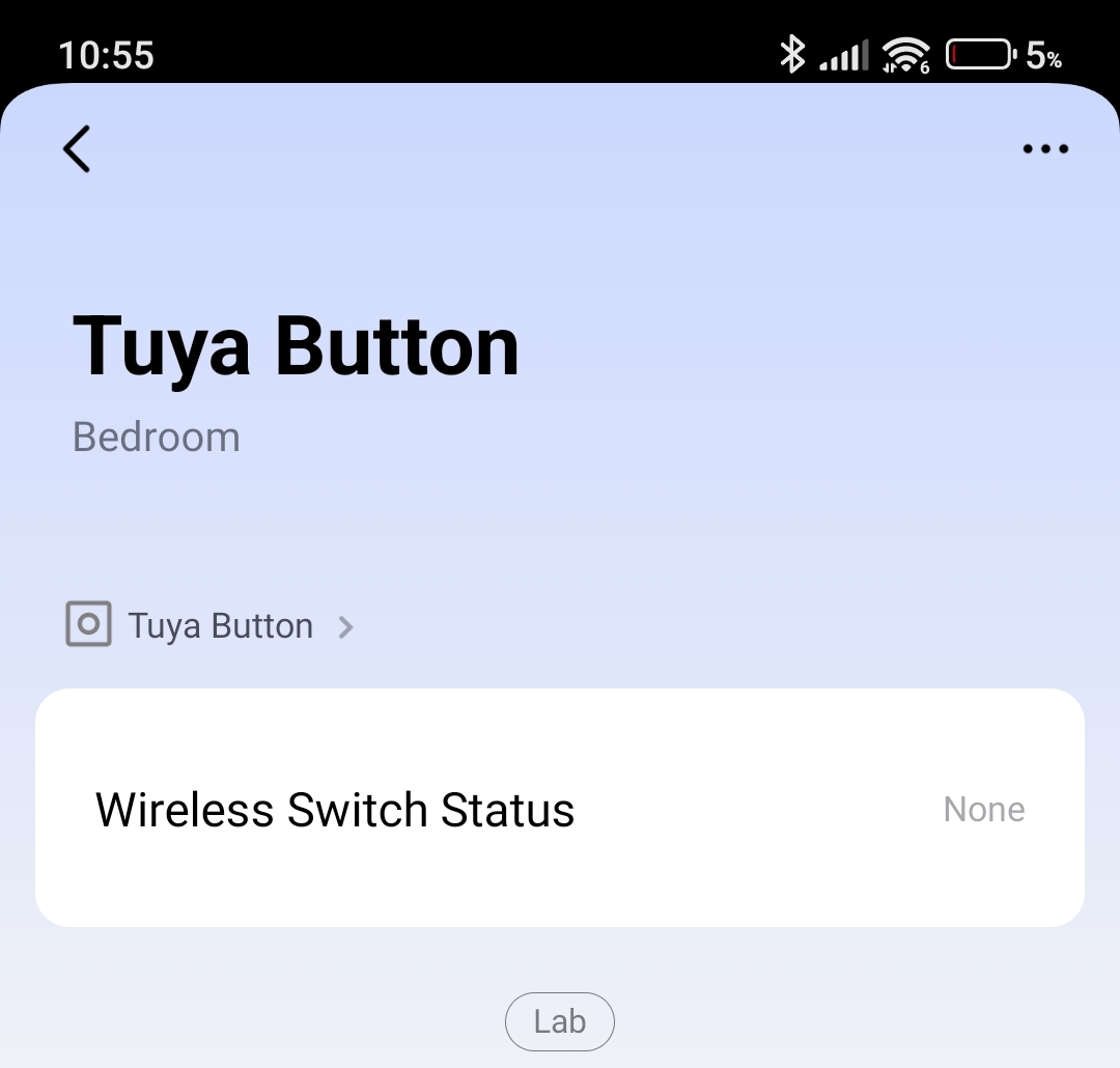

So basically they are showing in the aqara app, but won’t work, don’t register single, double or long press at all.
Thank you.
So the Aqara app displays the number of buttons correctly and offers the correct events (single / double / long press), doesn’t it? Then the device type must be correct (Generic Switch) and the Switch endpoints for each button should be there, otherwise you would not see the buttons or the event types available.
If the problem is that pressing buttons does not trigger anything then maybe the bridge is not mapping the events correctly. Zigbee buttons didn’t have a standard way to communicate button actions so it may need more tweaking at bridge side so it correctly identifies the button action and send the Matter event.
Yes, it’s showing everything correctly in the Aqara app, just as you said, but not registering when pressing the button. Thanks for the suggestion.

Do you know maybe what are correct parameters for single, double and long press?
Thanks

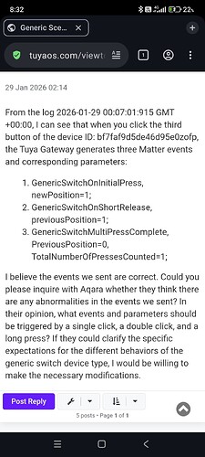

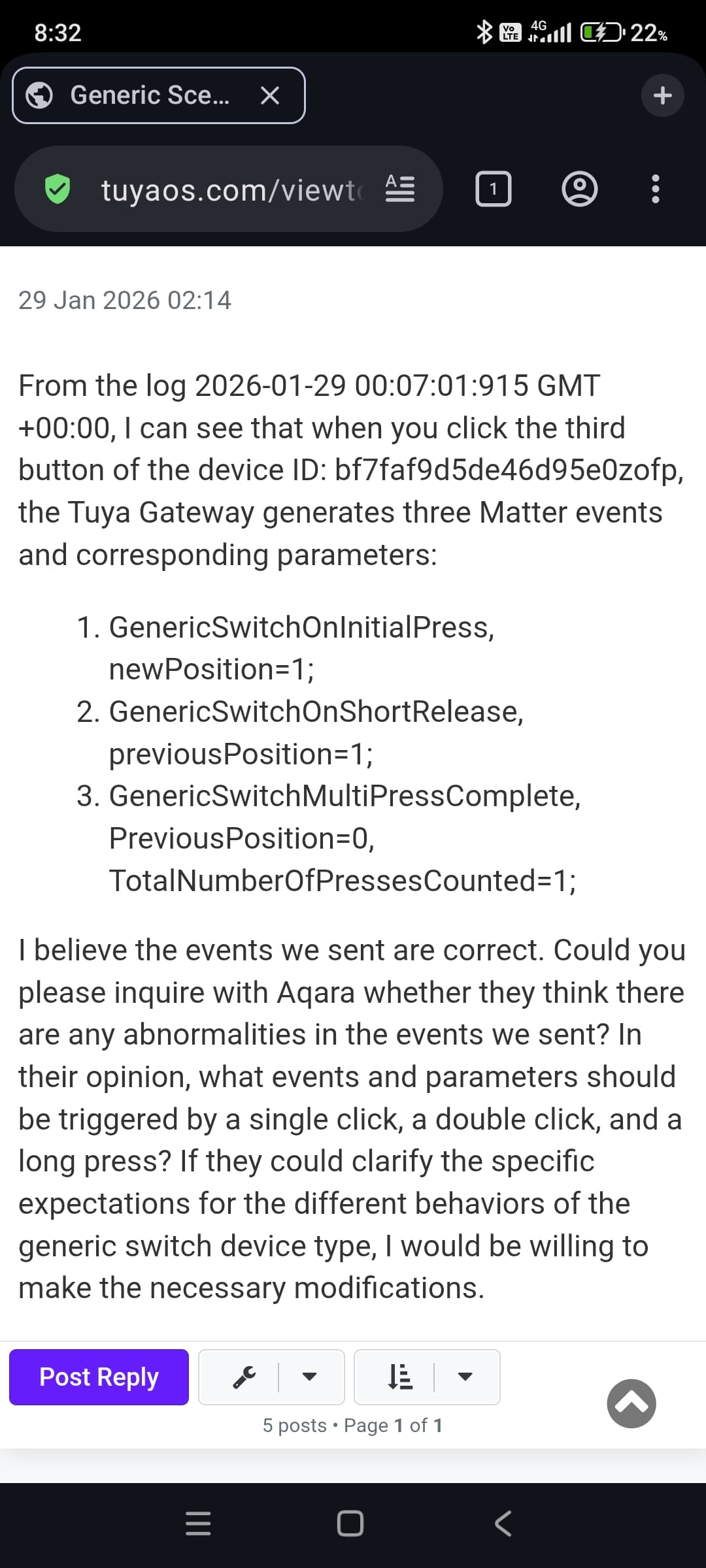

The response from Tuya support is unfortunately only part of the picture. While the logs confirm that the gateway registers the button press internally, this does not automatically mean that it is exposed in a Matter-compliant way.
It would therefore be more useful to analyze the raw Matter events and the FeatureMap (e.g., via the Matter diagnostic file in Home Assistant) rather than relying solely on internal gateway logs.
They can’t do this, they have so many devices, so they can’t physically test all of them. He can only check logs from my matter gateway.
So parameters on the screen are correct then for single click?

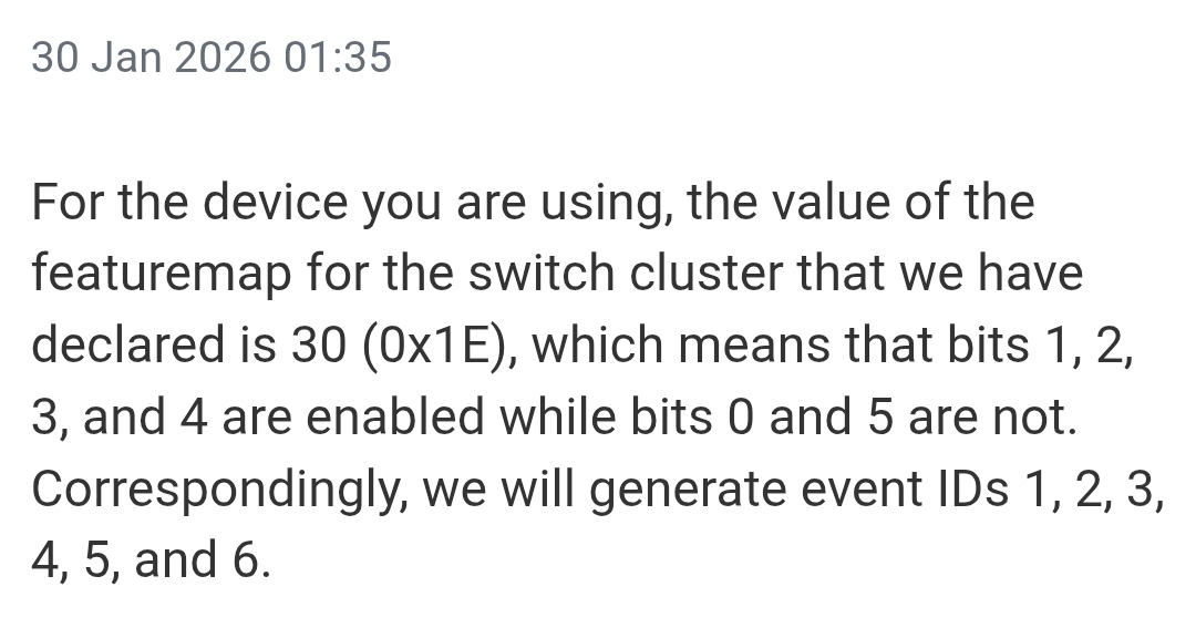

Essentially, it comes down to which feature flags are set. These flags determine whether specific events are considered valid or “correct” by the controller at all.
According to Matter 1.4 Application Cluster Specification:
Cluster Name: Switch / ID: 0x003B
There are two types of switching device supported: latching switches, such as rocker switches, and momentary switches, such as push buttons. These are distinguished by their feature flags.
Interactions with the switching device are represented as either attributes (for the latching switch) or events (for both switch types).
These feature flags must be used to indicate both the physics and the detection/reporting capabilities of the device represented by the cluster.
Bit Code Feature
0 LS LatchingSwitch
1 MS MomentarySwitch
2 MSR MomentarySwitchRelease
3 MSL MomentarySwitchLong Press
4 MSM MomentarySwitchMulti Press
5 AS ActionSwitchPress
These Events must be used
ID Name Conformance
0x00 SwitchLatched LS
0x01 InitialPress MS
0x02 LongPress MSL
0x03 ShortRelease MSR
0x04 LongRelease MSL
0x05 MultiPressOngoing MSM & !AS
0x06 MultiPressComplete MSM
Source: https://de.scribd.com/document/895080849/24-27350-005-Matter-1-4-Application-Cluster-Specification#content=query:Switch,pageNum:30,indexOnPage:0,bestMatch:false
As a result, even if an event is generated internally, a Matter controller may legitimately ignore it if the corresponding feature flag is not advertised in the device’s FeatureMap.

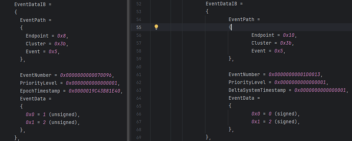

I asked Gemini where the error and it’s saying there is few errors, but its Ai, so I can’t trust it :smiley:
At first glance, I only noticed signed in EventData, but according to the specifications, it should be uint8, which stands for an 8-bit unsigned integer with an integer value of 0–255. This could potentially be an issue, but I will look into it more closely later.
thanks <3
Yeah that what Google said, plus issue with time, it set up for 1 millisecond and short release is missing in double click, or something like that
This becomes clear when the two are compared. On the left, you can see the correct double-click of an Aqara H2 switch. On the right, you can see the double-click of a Tuya switch.
Aqara → Event 0x5 MultiPressOngoing
EventData = {
0x0 = 1 (unsigned), → NewPosition = 1 (pressed!)
0x1 = 2 (unsigned), → Count = 2
Tuya → Event 0x5 MultiPressOngoing
EventData = {
0x0 = 0 (signed), → NewPosition = 0 (not pressed?)
0x1 = 2 (signed), → Count = 2
