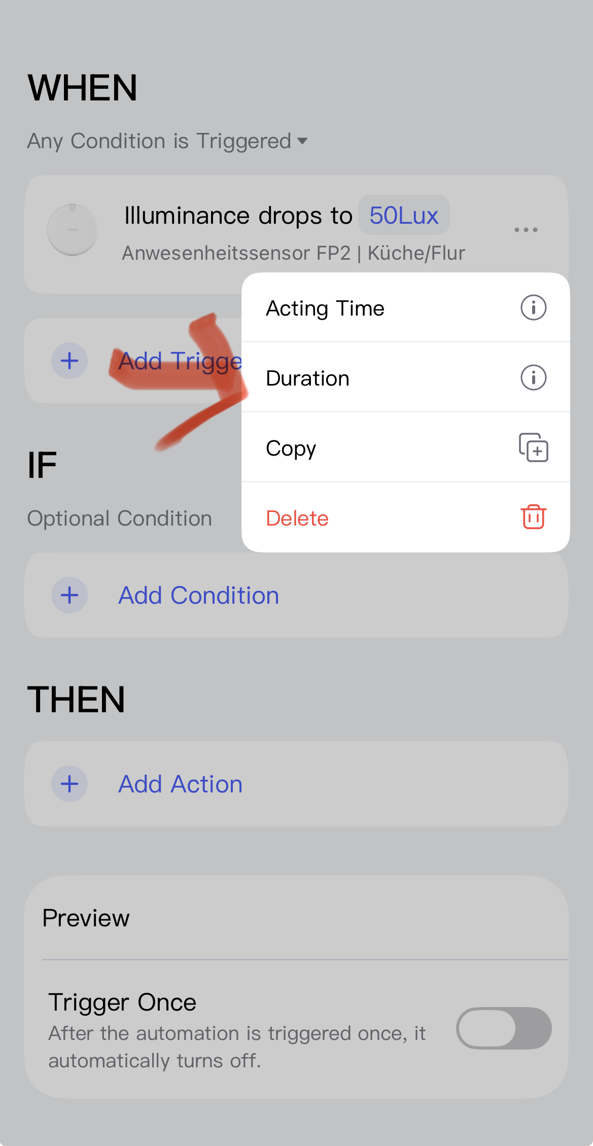

You can also set a time under “Duration”. In this case, the brightness value must be reached within the specified time (for example, 10 seconds) to prevent the automation from being triggered by rapid changes in lighting conditions.
This will stop your lights from turning on during the next thunderstorm :wink:
