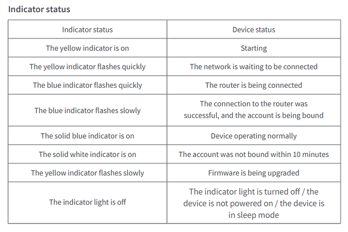

Did you disable the LED light in the app? If so, the camera has probably connected successfully. If not, it looks a bit like a power supply issue. Have you tried swapping the power adapter?
Image Source: Camera G100 User Manual

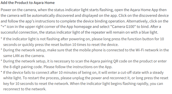

Have you tried performing a network reset? You just need to long press the reset key for 10 seconds to reset the network.

Managed to get Aqara home to find my device, knock knock read the manual and tried the “press 10 times to factory reset” and it worked like a charm! All is good for now!
