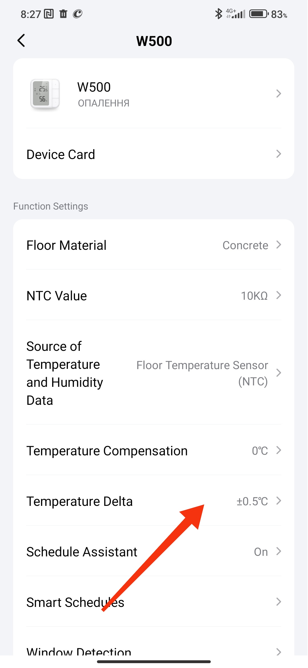

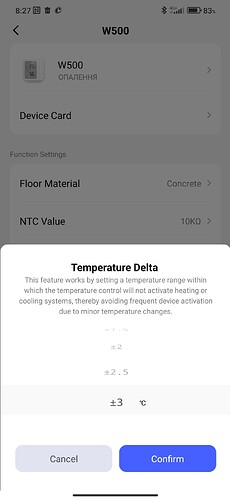

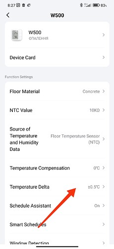

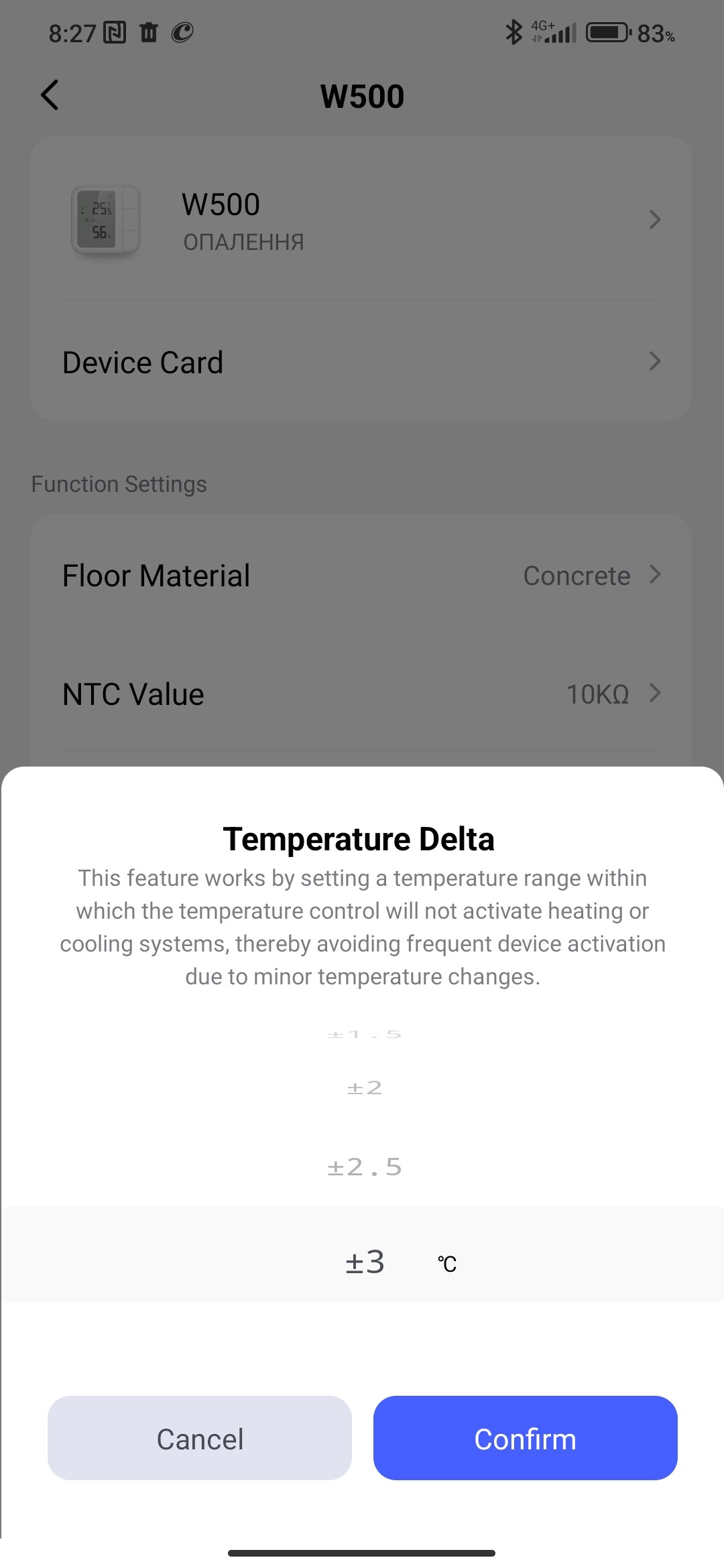

hi Boltikarie,
you can absolutely enable the hystheresis function which is available in Zigbee mode. Hopefully it will address your concerns.
Hello, yes, hysteresis is there, 0.5÷3 °C, step 0.5. I recommend additional control using automation in Aqara. You may be interested in this topic. Methods for controlling room temperature using Aqara devices
