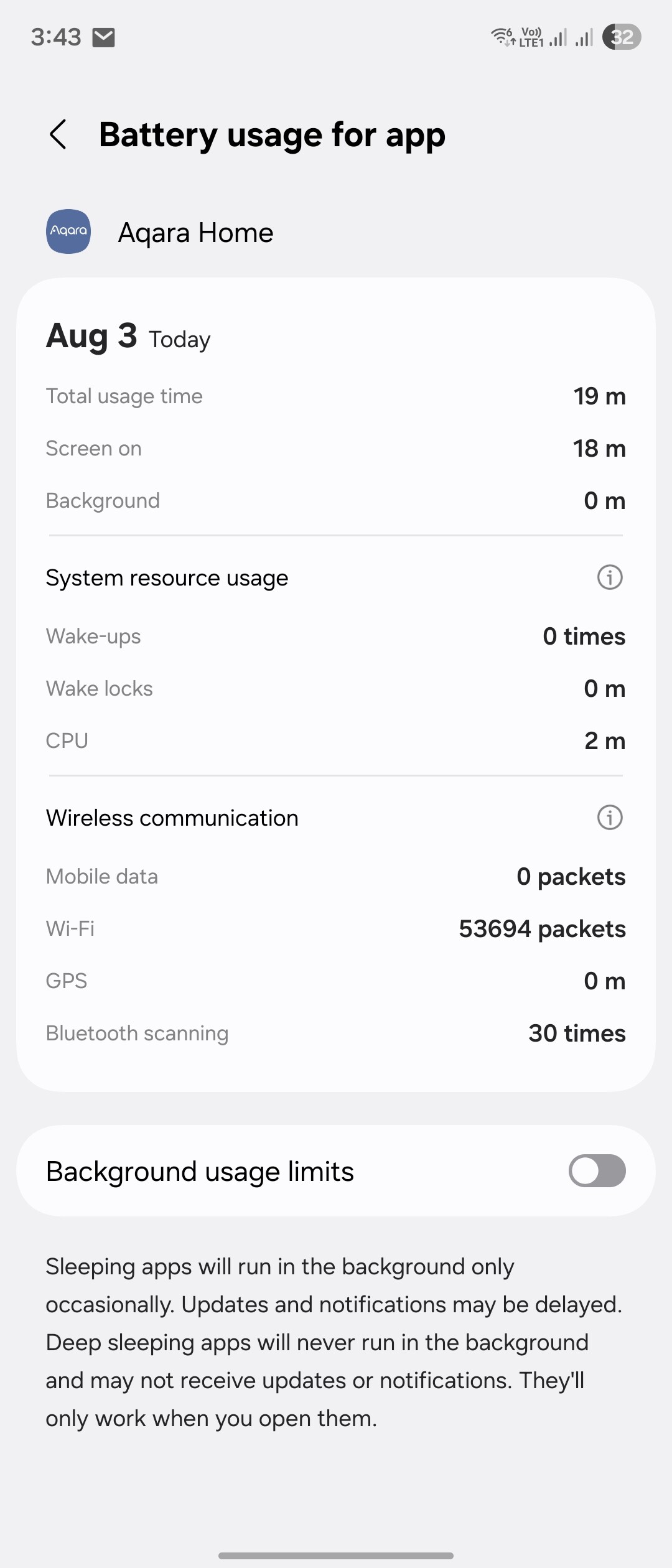

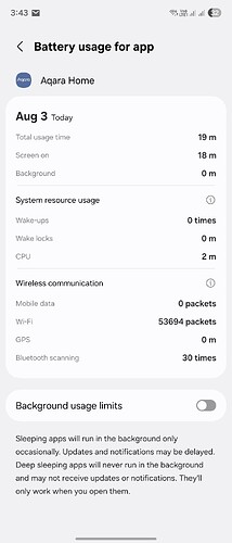

@gafich10 and you were right because I wrote that in the first place as a second bullet point. The screen I attached correspond to option mentioned by you @Raman.V
On Samsung One UI you can reach it from different places but it is same - allowing Android to put app into sleep causing sometimes notifications not being able to show up. So it means that unfortunately problem is somewhere else because this option is from the beginning set to exclude Aqara Home from this (on both Android phones).
