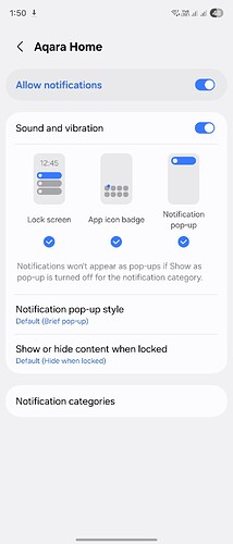

  • Notification settings for the Aqara app on Android are enabled.

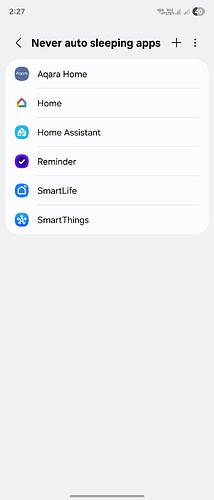

  • The Aqara app has been added to the exceptions list for app sleeping/optimization.

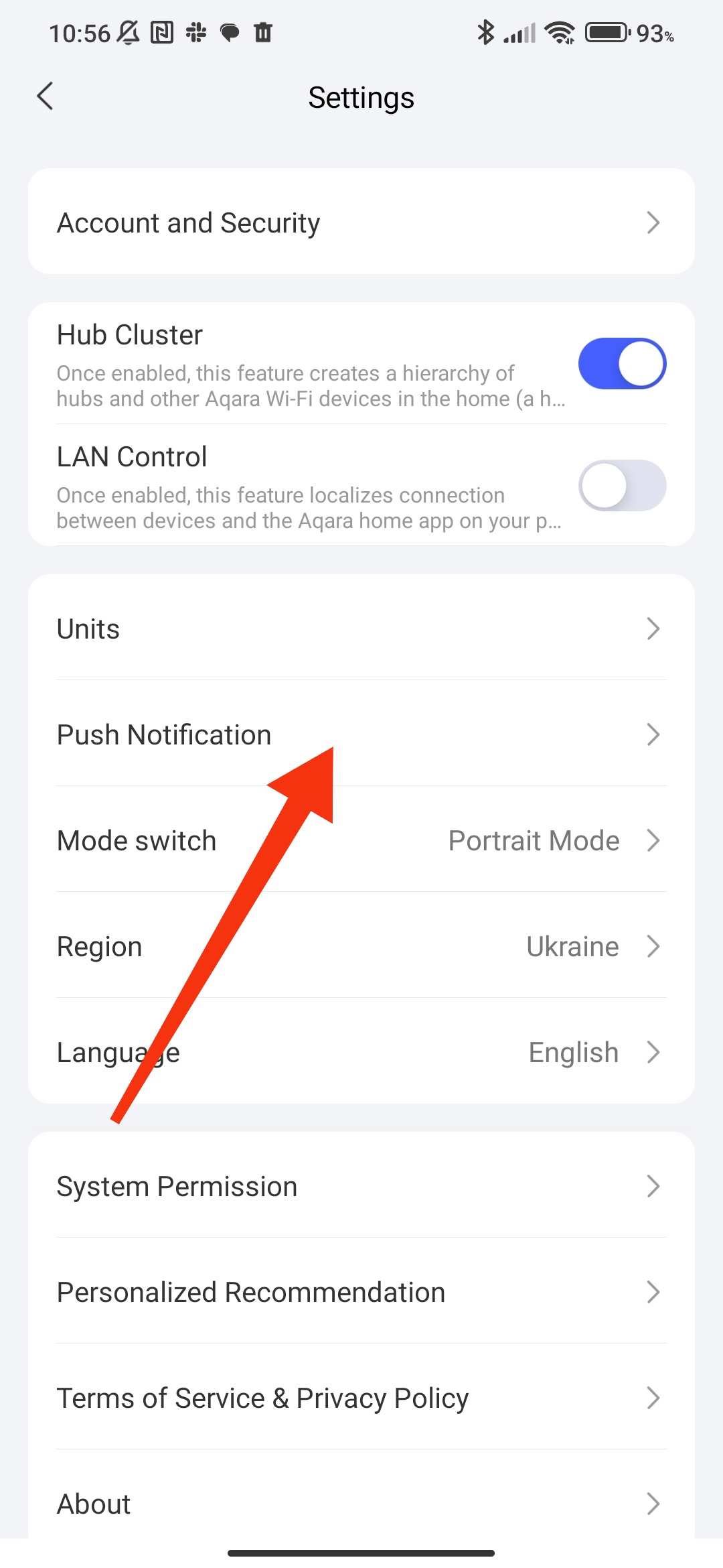

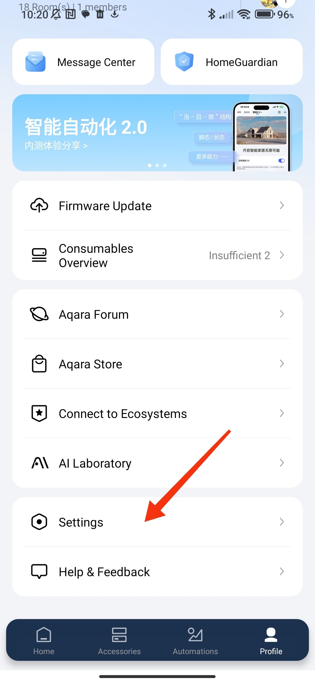

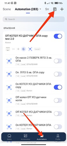

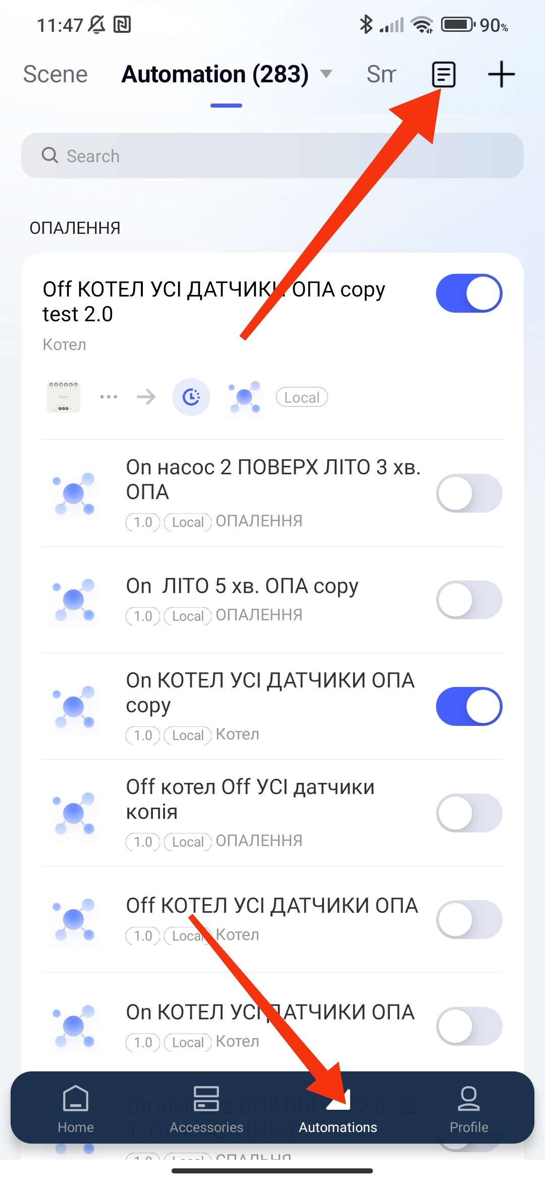

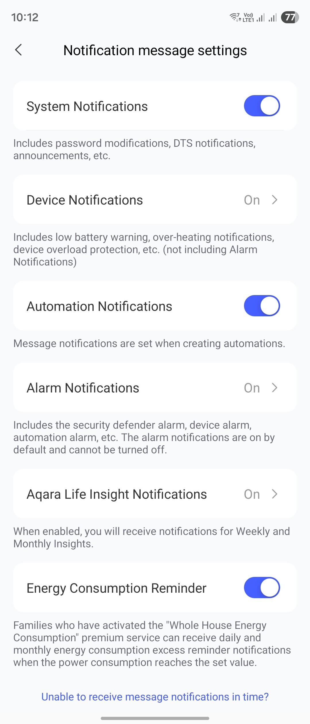

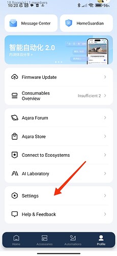

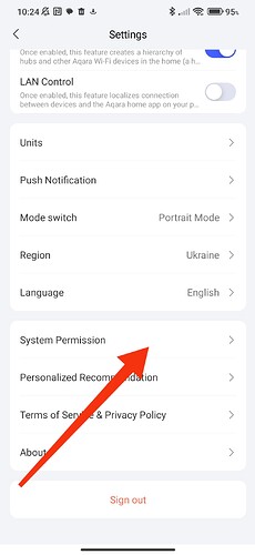

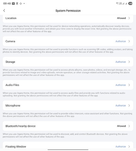

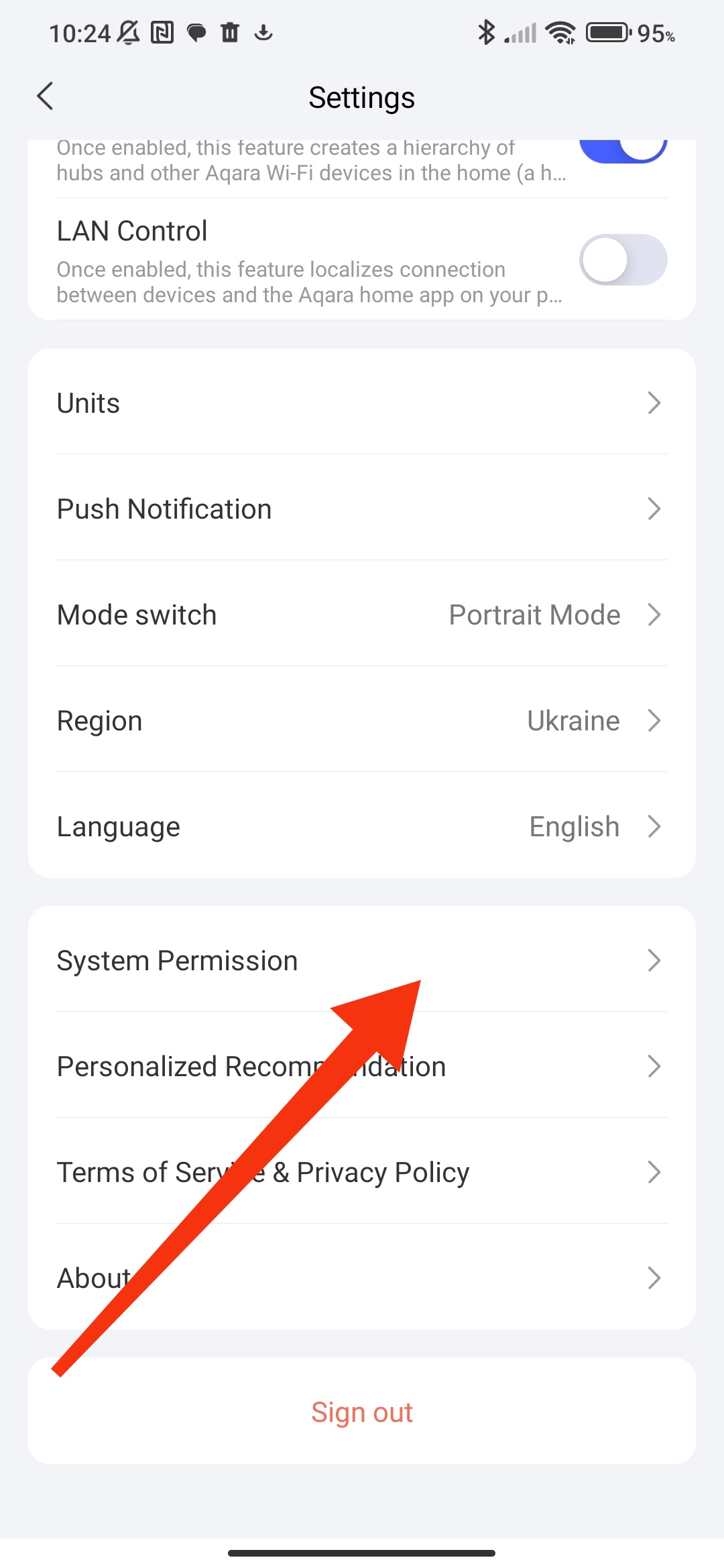

Have you gone into these settings in the app?
Thank you @gafich10 for your reply. My Aqara app is 5.2.9 version and I don’t see newer one in Google Play. The menu page you provided seems to not have relation to notifications at a first sight. Should I look into some specific option under System Permission to be able to see notifications?

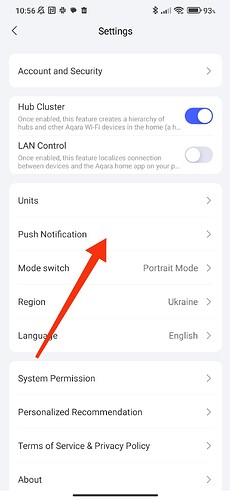

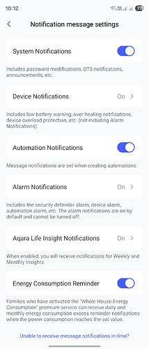

Sorry, I showed the wrong window.

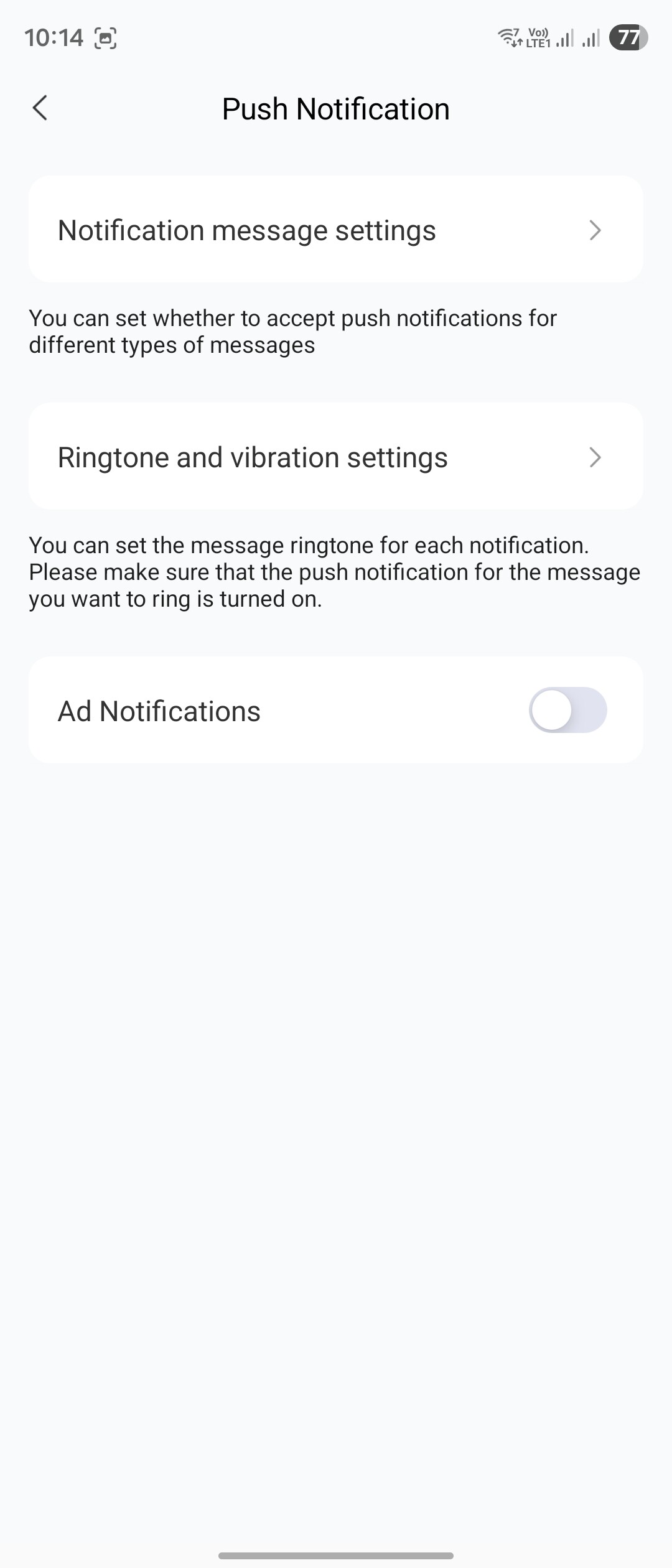

So on Push Notifications screen I have everything enabled except Ad Notifications. I also followed instructions under link on that screen for case 2.a unfortunately without any success on both Samsung Z Fold 7 and Galaxy 25 Ultra :frowning:

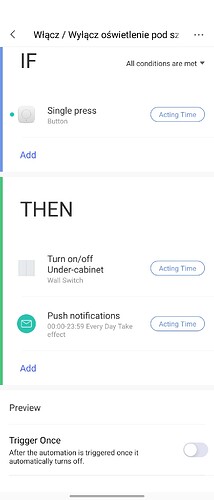

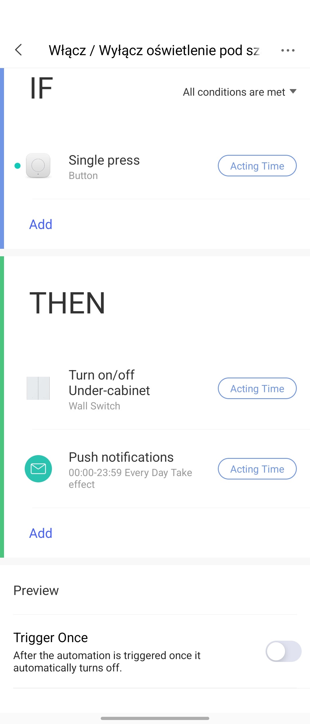

Do a small notification check. 1. Make a test automation with a push notification, for example, if two different switches are turned on (requiredly two lines in the automation) then a push notification. 2. Launch the Aqara home application and minimize it (do not close it, but minimize it). 3. Create conditions for starting automation for a push notification.
Think I did it too… I’ve added Push Notification action to the button. And with minimized Aqara Home. Notification appears on iPhone but not on Samsung devices. I also tried to log out on iPhone but still nothing.

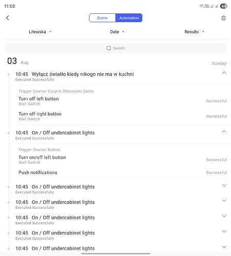

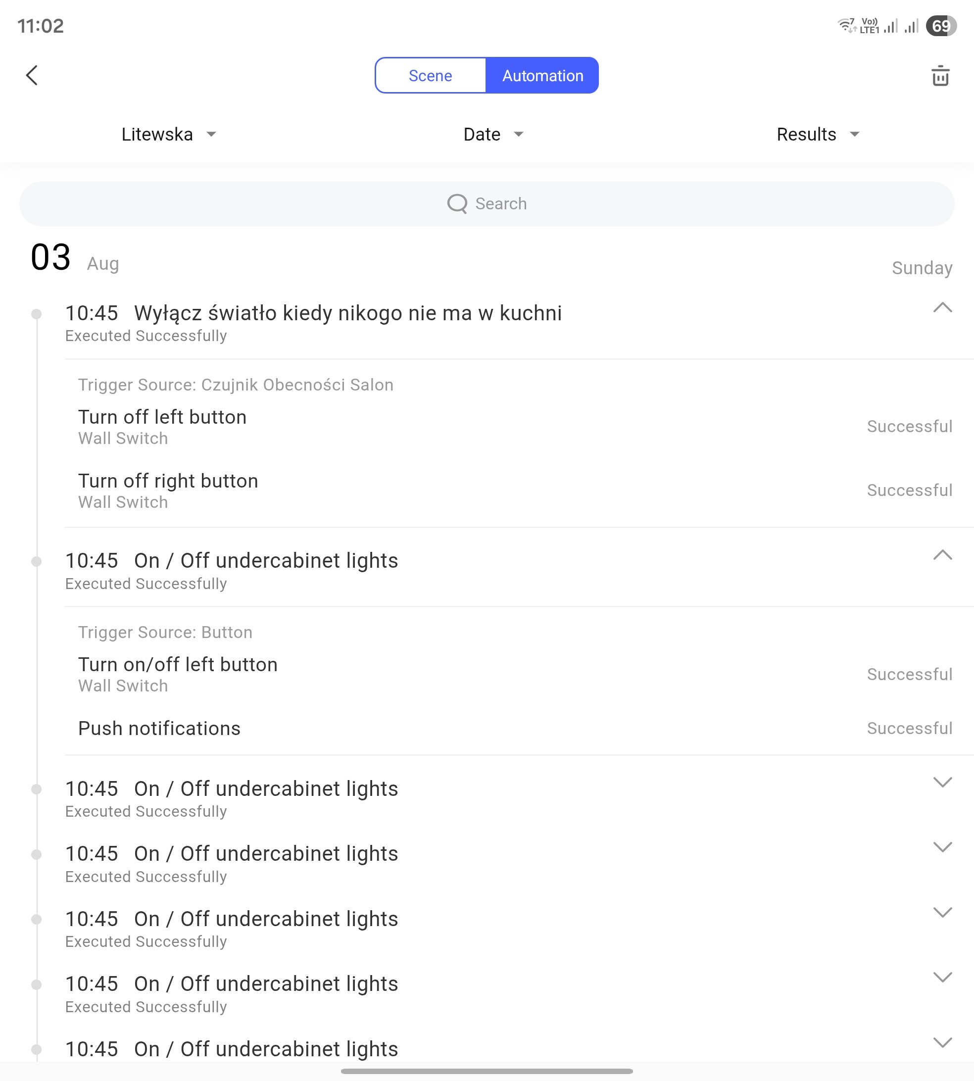

If you don’t receive a notification from the test automation, check the automation log to see if it fired. The automation log can be found here.
Log shows it was successfully triggered:

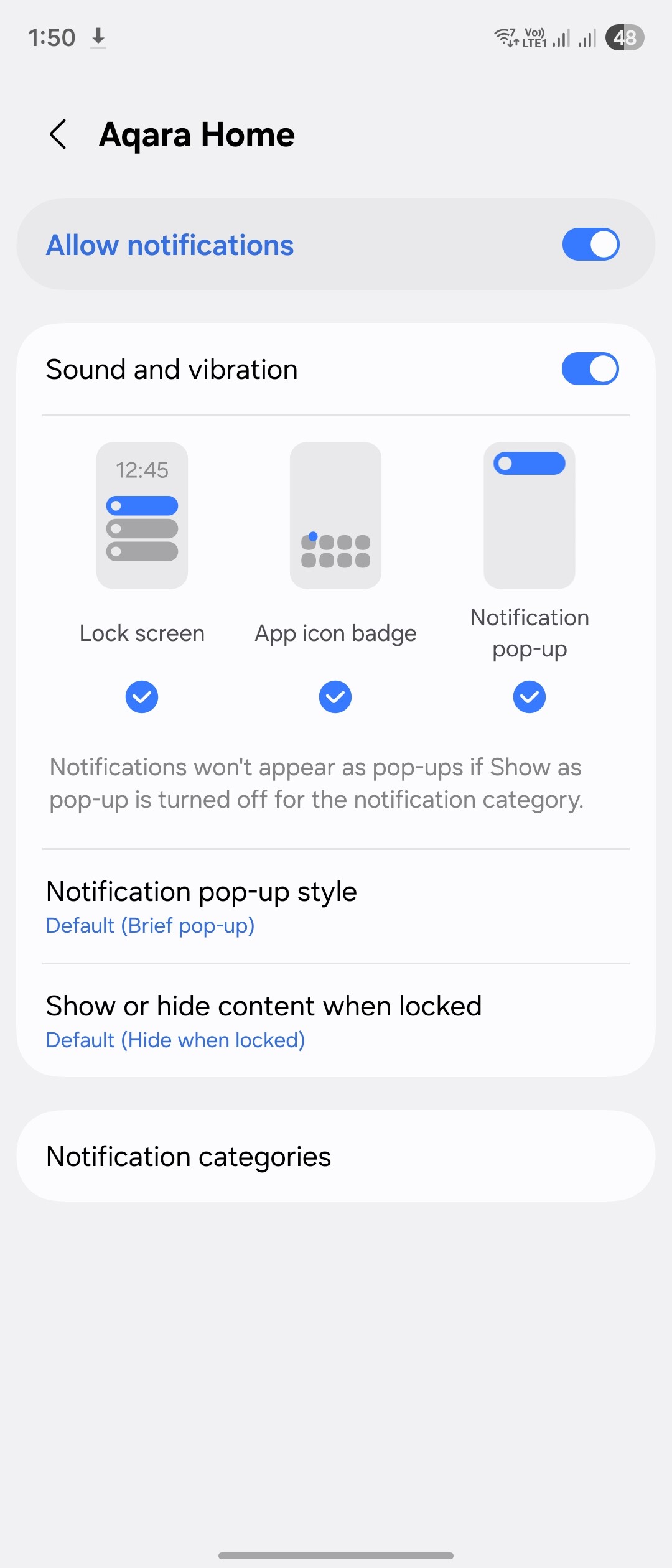

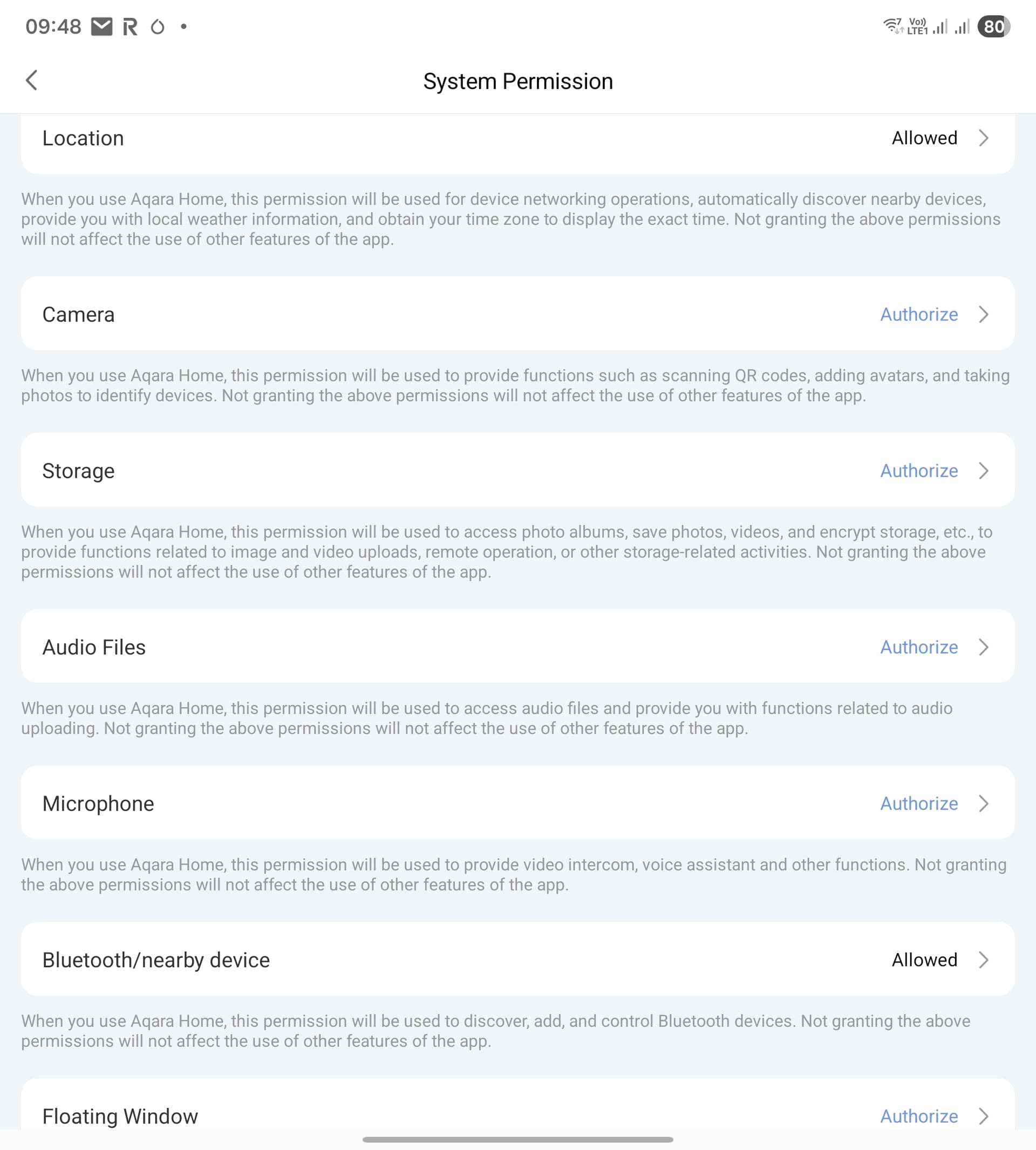

In order for notifications to work, you need to give them permission in the Android system itself in the settings of your phone
Thank you @Raman.V for your response! I’m not sure what you mean by give permission. I do have notifications enabled in Android system as I mentioned in the first place so if I missed something else I’ll be grateful for help :grinning:

  • Notifications enabled (both in Android system settings - all categories, and in Aqara Home)

  • Automatic Aqara Home auto turning off (battery optimization) disabled in Android system

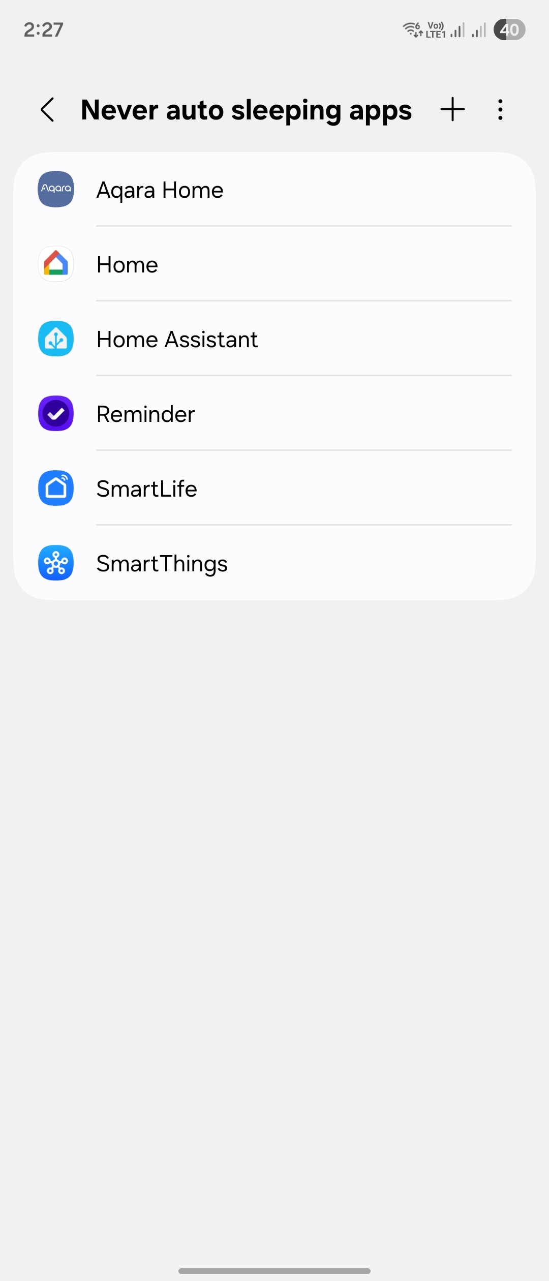

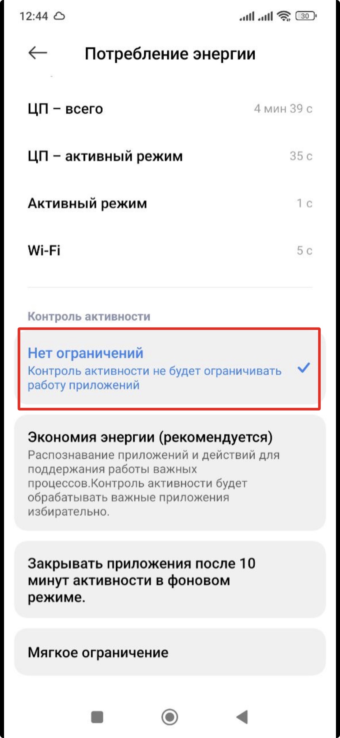

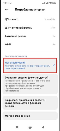

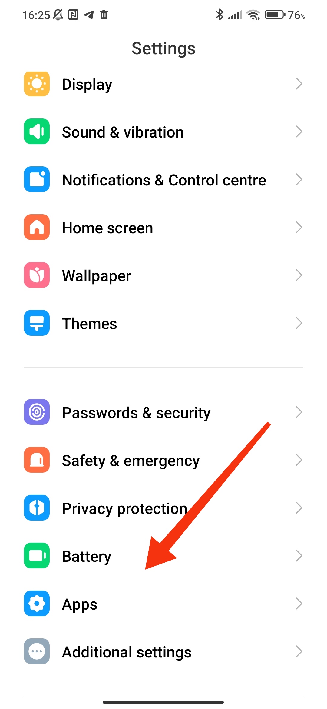

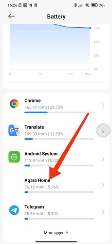

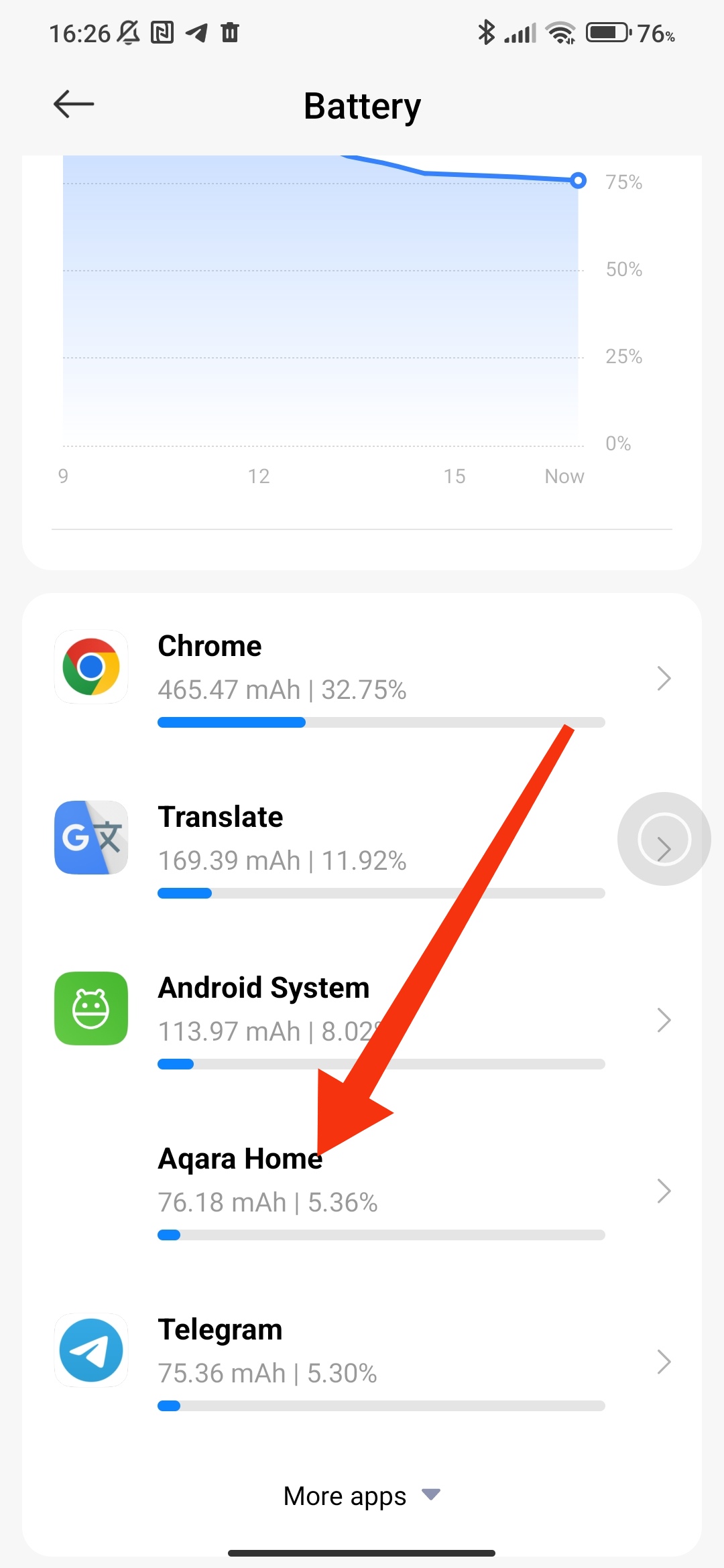

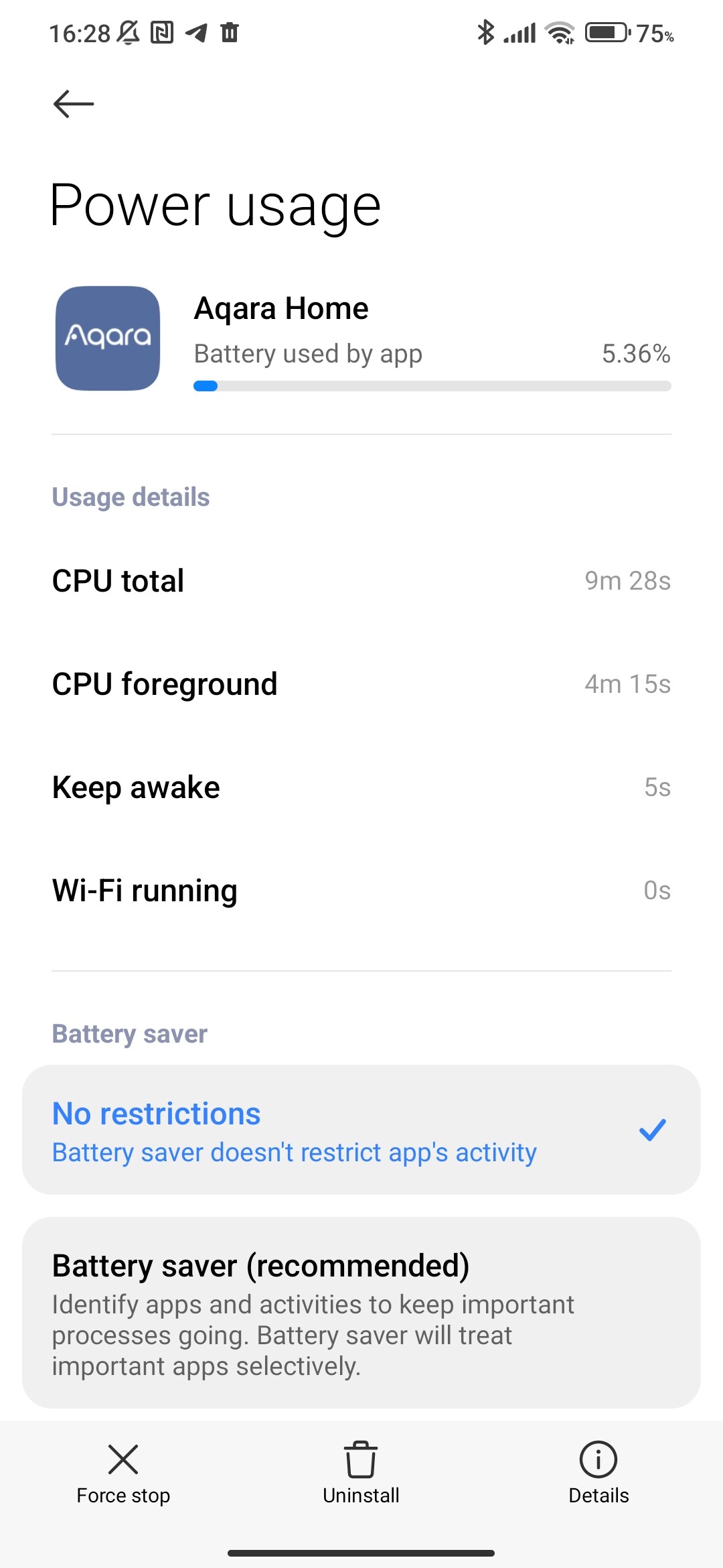

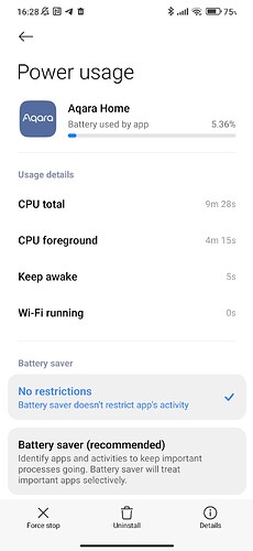

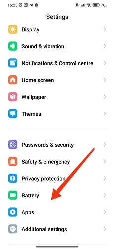

check also the energy consumption mode (energy economy) there are also points limiting the usage from applications.
Indeed - this is what I meant by Automatic Aqara Home auto turning off (battery optimization) disabled in Android system which maybe was not clear but it is this screen:
I use an iPhone, so I don’t have such problems, but I know for sure that the options I described should help solve this problem. If notifications do not work as before, I recommend contacting the aqara support service.
support@aqara.com
Thank you
If you are sure it means that screen I’ve posted doesn’t correspond to setting you mentioned - could you please help me to understand where I can find this certain option? Unfortunately translation from Russian seems to not work for me. Do you have example in English? I also contacted with support and waiting for help.
I thought you had this setting turned on by default.
