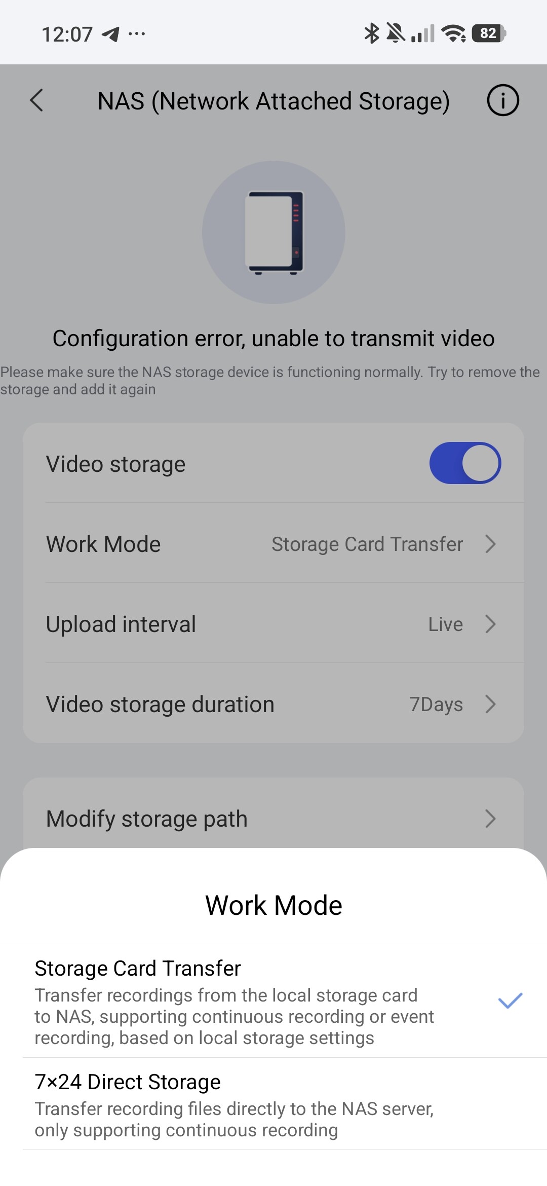

Hello, welcome to the forum. I had this problem once, I switched to this setting. It helped me, although I haven’t researched this problem further. Try it.
