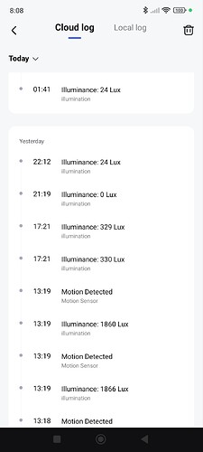

The P1 is directly connected/paired with the G410, but every two or three days the connection between the two drops.
It happened yesterday, twice, and on neither occasion did a restart if the G410 fix the problem immefiately. But, on both occasions the P1 to G410 connection was restored without intervention.
A screenshot of the log for the P1 is attached.
You will notice long periods where nothing is reported i.e. P1 offline.
Thanks.
