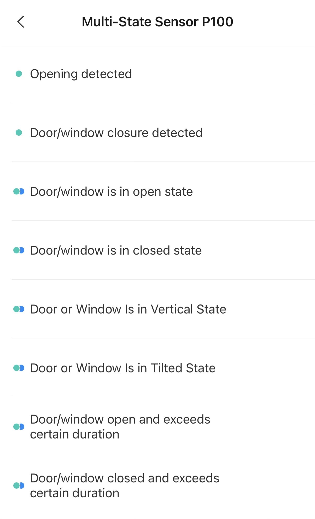

Here are the options for the P100 that I found.
“Door and Windows is in Tilted State” is, I think, exactly what you need. Then all you have to do is connect the Aqara hub to Apple Home via Matter, and the sensor will appear right away.
But be careful: if you’ve already connected the hub via HomeKit, then the hub’s child devices are connected via both Matter and HomeKit. So everything is duplicated in Apple Home!

I did some testing. When connected via matter to the Aqara hub it shows open and tilted without the other options. In Apple Home it’s a single sensor for open.
If you use zigbee you can choose between window/door monitoring or t( other security options. Again in Apple Home it’s a single sensor just for open, no separate tilt sensor. What’s added is an occupancy sensor which seems to be meant as a sensor for tampering but is useless as it gets activated almost every time I opened/tilted the window.
This just tells me one thing, they are capable of exposing multiple sensors to third party systems, they just didn’t do the right ones.
