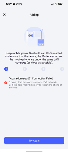

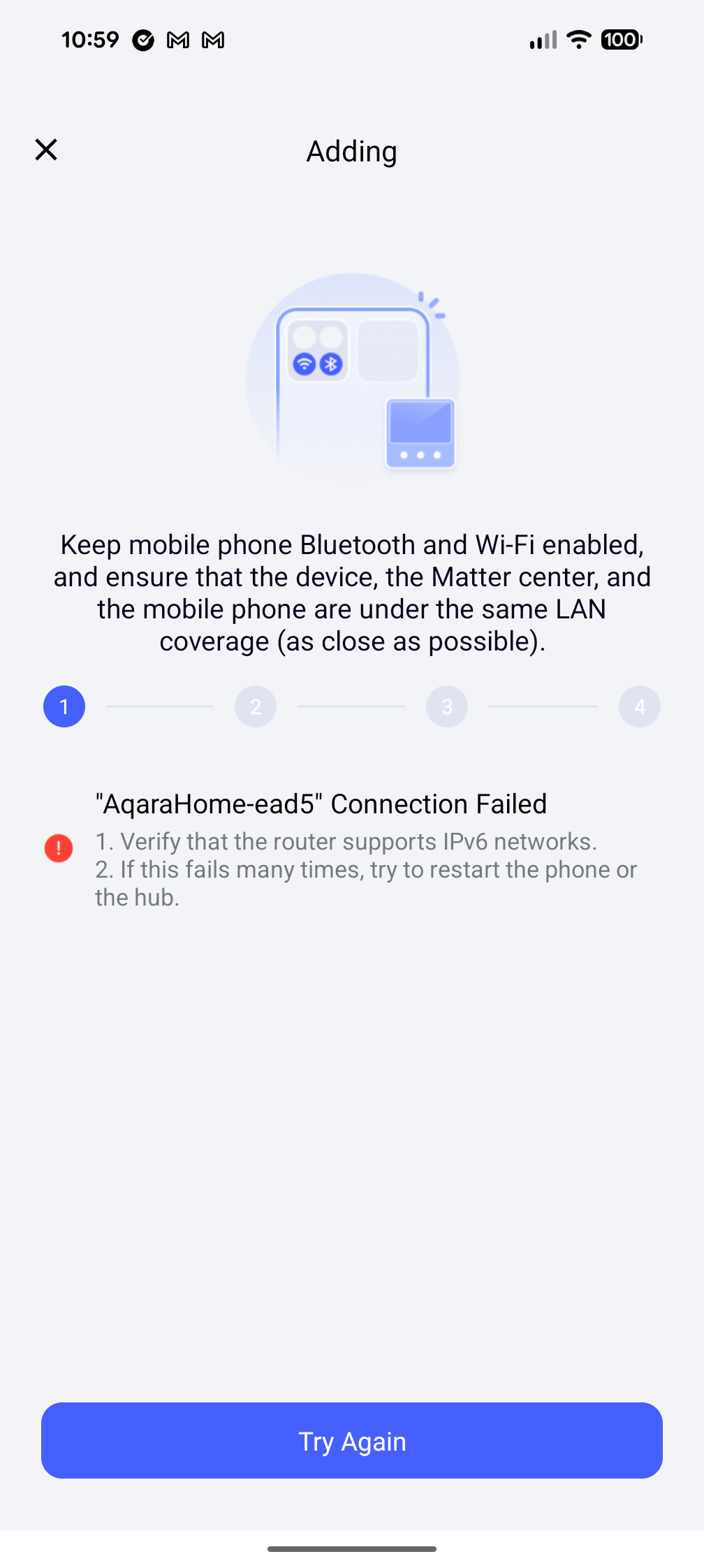

I am trying (but failing) to connect the Meross MS605 proximity sensor to the M200 hub. Based on the documentation of both products, this should be totally feasible. When following the instructions I get an error that the sensor is unable to connect to the M200 hub (see attached image) I have tried all the diagnostic steps but still no luck.

Thanks for your response. I have been to connect several matter devices and ipv6 is indeed enabled. It just this particular device that I seem to be struggling with. I did not share this earlier but the error code is 10028 (if that is helpful).
