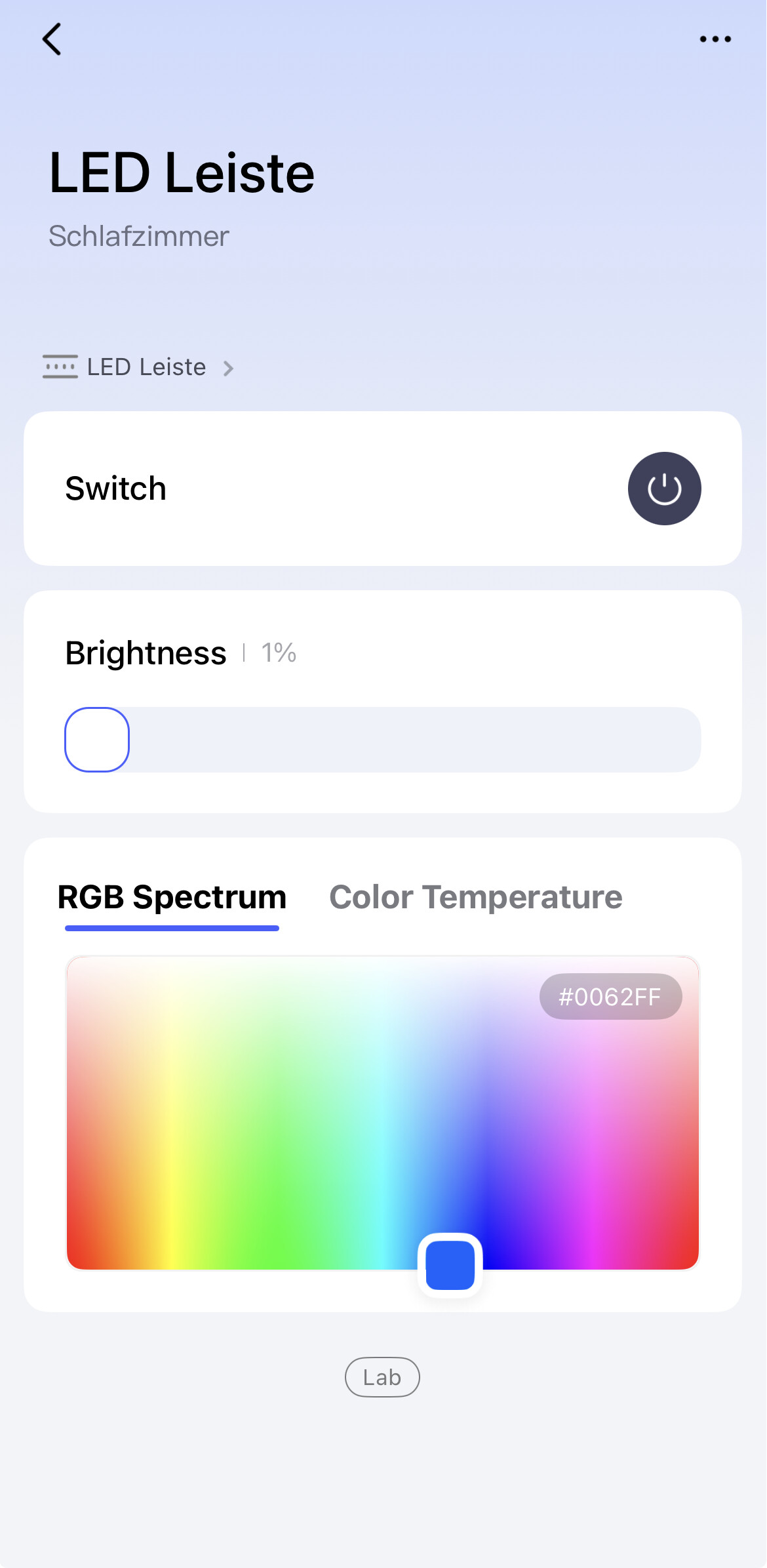

As far as I know, this works for light bulbs via Matter in the Aqara app, so it will probably work here too. Just like it works with my LED strip from Nanoleaf with Matter in the Aqara app:

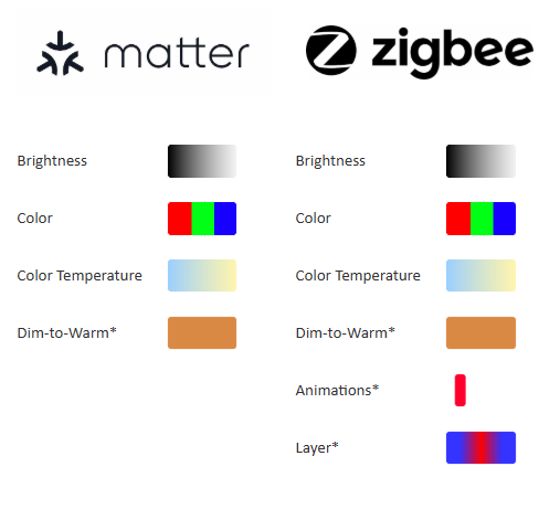

I completely agree. Incidentally, the manufacturer states that not everything is supported in Matter:

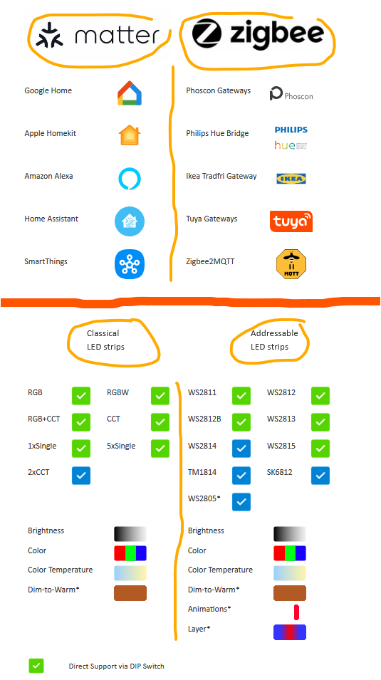

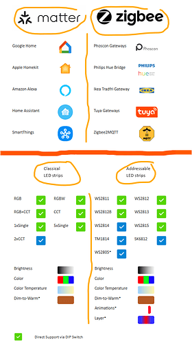

There is a misunderstanding here. The two upper columns refer to the Zigbee gateways and the Matter gateways. Further down is a new section where the two columns refer to classical and addressable LED strips. Here in the attachment, you can see the entire screenshot again. However, we will review the graphic layout to better distinguish between the different topics.

This forum post was about Aqara hubs, such as the M3. Aqara is not listed in your chart. However, since Matter is manufacturer-agnostic, Aqara could be listed under Matter, in which case the restrictions shown would apply. As far as I am aware, Aqara hubs are not compatible with Zigbee devices from other manufacturers.
Or are you saying that the two graphics should not be grouped together? Are you saying that the Phoscon LED Driver FLS-M is an addressable LED strip and not a classic LED strip? If so, you should remove the graphic for classic LED strips, as otherwise it would cause a great deal of confusion.
Both are possible; you can operate the FLS-M on Zigbee or Matter over WiFi. The first DIP switch is crucial. If it is set to down, it runs on Matter, if it is set to up, Zigbee is selected.
The topics of which of the two radio technologies and which of the two types of stripes are independent of each other.
The Matter controllers and Zigbee gateways listed on the FLS-M homepage are examples. Elsewhere, ‘The FLS-M works with all approved Matter controllers that are located in the same WiFi.’ and ‘A Zigbee gateway is required to teach in and operate the LED controller.’ are mentioned. However, we will also add the Aqara hubs to the homepage. We have probably mistakenly not considered them popular enough so far. :sunglasses:
The Phoscon FLS-M can be used with either addressable or classic strips. Mixed operation is also possible. For example one Addressable RGB LED strip combined with, one classic CCT and one classic monochromatic LED strips.
