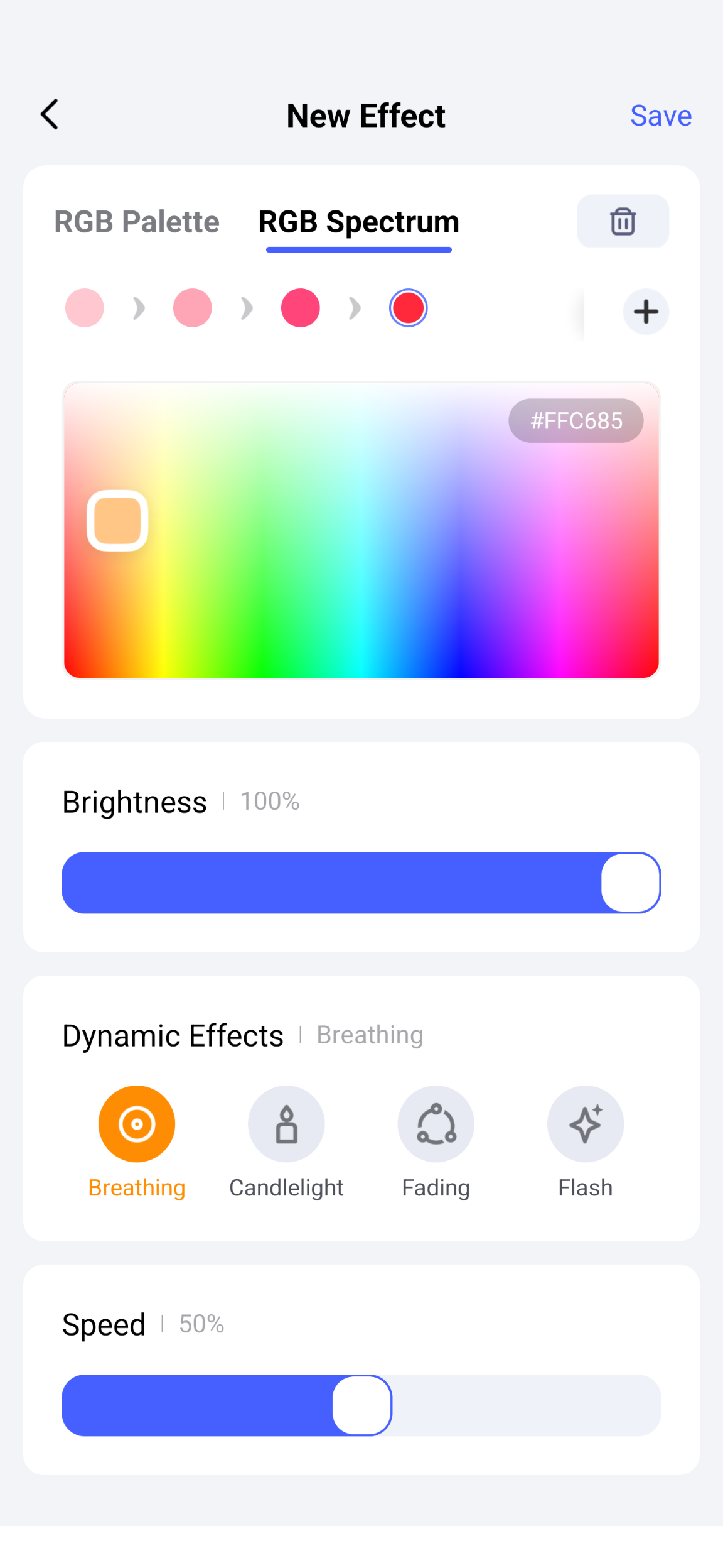

There seems to be a possible bug in the Aqara app when making an RGB dynamic effect in Zigbee mode (the screenshot attached).
When making a new effect and setting the brightness you can select the level as a percentage, and when previewing the effect the app/hub sends this value to the bulb as a straight integer between 1 and 100 converted to hex.
However the bulb itself uses a brightness level between 0 and 254 so this results in the effect being previewed at a dim level compared to what it should be.
When saving the effect as a scene to the bulb via the OTA firmware write process the brightness percentage value gets converted correctly to the corresponding 8 bit value and gives the correct brightness but in the effect preview mode this value conversion seems to be missing.
I noticed this when looking at packet captures of how the RGB effects work and wondering why they were so dim.
FYI, Aqara support have confirmed that this bug exists and reported it to the R&D team for investigation.
