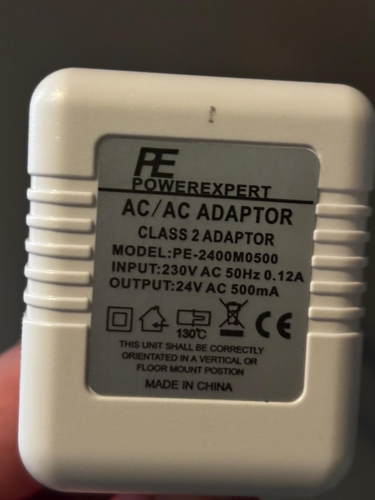

Sorry, the 25V was a typo. My power supply is actually 24V, so it should be okay?
Should be , can you send a pic of the specifications of the power unit?

The power specification of 25V AC 500mA does not seem to have any problem for the G4 doorbell to work with, because the power range of the doorbell is designed with some redundancy. However, under normal circumstances, when using a wired power supply, the battery level should be displayed as 100%. The battery level is low and only occurs when the input voltage is below 3.2-3.3V. I think there are two possible reasons for this issue. Firstly, the actual power specification of the transformer is too low. Secondly, the doorbell has hardware damage, you can remove the external wired power supply to use battery power to check whether the doorbell is working normal.
This is the power unit I am using.
Seems the power supply should work - can you try the steps that Donie mentioned above?
