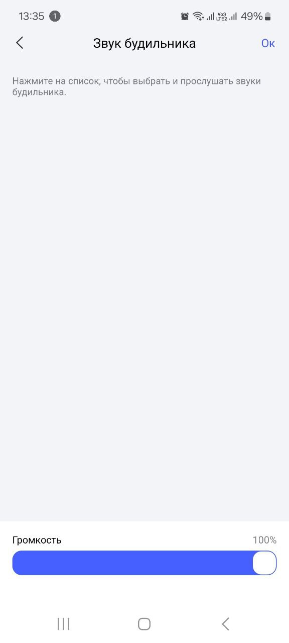

Several Hub M1S Gen 2 centers are used and opening and motion sensors are connected. The night mode of arming by timer is used. When any sensor is triggered, only one Hub M1S Gen 2 gave a siren signal with a 2-second limitation. Everything worked fine for one week, but then the following happened. If the security sensor is triggered, the siren emits a signal continuously without a time limit. It can only be turned off by pressing the notification button on the phone, and after that the night light on the concentrator lights up, which has to be turned off manually in the program. In addition, the list of alarm ringtones has stopped displaying in the security triggering settings, due to which the program does not allow changing the sounding time. When trying to save the settings, it asks to select a ringtone from the list, but the list is empty. There are 4 users in the system. The situation is repeated under different users and for any concentrator in the system. Why could this happen and how to fix the problem? Thank you.

Looks like it is a bug, please contact the customer team directly
