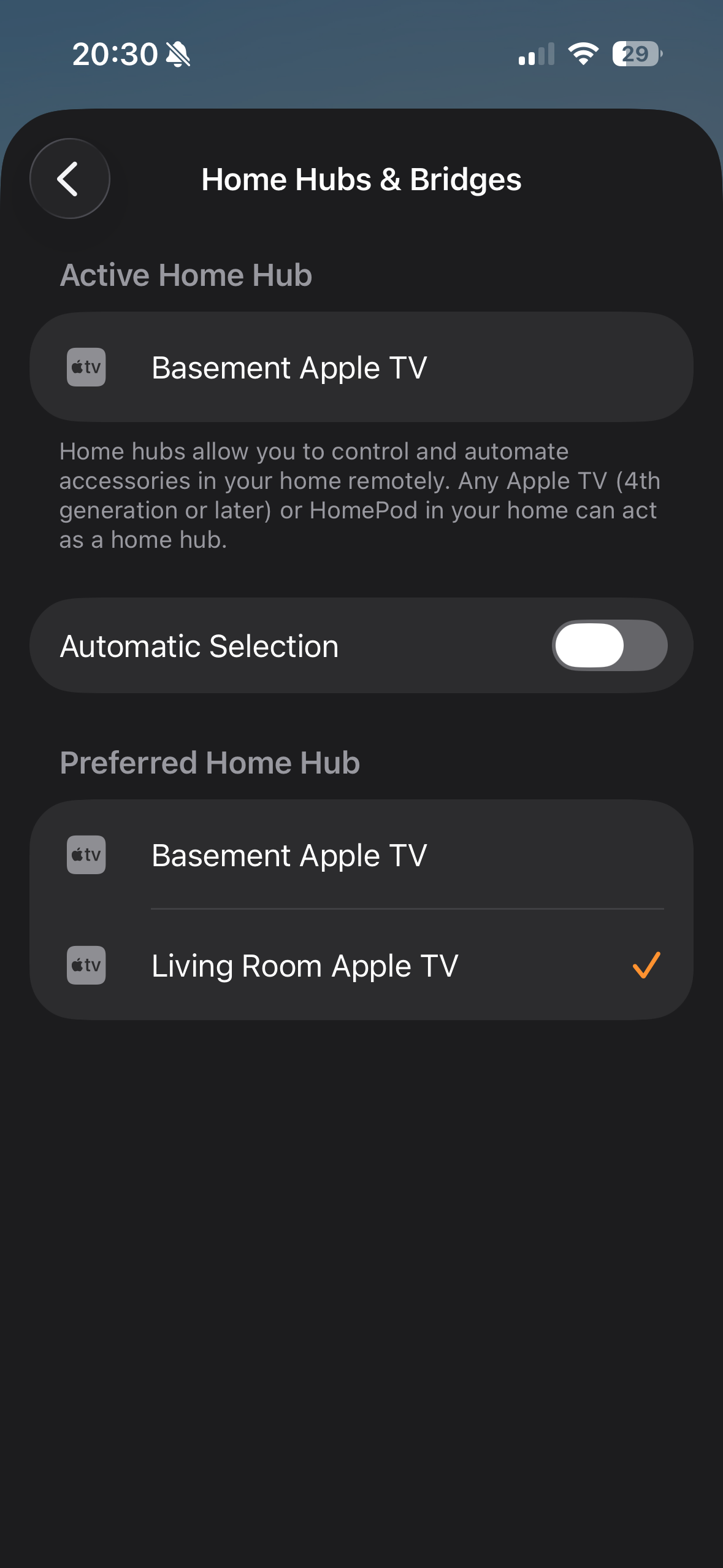

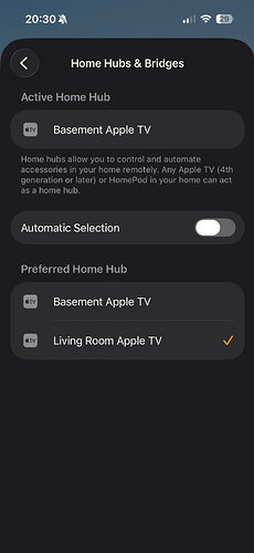

I figured it out. I have 2 Apple TVs and it was auto selecting which one should be the active home hub. It selected the wrong one. I manually selected the one that is wired to Ethernet and it started working.
