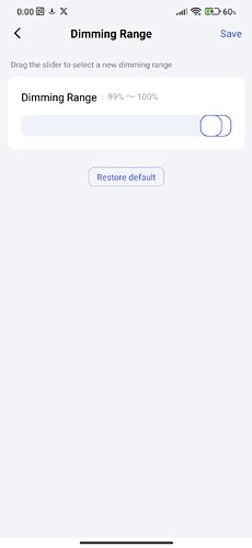

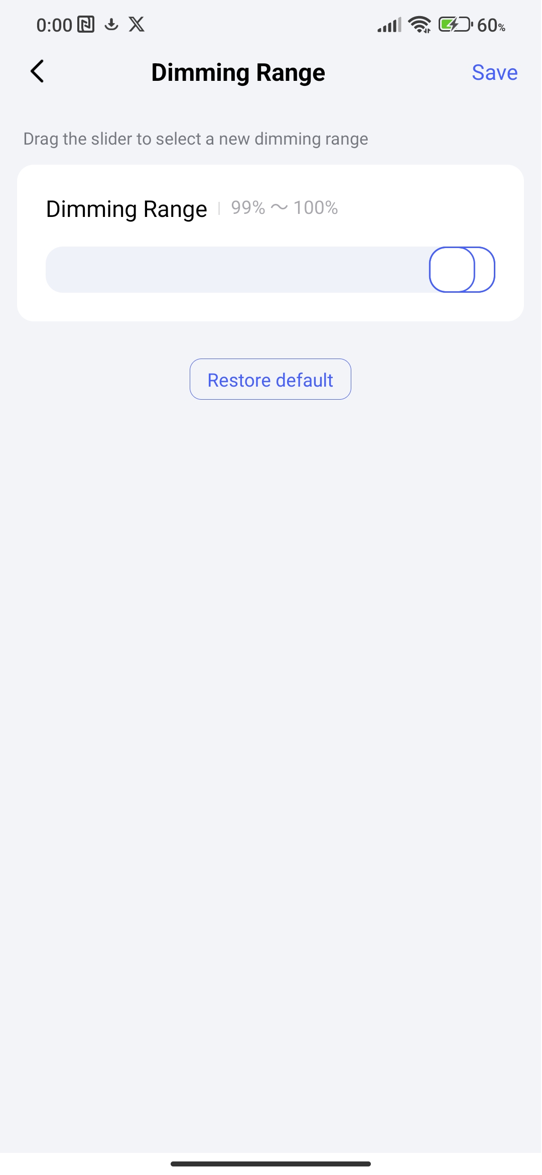

Also found that the min/max set in the app is just ignored. The only way ive got it to work semi-permanently is to double press the dimmer button then rotate the dial to set the minimum brightness, I check back in the app and its saying min is 75% or something ridiculous. When i switch dimming modes it seems to work for a day and then the ranges are different again. i dont know if its the supply voltage fluctuations or not. Either way its not been a smooth experience for my proof of concept and im reluctant to splash out on doing the rest of the house until the firmware becomes more stable!

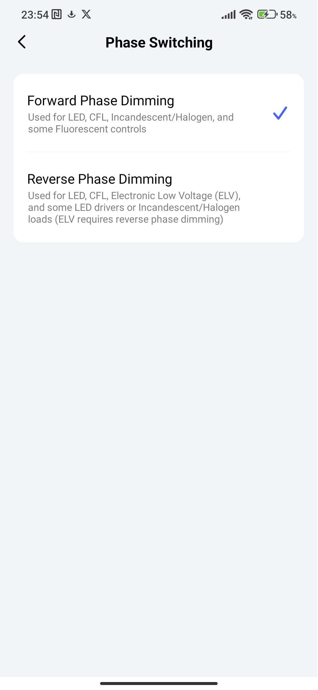

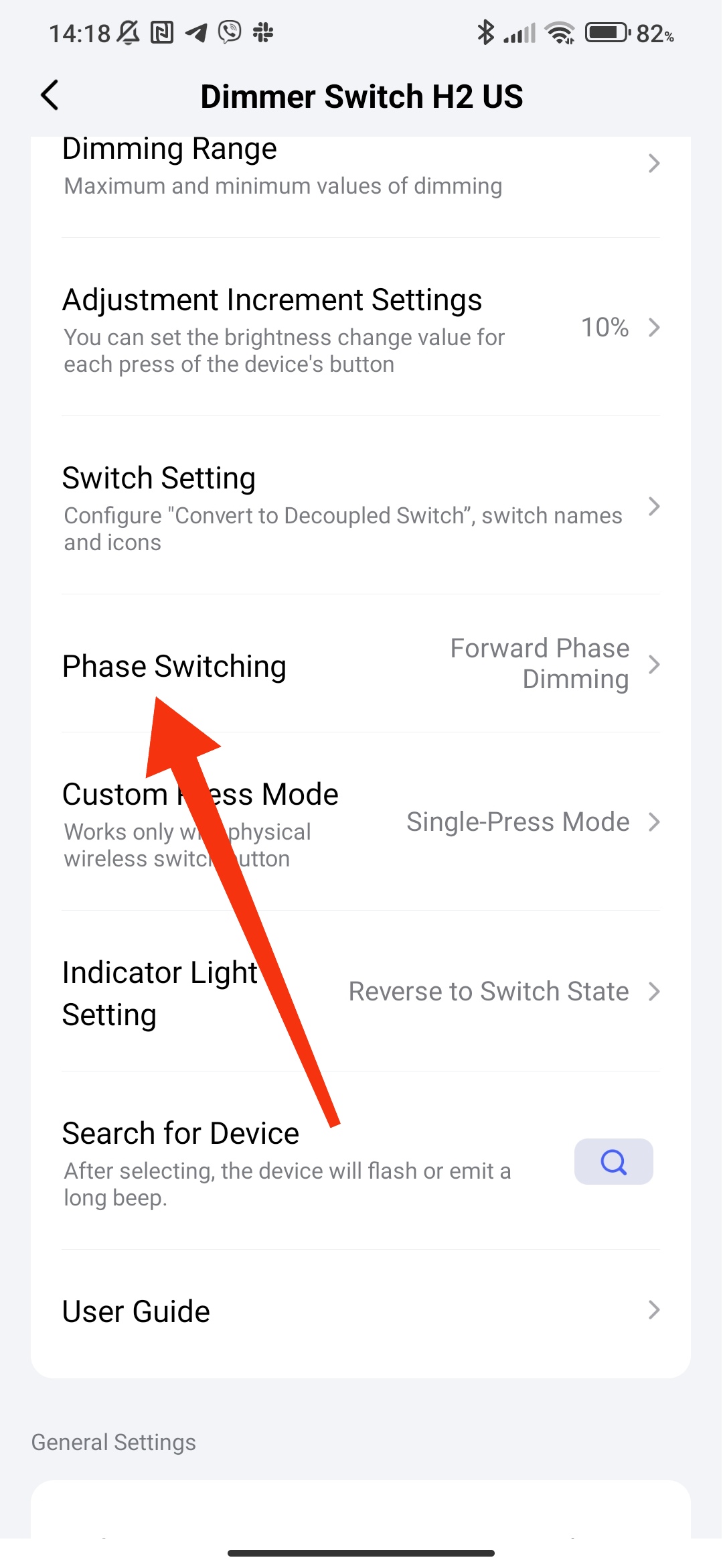

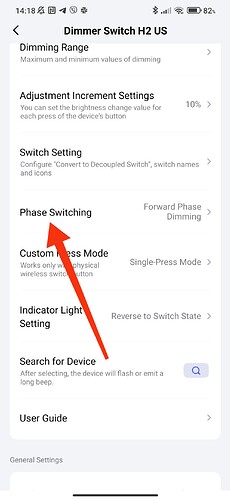

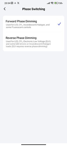

Hello, I don’t have this type of diameter, but I tested the American version. If you have a setting like the one I reset in the picture, try switching it. You can also set the dimming range so that the adjustment does not go beyond the dimming limits.
I can’t guarantee that it will help, but you can try.
I thought it was fixed but after several weeks now the dimmers DO NOT hold their MIN and MAX settings it’s honestly very disappointing !
I have tried now every setting etc. even different bulbs (expensive and cheap) no succes the setting doesn’t hold also the interfacing with Apple HomeKit isn’t great it would be nice if the Aqara developers are going to have a serious look into this !
Hello, pay attention to this parameter, it is very important for the dimmer. This parameter is unique, almost no one gives its choice, but Aqara has it. So that I don’t write a lot, search for it on the Internet. Someday, I will describe it on the forum, I just don’t have time now, sorry
