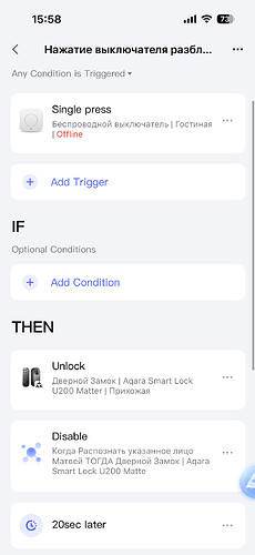

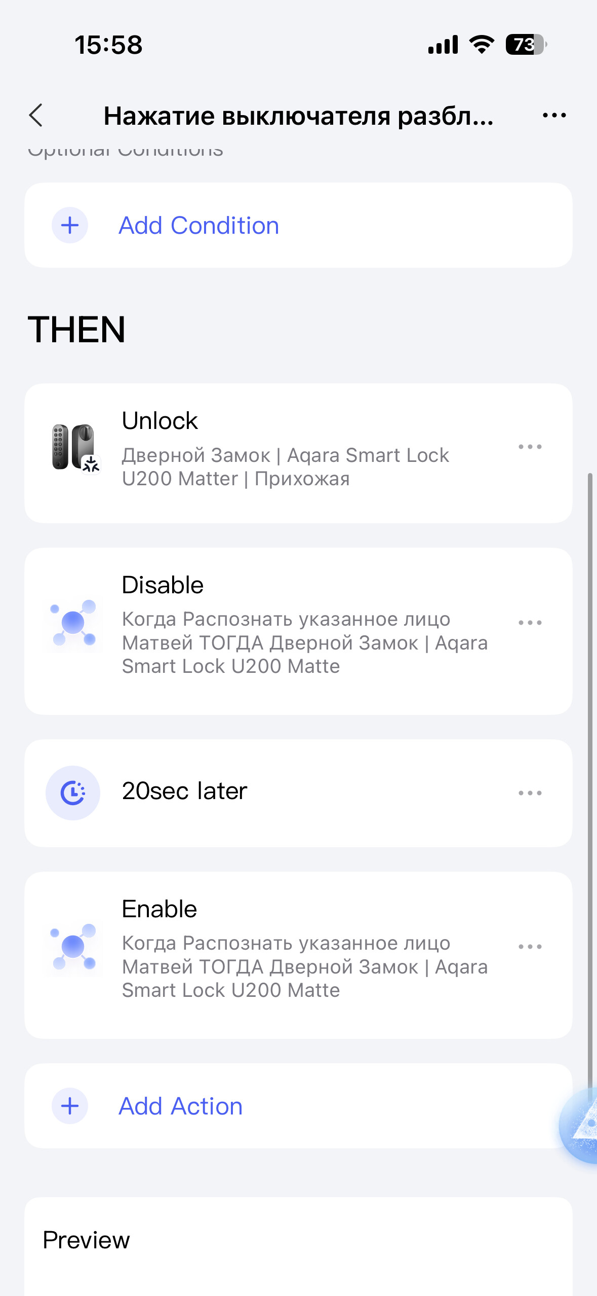

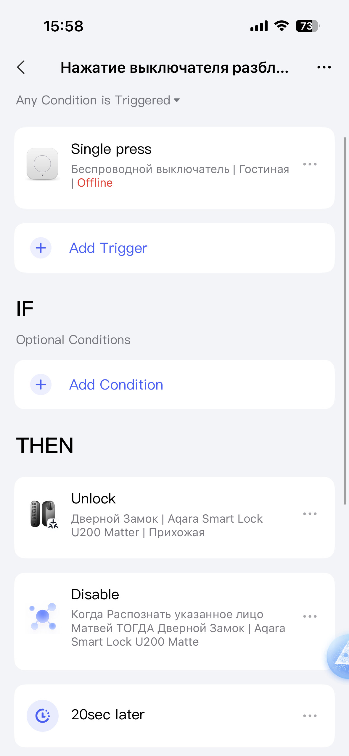

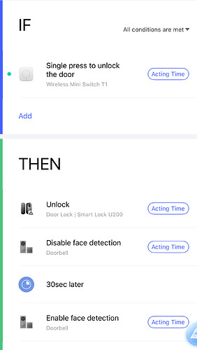

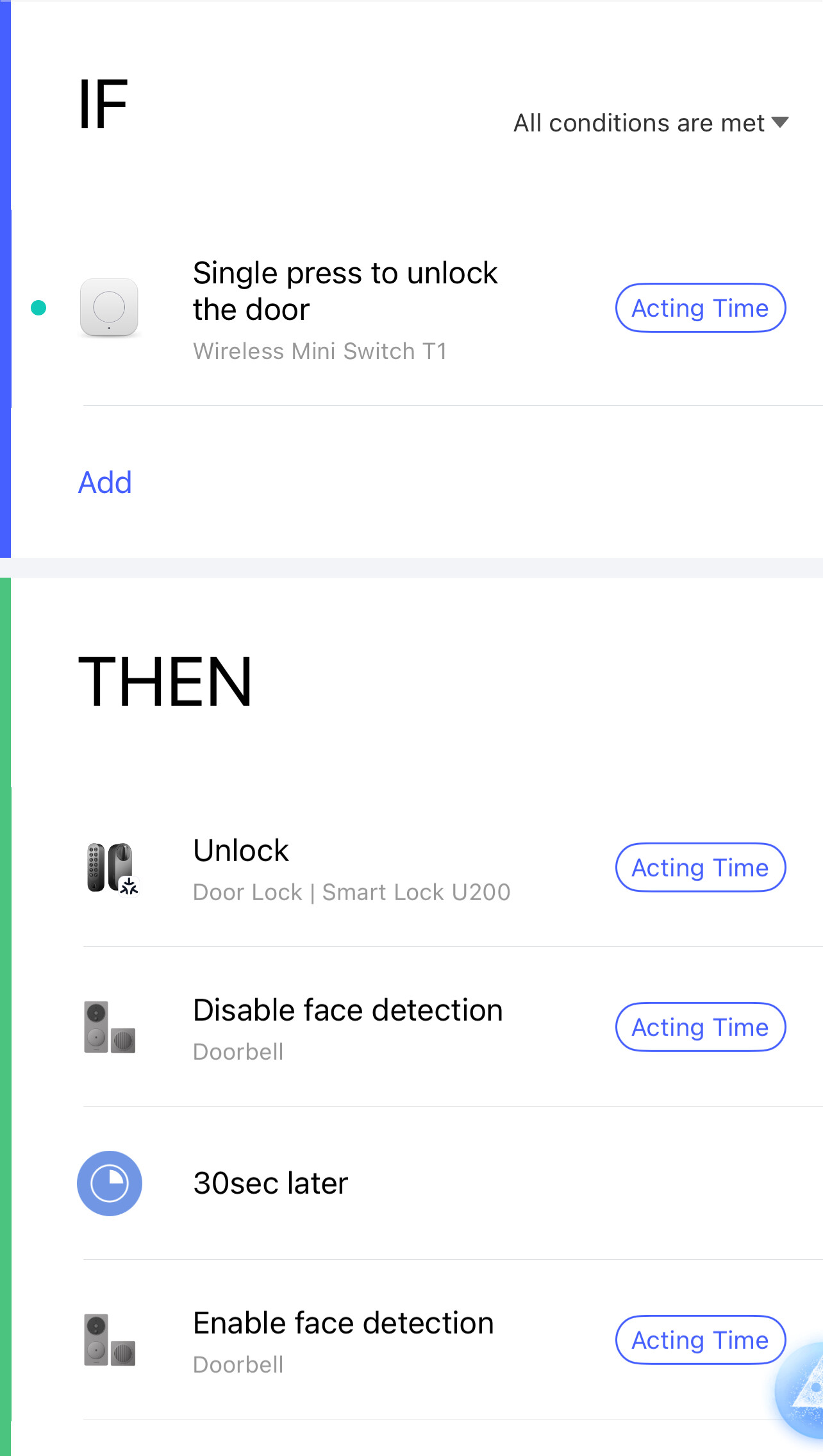

you need to add some items to your automation that opens your lock from the T1 button after opening the lock.
after opening → turning off the automation that opens the lock by face —> delay (a convenient pause for you so that you can go out and close the door and move away from the G4 field of view) —> turning on the automation of opening by face.

try this option - it should work.
