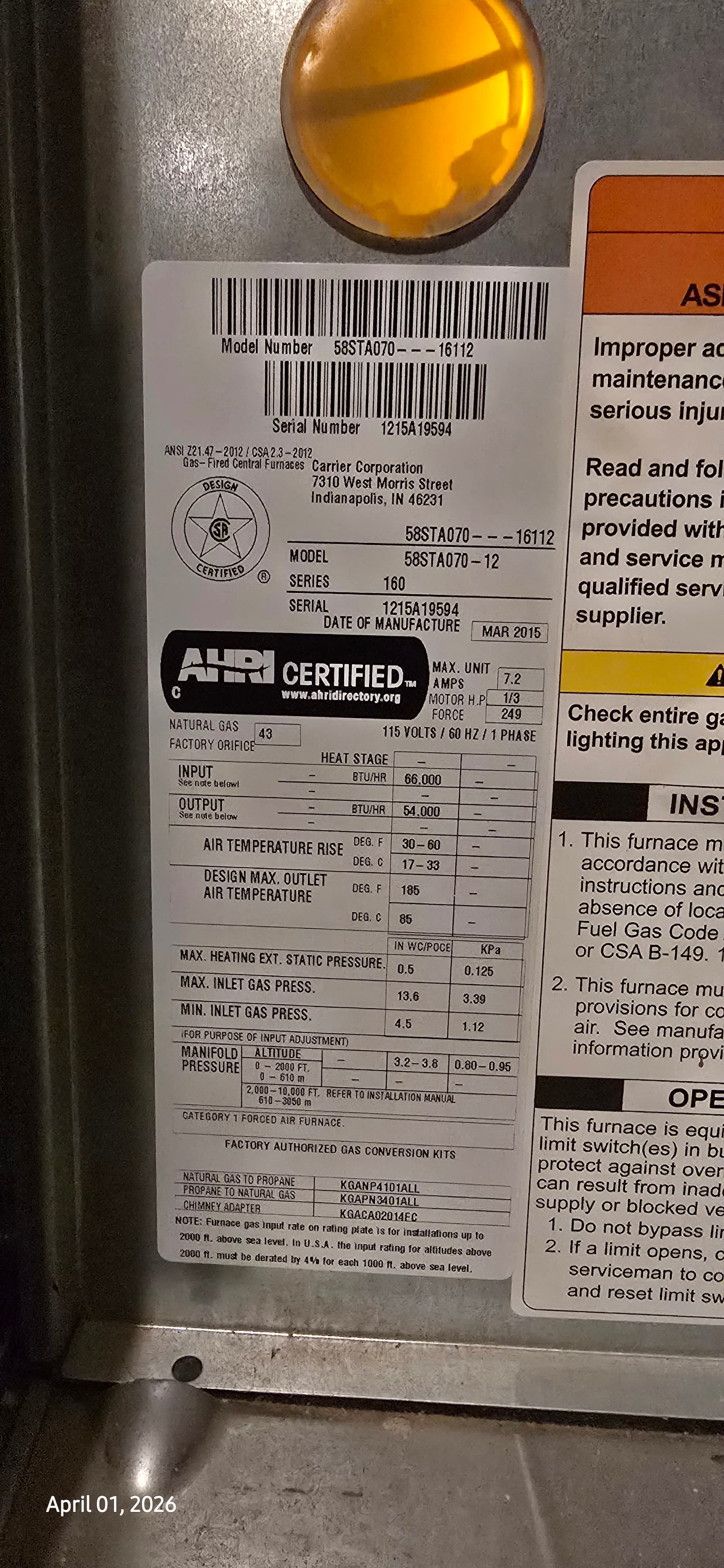

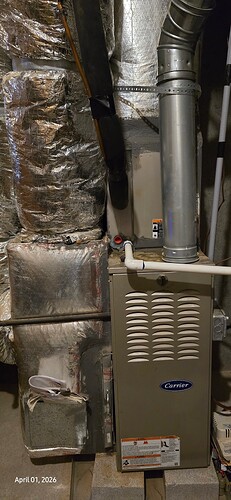

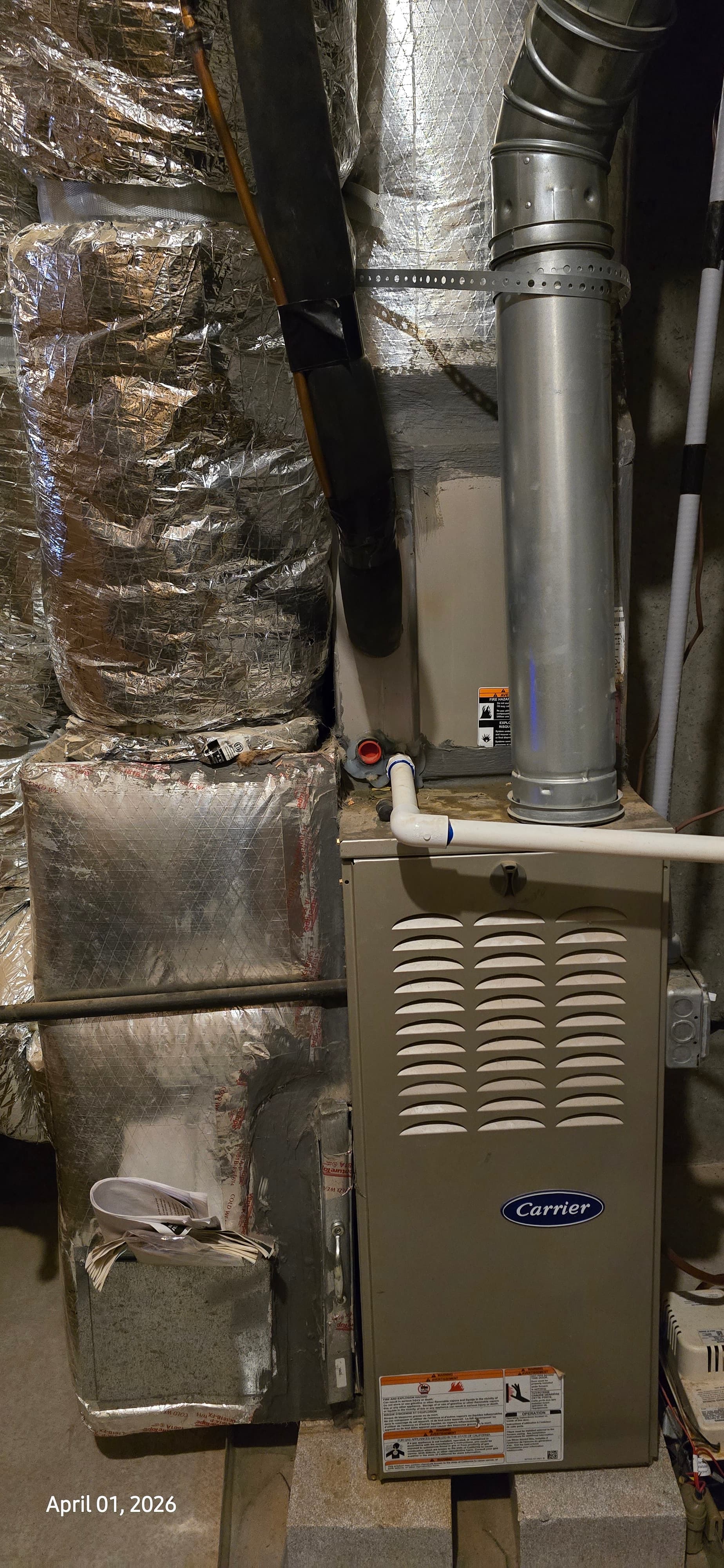

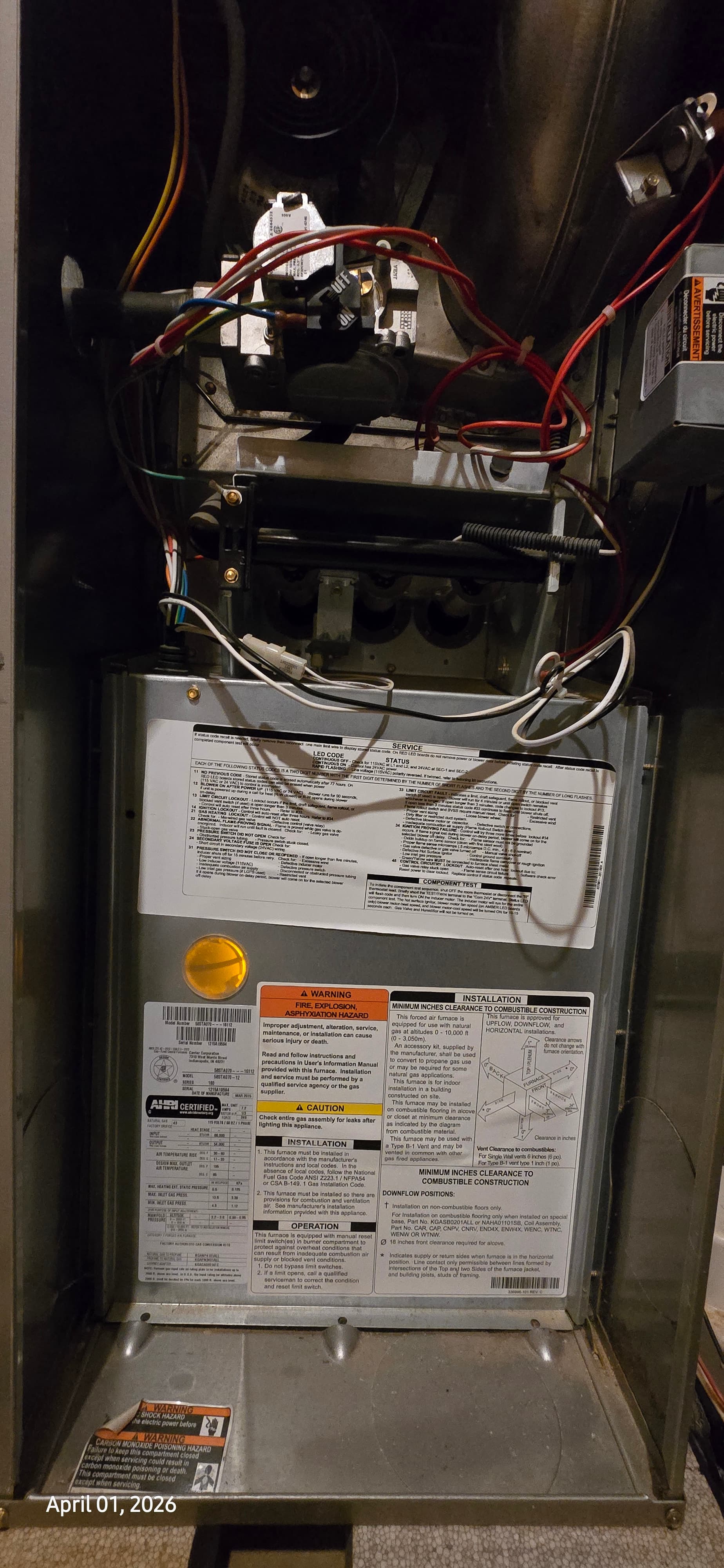

Here are pictures of the indoor unit with model number. I have not had a reboot since posting initially.
