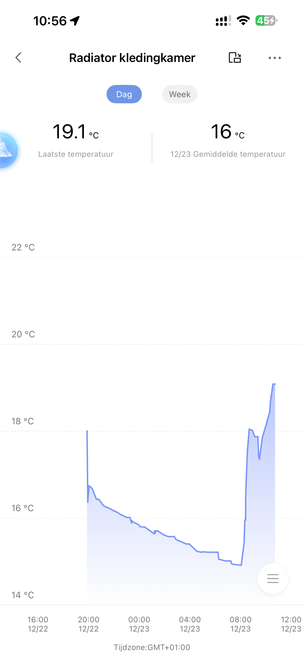

Here also overshooting of the requested temperature. Set to 17 celsius and it goes up to 19!
Current firmware is 0.0.0_1839 and is up-to-date

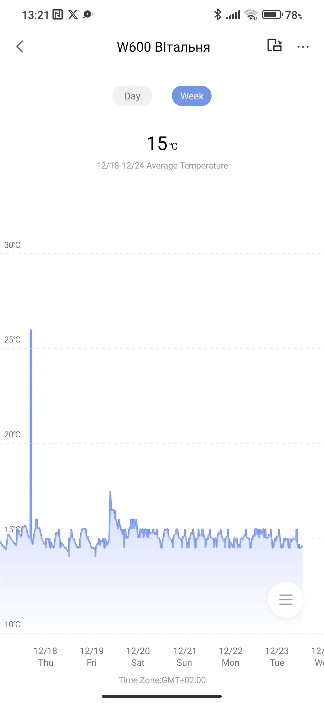

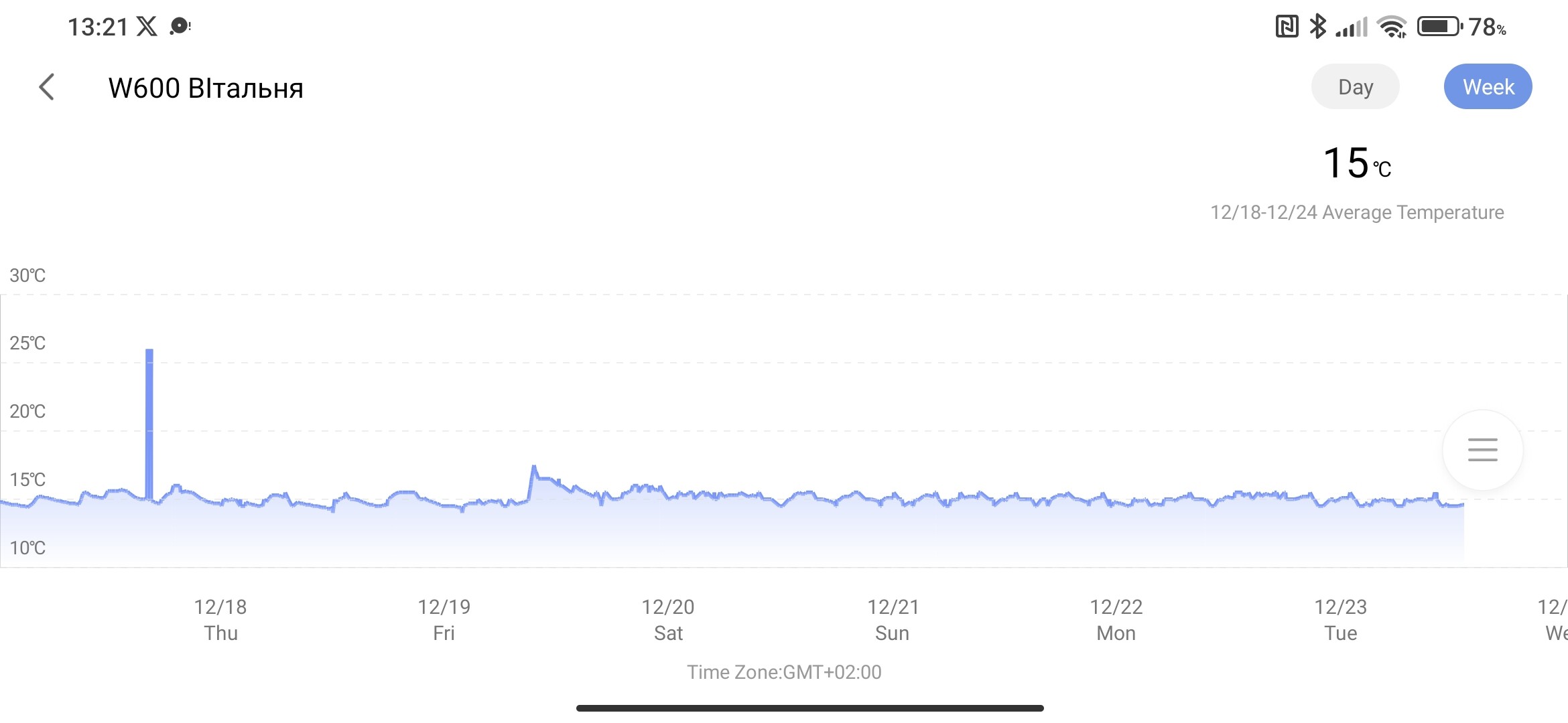

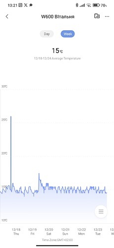

Screenshot proof of stable operation of the W600.
Set at 15° and then 14-15°c fluctuations?
If yes, that is nice yeah.
Guys, is it really 15 degrees in your apartment? What’s the point of having thermostats then? My heating doesn’t even kick in at 20. I’d love to see a graph with the setting at 22.5 at the very least.
Hello,
Haha, 22°C is the tropics, there’s nothing to breathe. My working room temperature is 18°C. On the screen is a room (non-critical) where I can set the temperature without a signal to the boiler (start) 15°C.
Look at how it was before the update and how it was after, I specially made a large time sample.
Yes, 15°С.

I have the new firmware but still issues.
Today, one thermostat just heated to 28 degrees out of nowhere. It was set to 15! degrees.
@AqaraBot @AqaraOfficial this is costing me money every day. No one ever needs 28 degrees! How can things like this happen?
