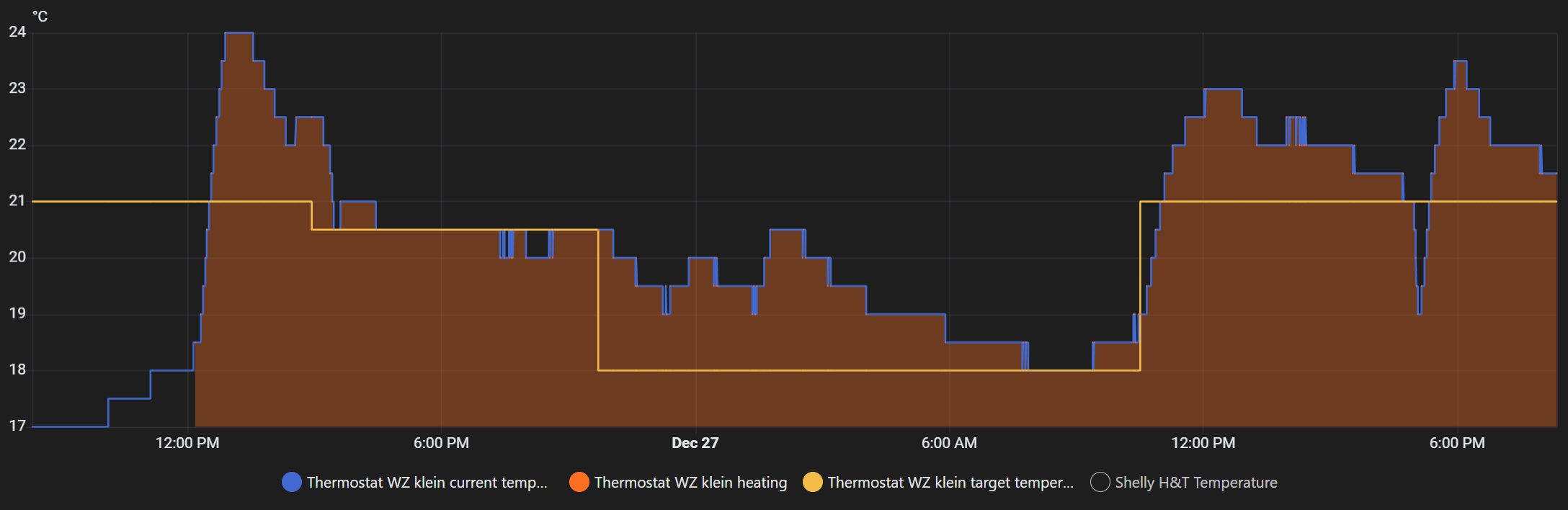

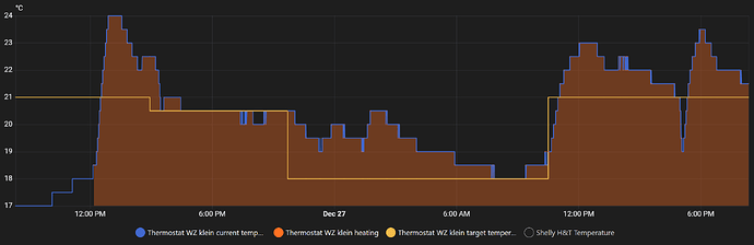

I can confirm overheating with Thread firmware 1.0.0.6. Here are some plots showing the current and target temperature of my thermostats since yesterday morning:
Thermostat 1:
As you can see, there is quite some overshoot when activating heating mode and also some oscillations during the night, when I lowered the target temperature to 18°C (which is never reached). During the day temperature seems to settle at 22.5°C, although the target is set to 21°C.

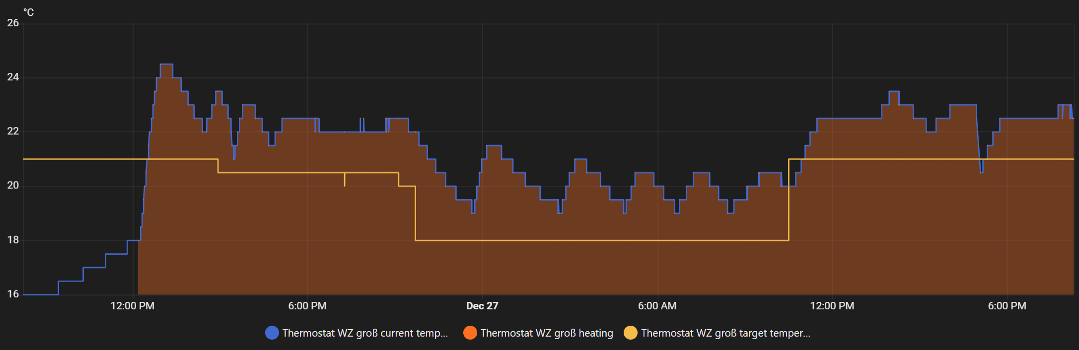

Thermostat 2:
Similar picture but less pronounced.
I would expect the thermostats not to heat up the room by several degrees if the current temperature is already above the target. In this case the valve should be opened just enough to reach equilibrium.
