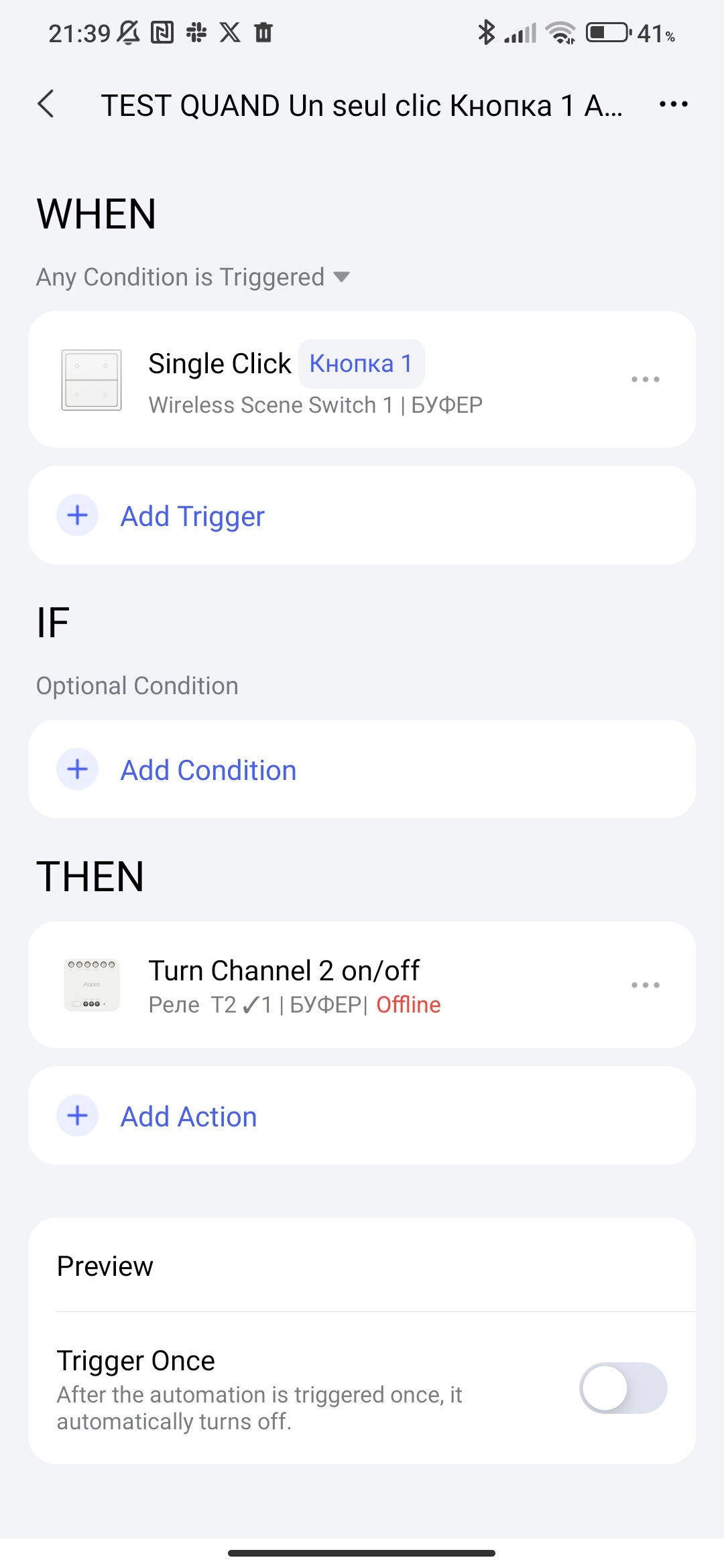

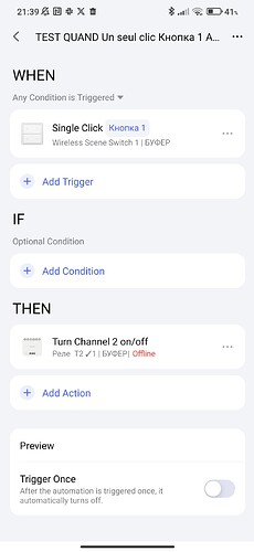

If you can, take screenshots of the automation screen and T2 relay settings. Then I will understand and give advice.
