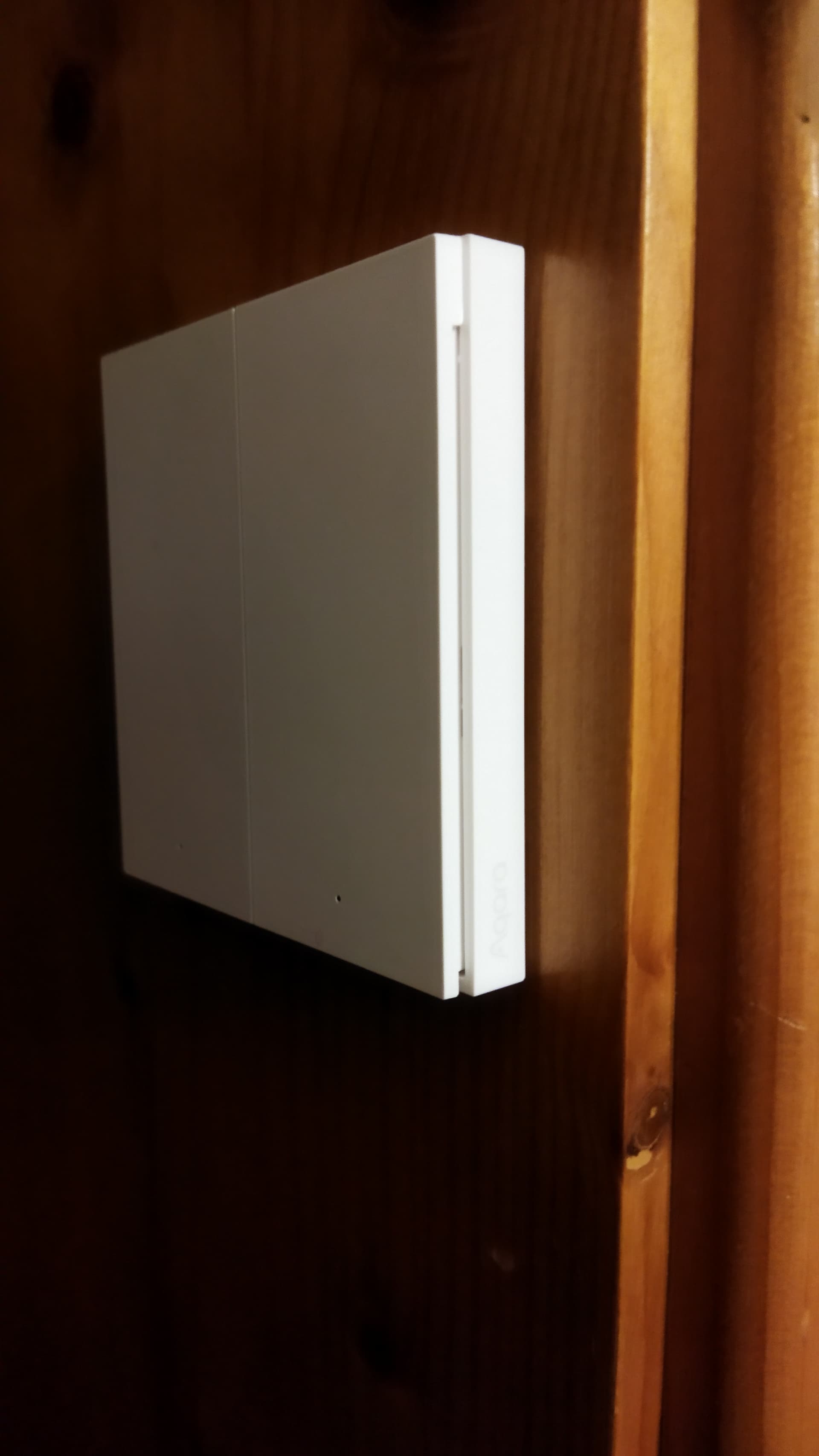

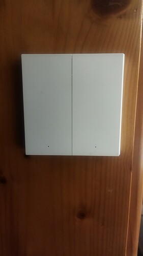

1.I’m talking about this wireless switch, in my video it is attached to the kitchen door. Aqara Wireless Remote Switch H1 – Aqara LLC
2.Then it’s better to take another wireless one and use it instead of Y
I specially took a photo of the wireless switch.
