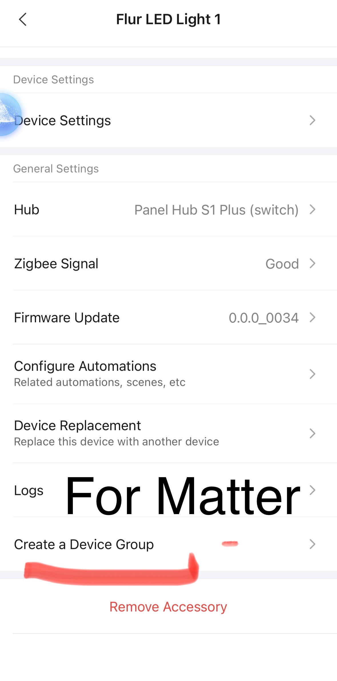

So Aqara ! I have an urgent request. For all Zigbee bulbs , light products from Aqara it is possible to group several bulbs , lightstrips , ceiling lights and so on! Great and awesome feature!
But I miss this feature also for my Matter lights!
Best would be, if we could also mix Matter and Zigbee products to a group!
Please make this possible and give us more options to Matter devices

You might already be able to do this. Just go to the ‘Add New Device’ option under Devices, then select ‘Add Light Group’ (Matter or ZigBee is not important) or any other available devices.
Oh thanks @gtxteo saw this option once but seems I forgot again! I was looking for this directly in the settings of the lamps ( which is available in the zigbee bulbs)!
But didn’t found it in the settings of Matter bulbs !
