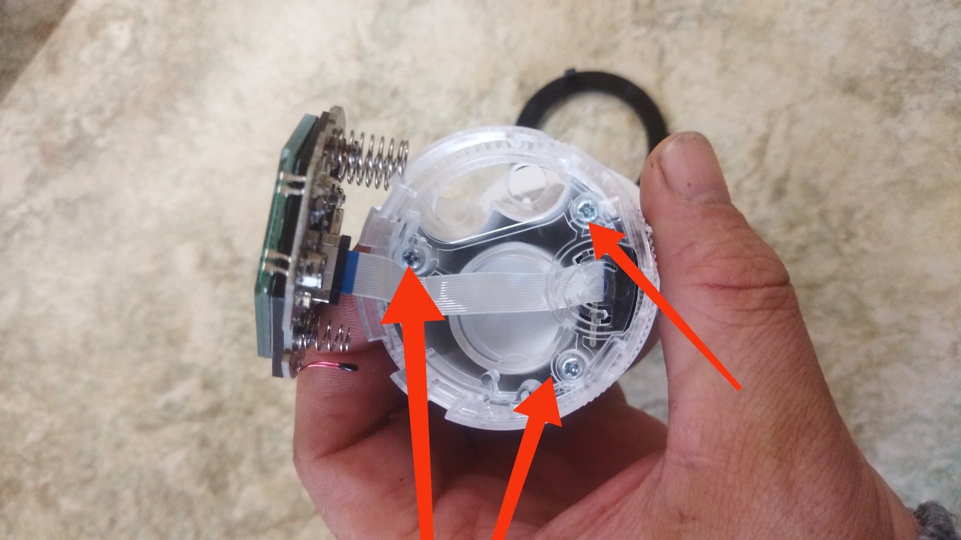

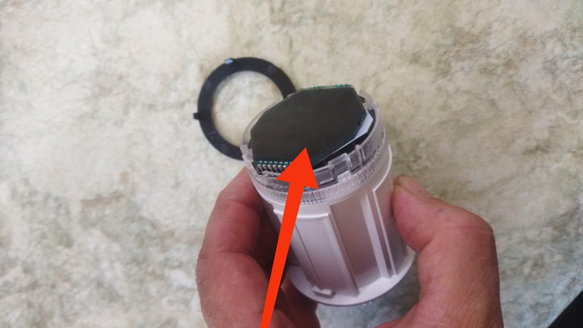

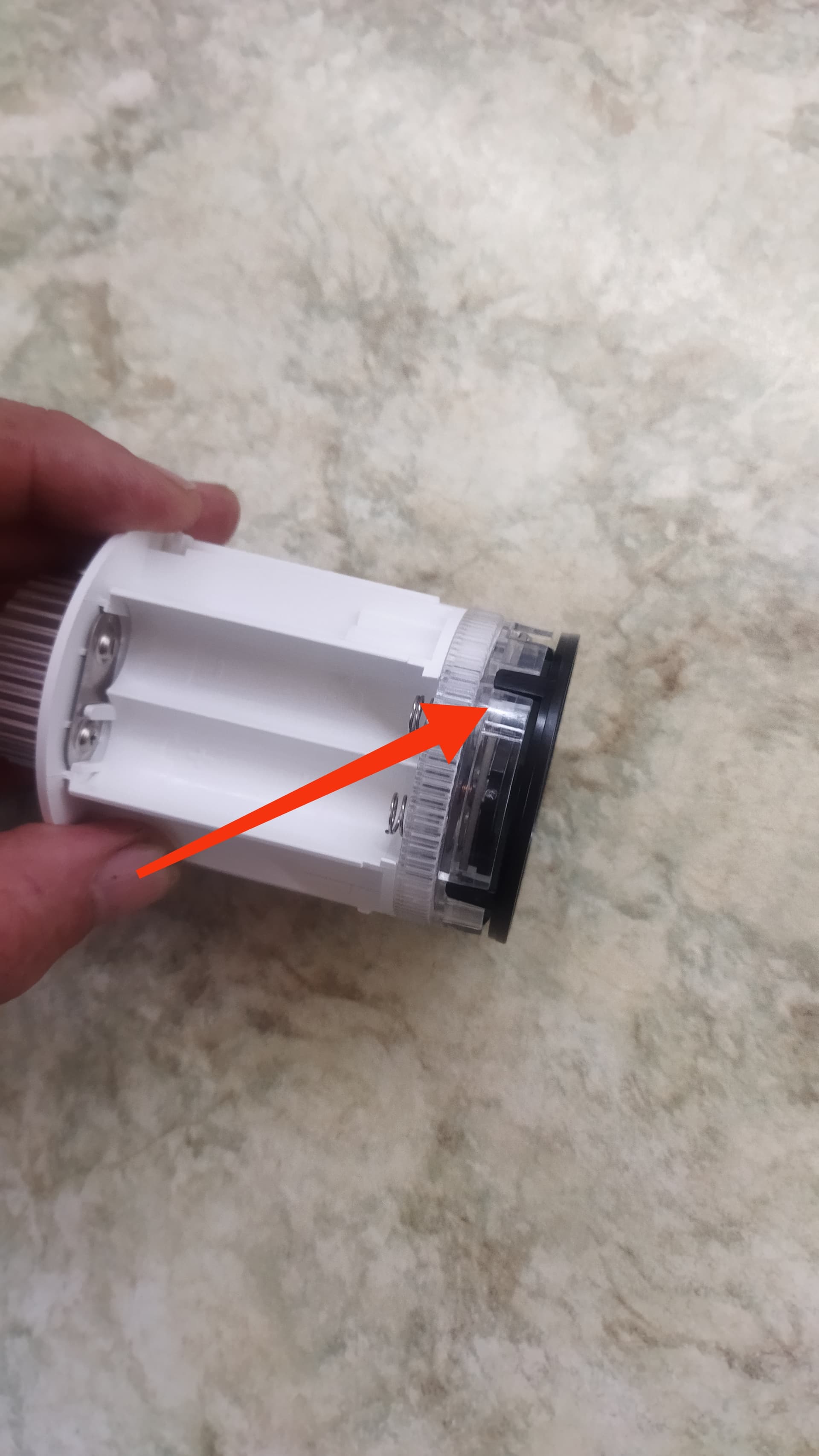

do you have a picture of which of the bosses are likely to crack?
You can see them in this picture. I had the same issue with 2 of my thermostats

I’ve run into a similar issue with one of my Aqara devices here in Singapore. The screw bosses in the E1 housing can be surprisingly fragile, and once they crack, it’s frustrating to see an otherwise fully functional thermostat become unusable. I’ve found that careful handling during installation helps, but it doesn’t completely prevent the problem over time.

I agree that releasing official 3D models of the E1 housing would be ideal. It would allow users to make reinforced replacements and extend the life of their devices without scrapping them. In the meantime, using PETG or ABS and reinforcing the screw bosses with brass inserts has worked for me on other small enclosures. Just be sure to torque screws carefully to avoid repeating the same issue.
