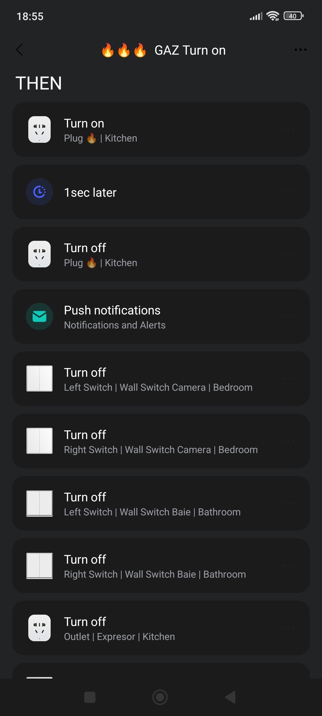

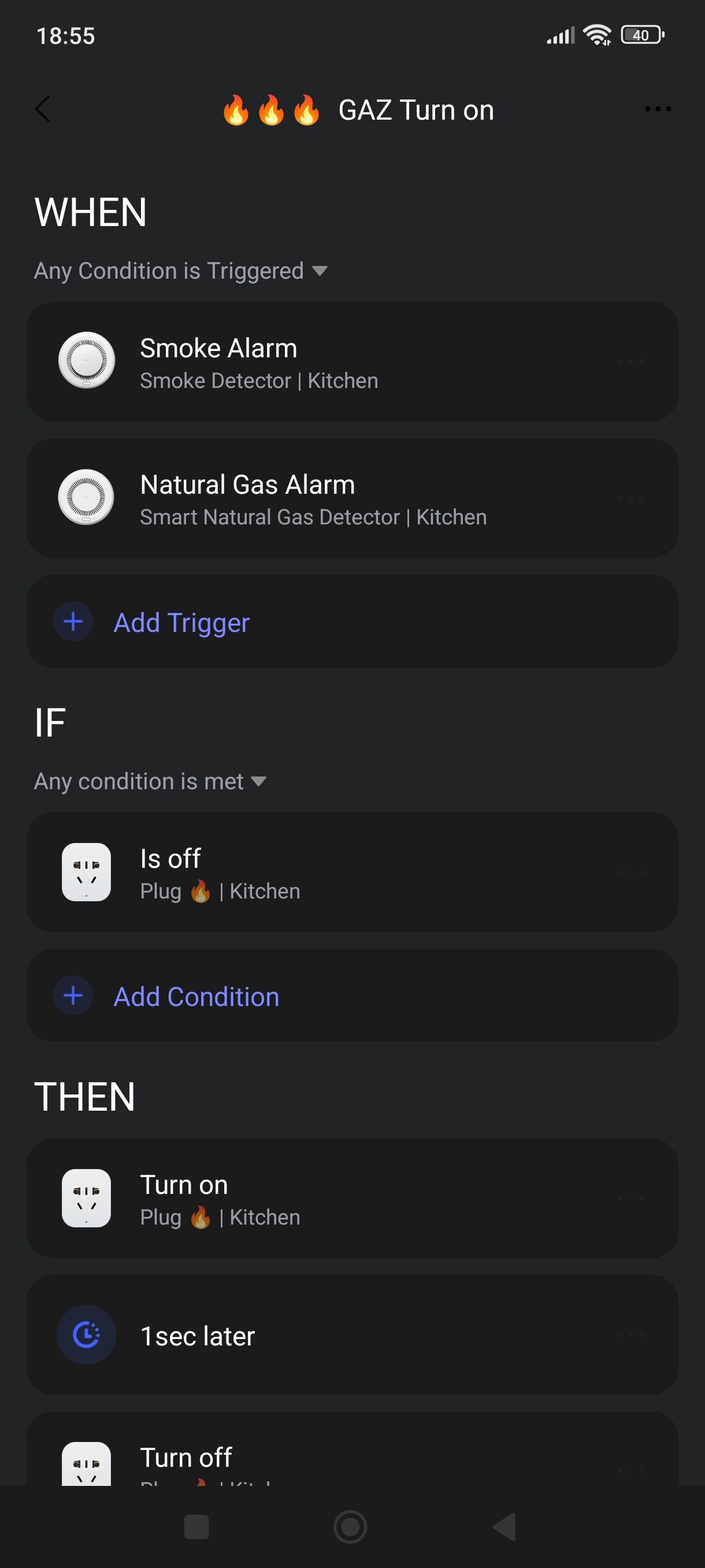

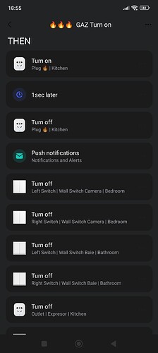

The main actors in the following film are: the Aqara smoke detector, the Aqara gas detector, the Aqara smart socket and the unknown solenoid valve for methane gas. In the supporting role: the Aqara socket and switches. When smoke/gas is detected, the smart socket transmits an electrical impulse to the valve, the valve that closes the methane gas pipe that supplies the boiler and the cooking hob, an action followed by the closing of all the lights and all the sockets, TVs. Below you can find the printscreen. with the designed automation. Enjoy.
PS: for those who want to use a smart socket, it does not have the electrical impulse function like the T2 relay. It must be turned off after 1 second by automation, as in the printscreen.
