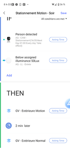

Automation Logic Subtle When Idle, Bright When It Matters

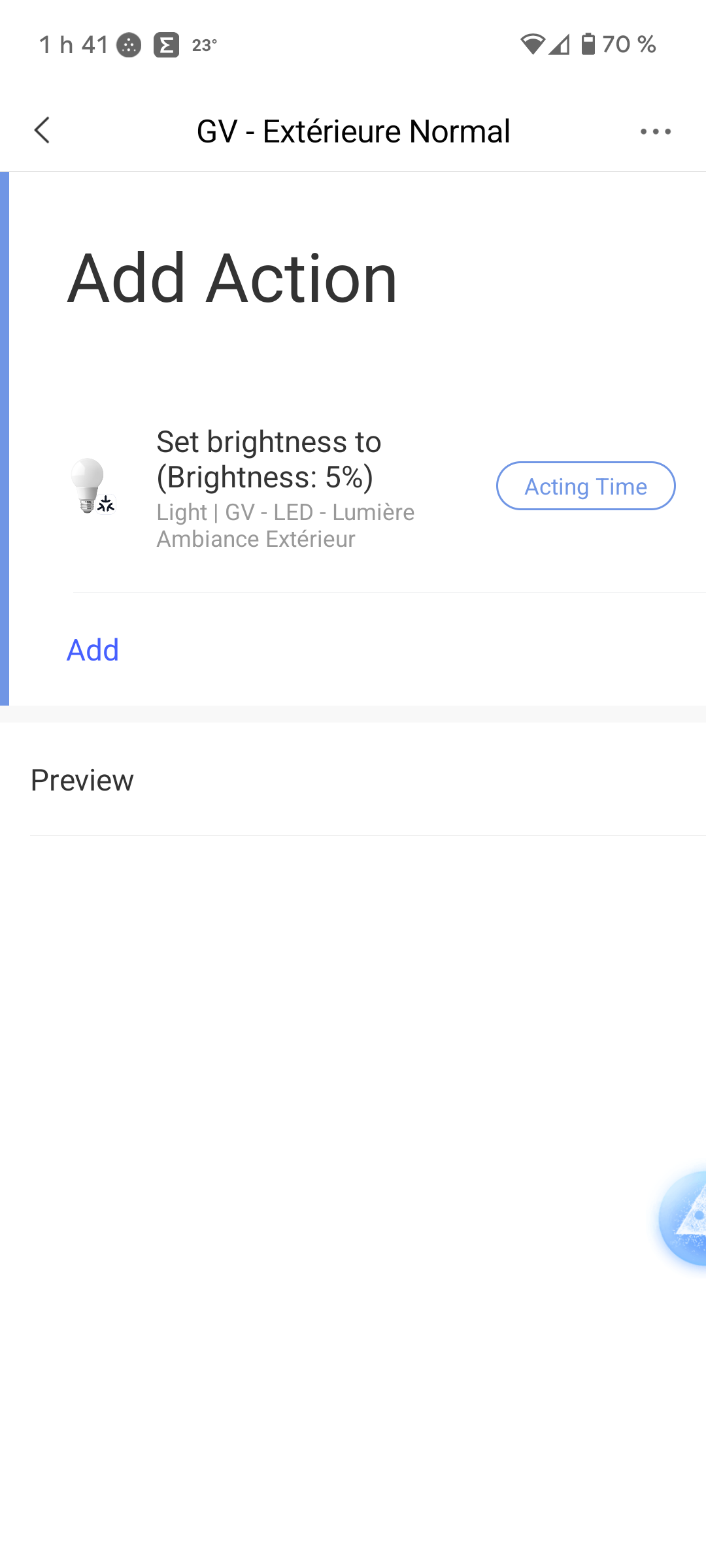

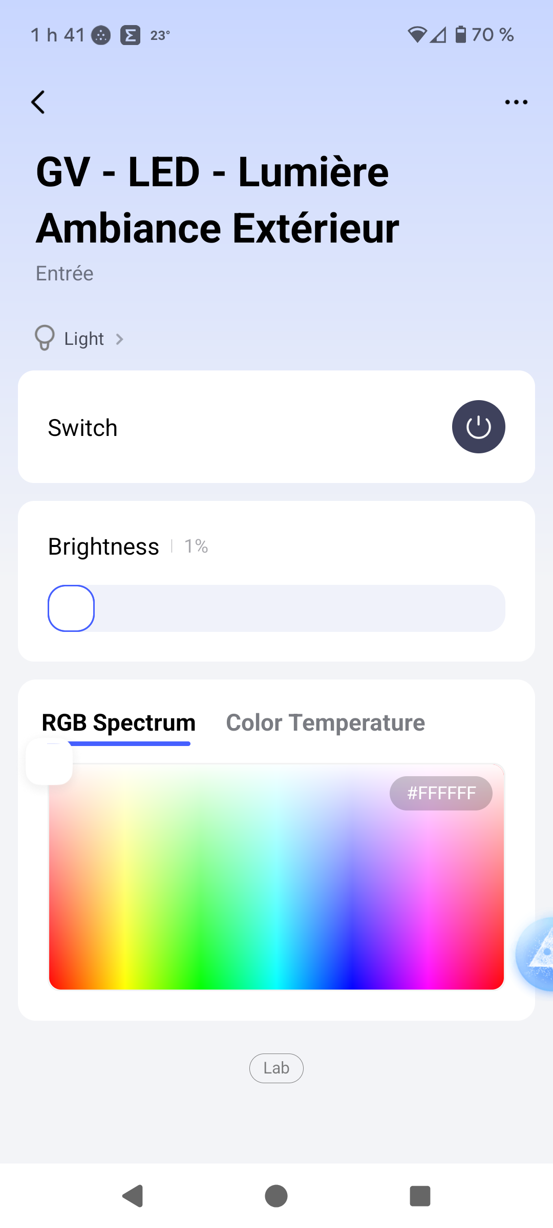

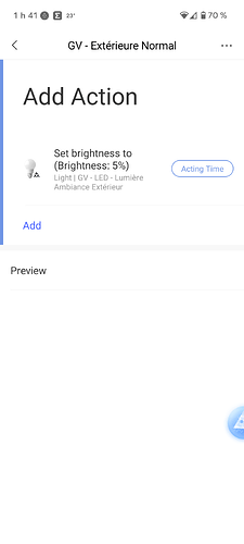

At sunset, the Govee light turns on at a soft 1% brightness to provide a subtle ambient glow.

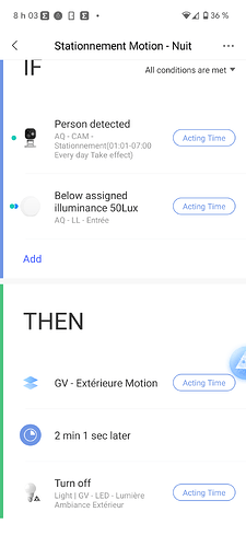

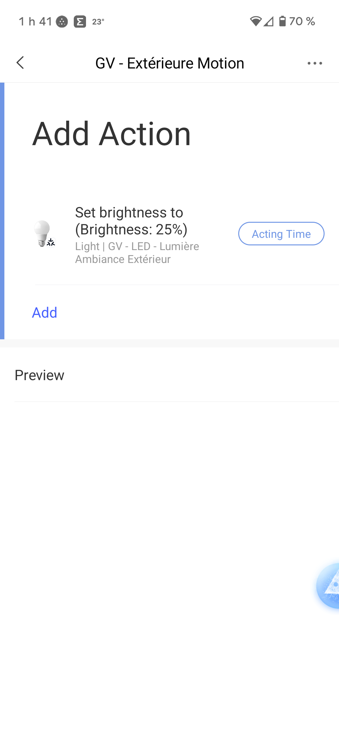

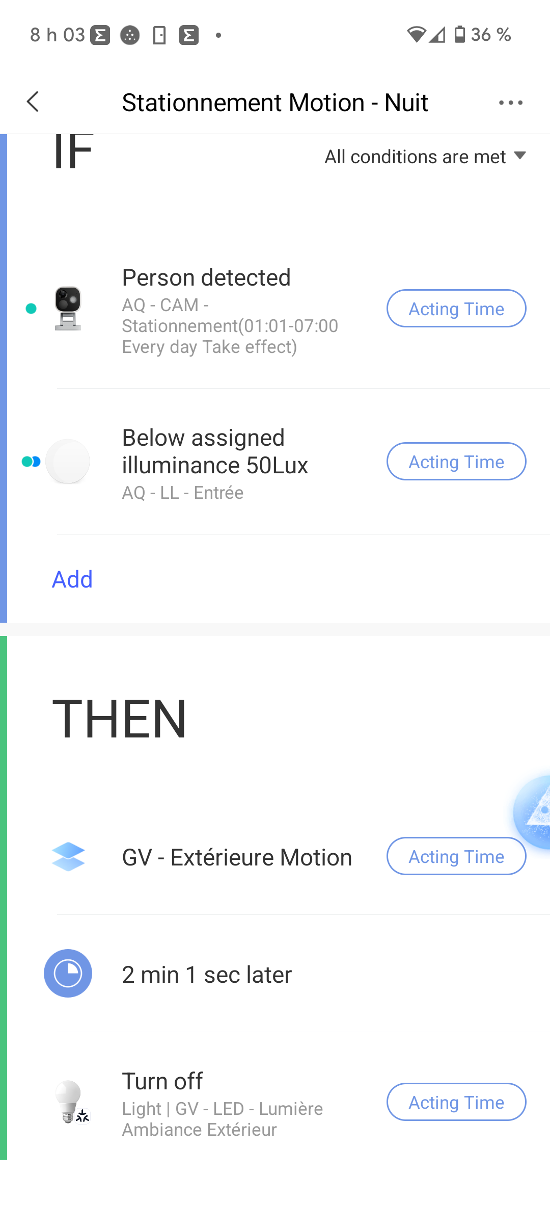

When the Camera G5 detects a person:
  • The light instantly jumps to 25% brightness, lighting up the area and signaling presence.
  • A timer keeps it at 25% for 2 minutes.
  • If motion continues, the brightness stays at 25%.
  • After 2 minutes without motion, it dims back to 1%.
This automation isn’t just smart, it’s energy-smart!
The light stays low to save power, but jumps to life when it sees someone. Super practical when I come home in the dark, have friends dropping by, or when a heroic pizza delivery shows up during a late-night snack attack.
Because let’s face it, no one wants to trip over the steps holding a pepperoni pizza at 11 PM!
Its also a nice security feature.
Everything runs locally on the M3, ensuring fast and reliable execution with no reliance on cloud services.
My outdoor light is sheduled to turn on when the outdoor lux is under 50lx and turn off at 1 AM. So based of this, I have one automatisation to set back the light at 1% and an other one to turn off the light if it’s trigger after 1 AM.

  • Pairing the Govee H705 via Matter QR code into Aqara Home was quick and smooth.
  • Brightness control and on/off features are fully accessible in the Aqara app.
