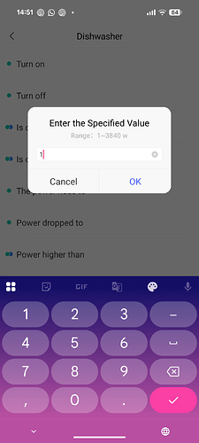

More annoyingly, I want to make an automation that when my dishwasher is done, so it uses 0W, it sends a notification that the dishes are ready to unload. The signal system in the Aqara app would be incredibly useful for this, making the automations possible through that, but sadly this only allows for a minimum of 1W. While my dishwasher often uses below 1W midst cycle.

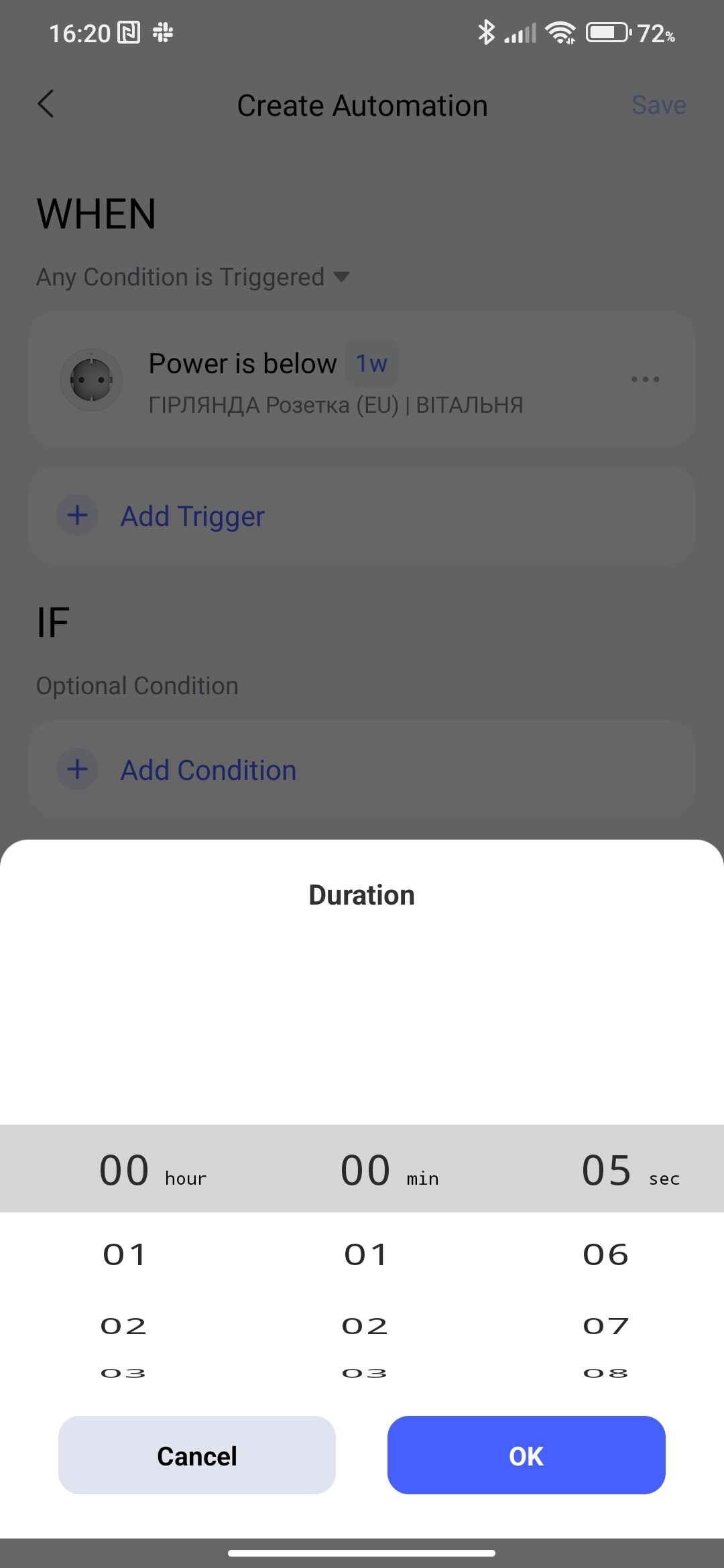

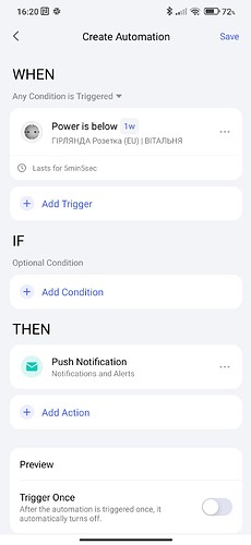

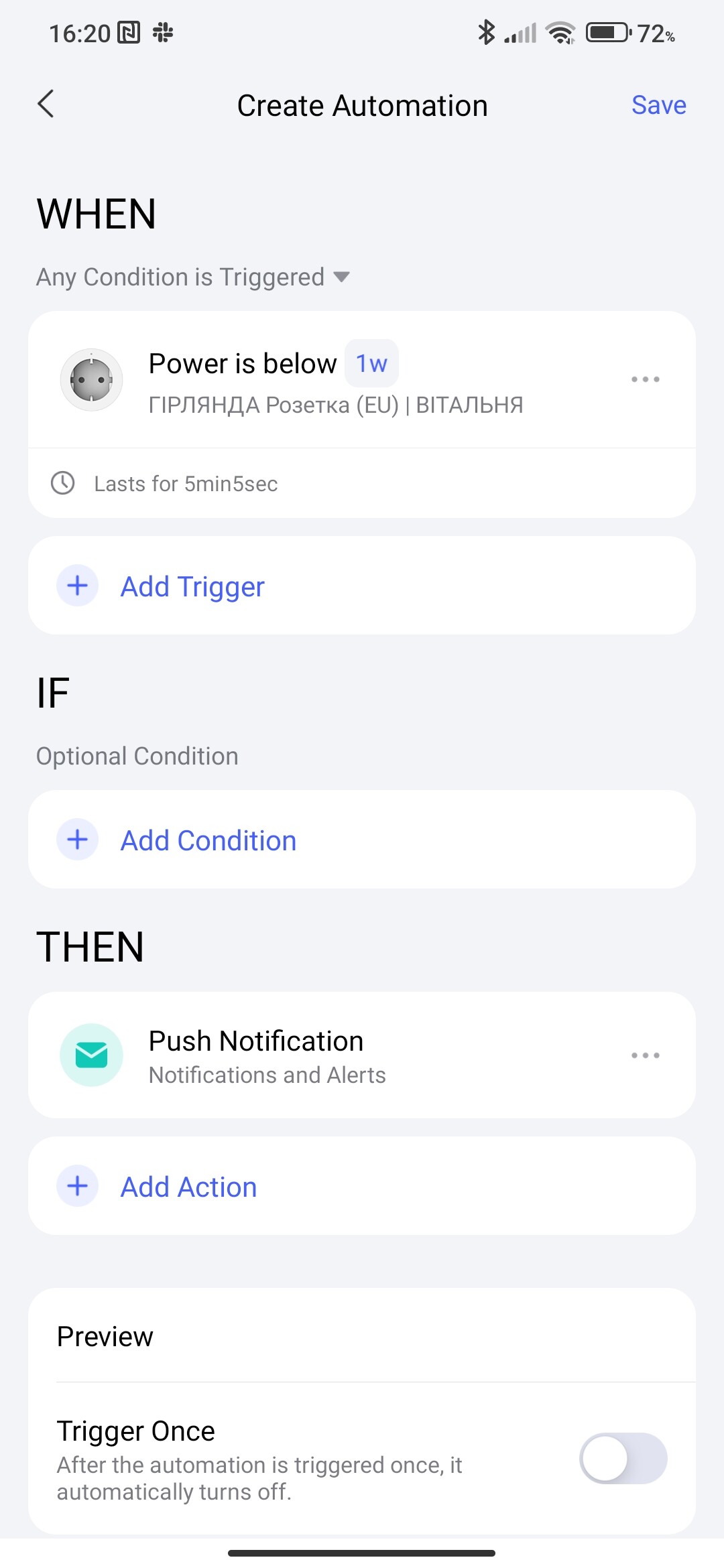

Hello, welcome to the forum. Your problem can be solved by using a delay in the WHEN condition. In the screenshots that I made for the sample, you will receive a push notification when the power is less than 1W for a specified time. You should calculate this time yourself, research how long the power can be 1 W during operation. Automation 2.0 lessons are here (Fig. 14) Automation 2.0. Lesson2. Advanced settings "..." (Execution time, delay of conditions, reversal of conditions) is - #2 by AqaraBot
