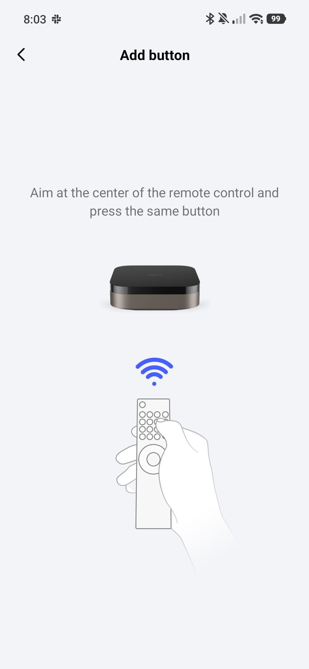

There is a function to add manually, press your remote and assign a command to the M3.

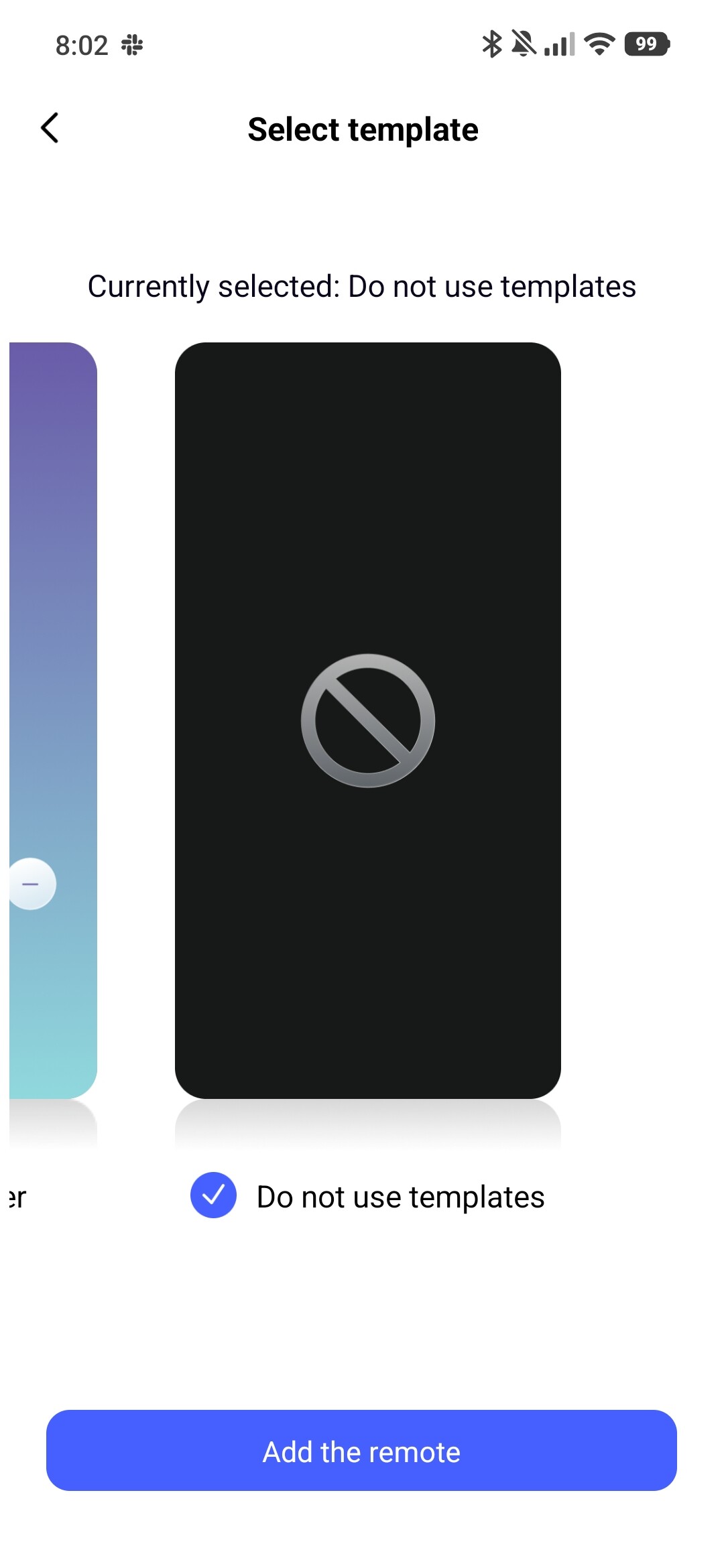

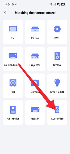

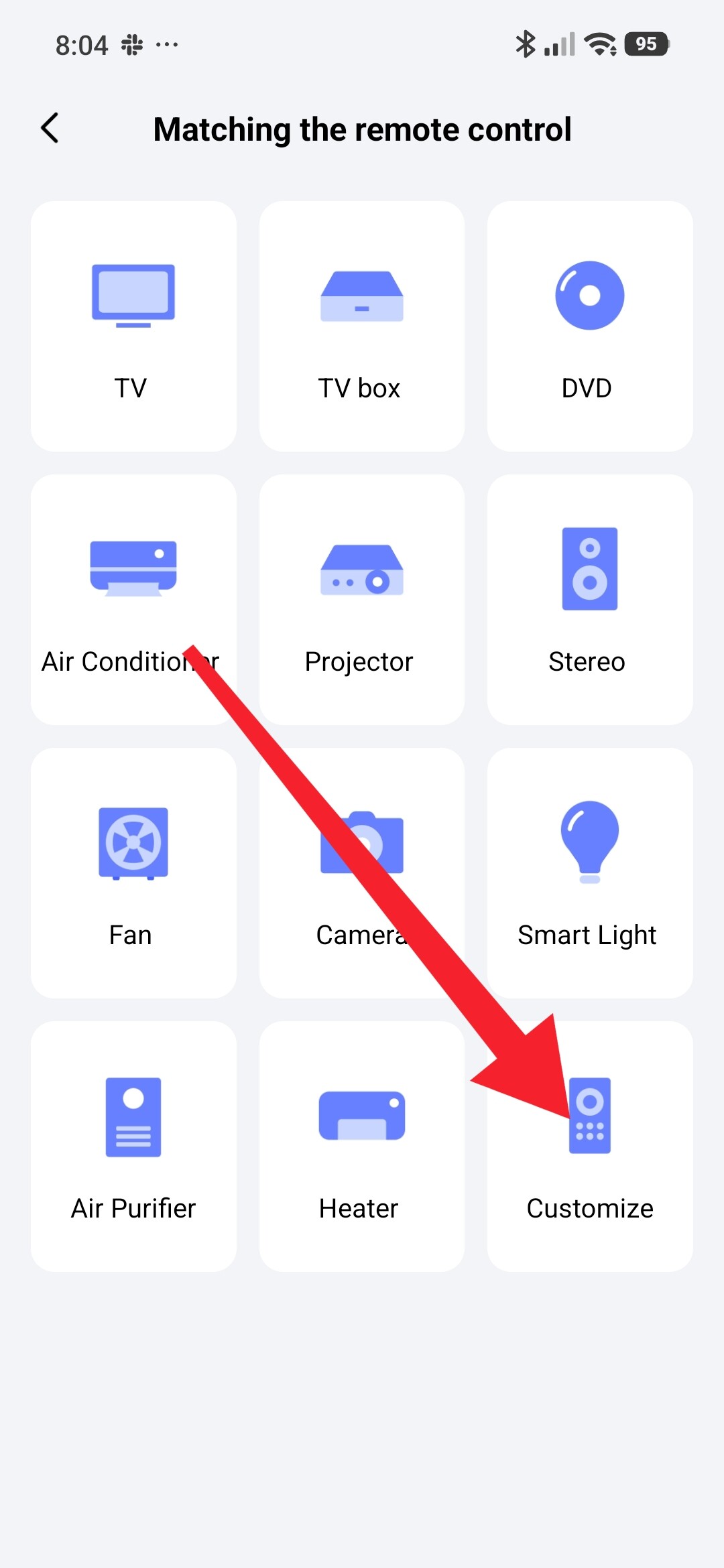

This is what I tried actually, using customize and non template option. But it just won’t recognize
Hello, when you push your remote control in the direction of M3, what happens? Describe how you “teach” M3?
