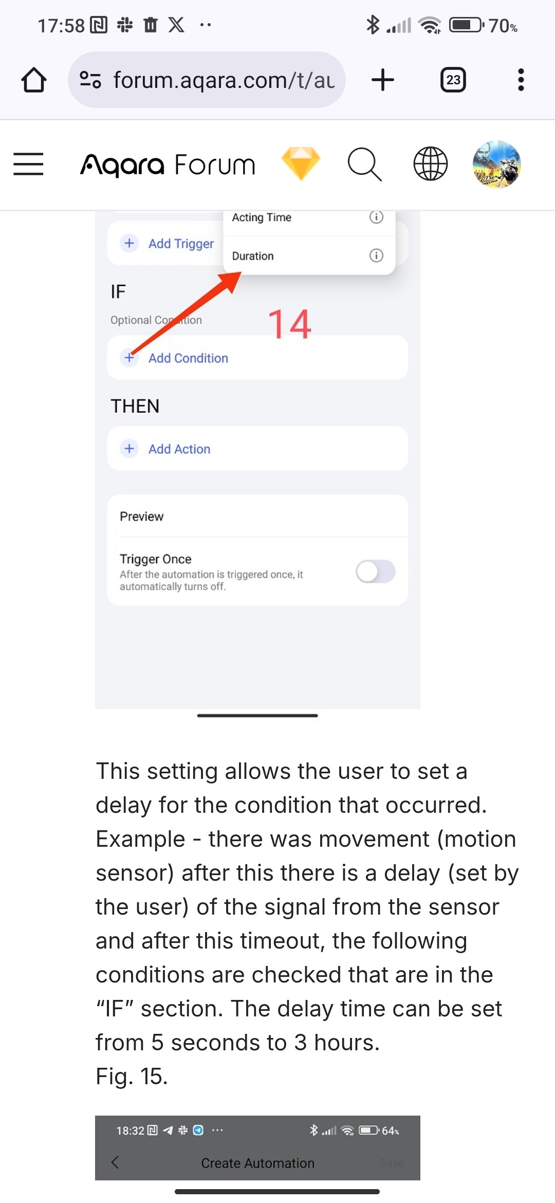

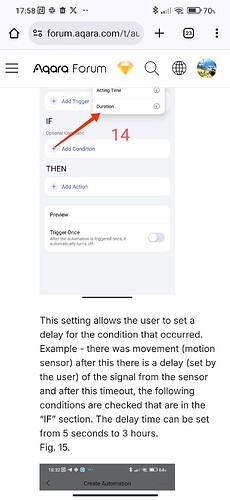

Hello, I also described this in lesson 2. This parameter delays the check in “IF” conditions, I took an example about movement. In your case, this is the power of the socket 5W in WNEH (the timeout of the check that you set to “period”), after this period, this socket is checked for 5W.
Fig
But understand, this delay can be used for another “IF” check (not only sockets), for example, changes in humidity (temperature), if the humidity “IF” does not drop during the period that you set to turn on the additional heater (fan). I think you understand that the second example is not about 5W but about a higher power.
It is impossible to consider all cases of automation for a separate device thematically. The field of creating these automations has no limits, it’s like every artist (artist) writes his work the way he sees it.

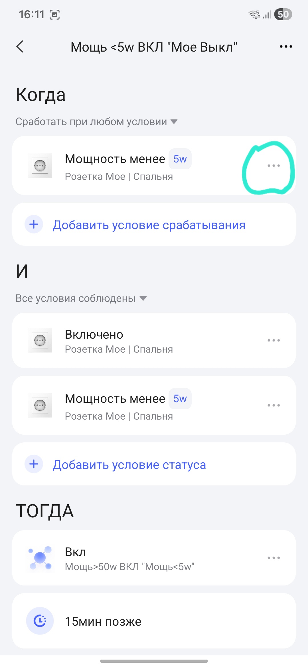

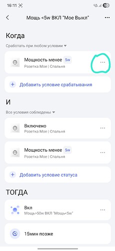

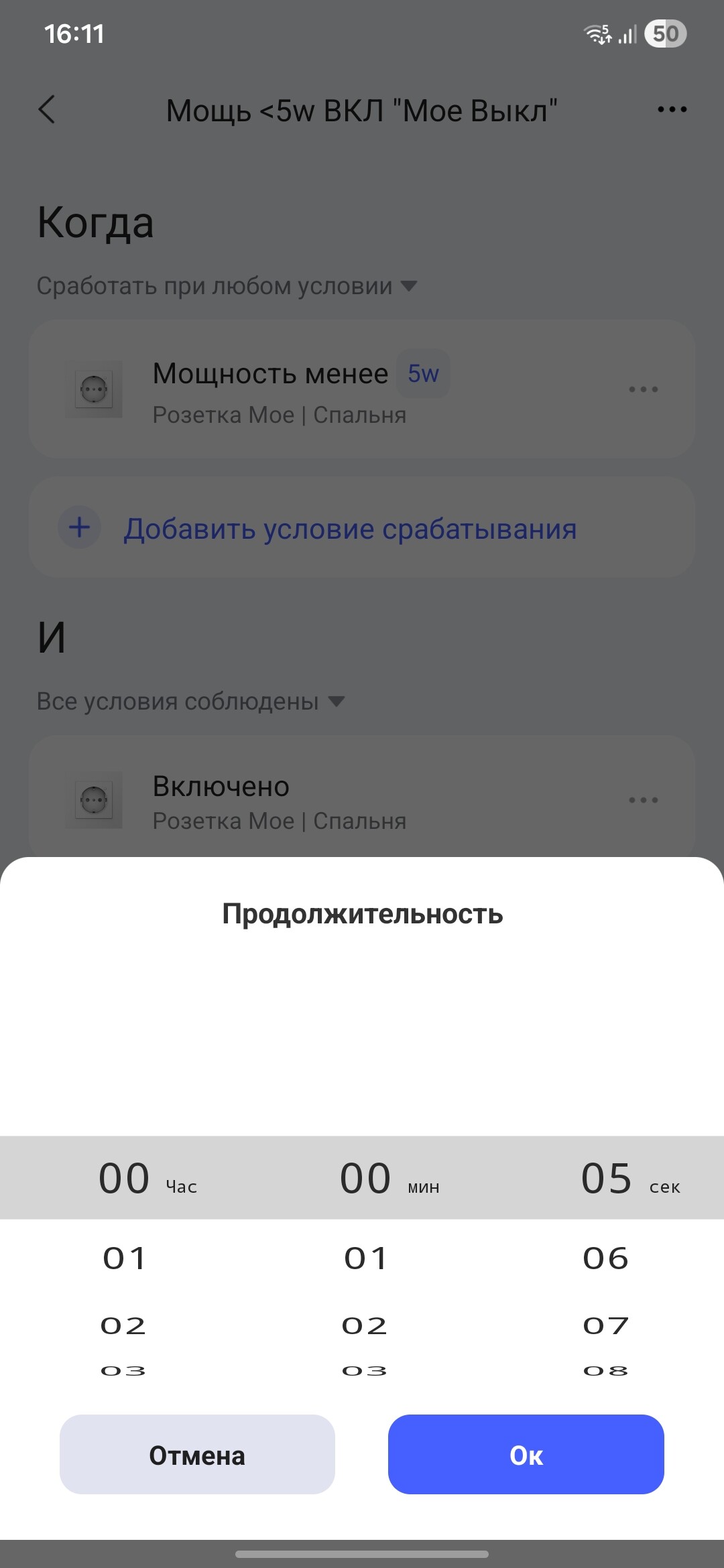

Yes, the point is, if I plug in the outlet without plugging in the device, it trips after a certain amount of time. For example: WHEN the power is less than 5 watts, THEN turn off the outlet after 30 minutes. But if I was using the device, even after three hours, if the power drops below 5 watts, the automatic circuit breaker immediately turns it off. Although, in theory, it should only turn off after 30 minutes.
I understand perfectly well that the delay can be used for different purposes. Testing it on the outlet is the easiest way.
It’s just that to achieve this condition I have to create 4 automations instead of one.
Sorry, I can’t understand the algorithm. Please make a screenshot of the automation that doesn’t work the way you want.
