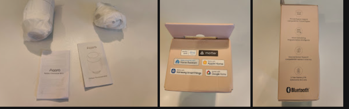

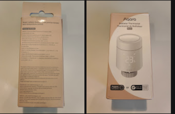

Unboxing
Some photos of the unboxing.
The device looks rock solid, heavy and nice.

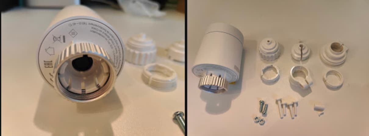

Accessories are very complete and should be compatible with all kind of valve.

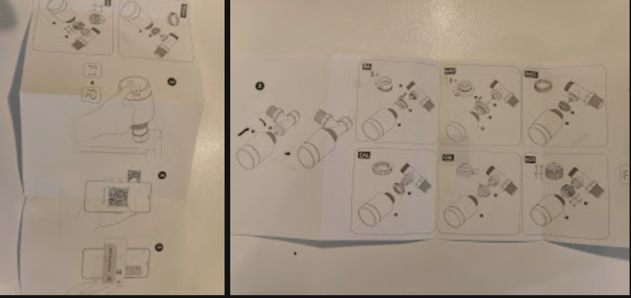

Documentation
Documentation is light and hardware installation will be not easy to follow for newby. For my case, I only need to screw a ring around the valve and install the device into the ring. Hardware installation is done. Very easy when you finally find what combinaison is needed.
Screw this ring into the valve:

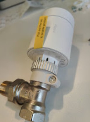

Screw the TRV into the ring. The result should be:
Then remove the yellow tape to connect the battery.
The W600 is now in pairing mode.

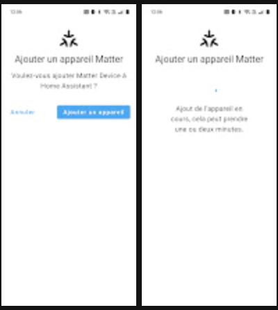

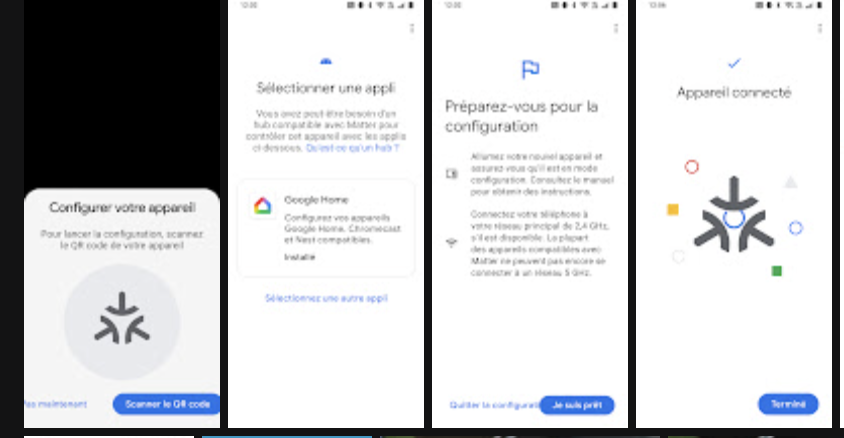

Pairing

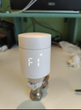

Once the tape is removed, the thread pairing starts automatically on the mobile phone (installed with Home Assistant companion) and the device display the F1 message.
Follow the screen, select Home Assistant application
A few second later, the device is connected.
Then you must create the matter device:

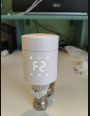

During the pairing journey, the W600 switch to F2 state. You will then have to click 3 time quickly on the button:
This journey is very simple, works as a charm. This is the magic of the Thread / Matter pairing method.

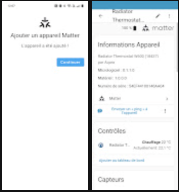

Entities available in Home Assistant

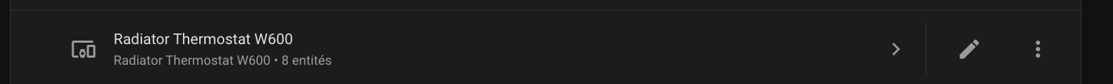

Go to home assistant, search for the Matter integration and find your W600 TRV. You will find these entities:

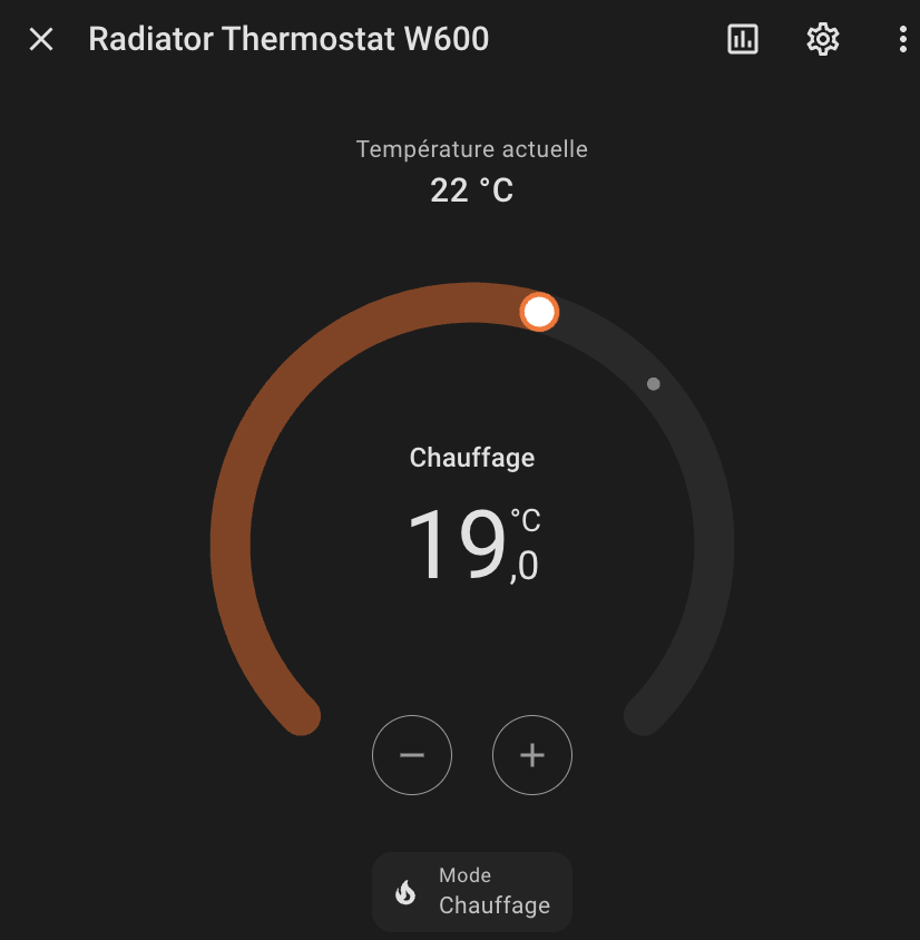

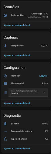

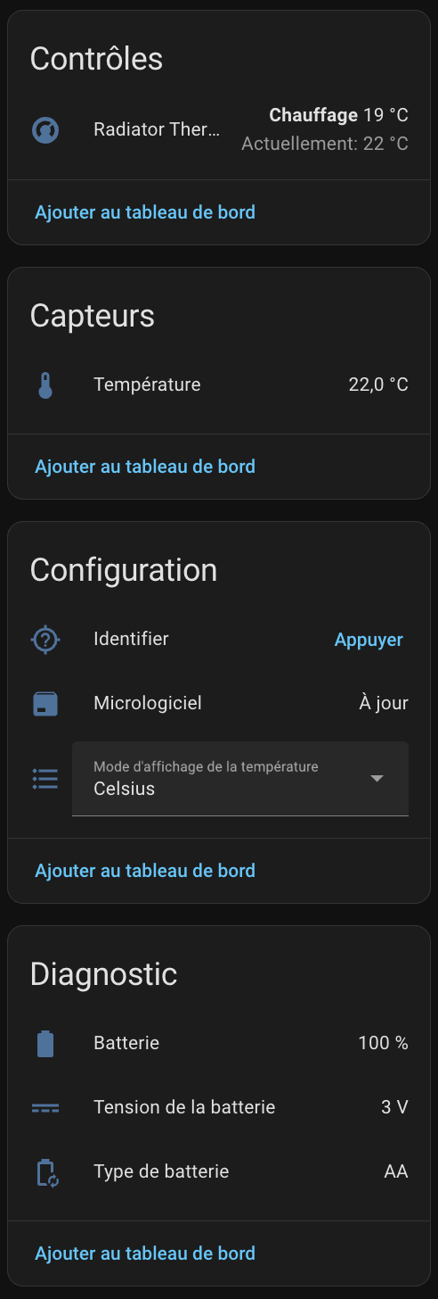

The entities contains a climate and the internal temperature sensor value:
And that is all for control entities. This is very deceptive. Modern TRV have direct valve opening degrees control, offset calibration, external temperature sensor, timers, schedule, …
I wonder if this limitation is due to the TRV itself or to the matter over thread protocole.
Other entities contains the temperature unit, the batterie status and informations.

Turning the button or clicking is responsive. Setpoing updates within 2 sec in the HA climate entity.

The only bad point is the control entities which are available in Home Assistant. I don’t know if this is due to matter or thread or the device itself but this is a deceptive point.

It’s because matter still has limitations; it’s the same for locks, it’s not possible to expose some things
