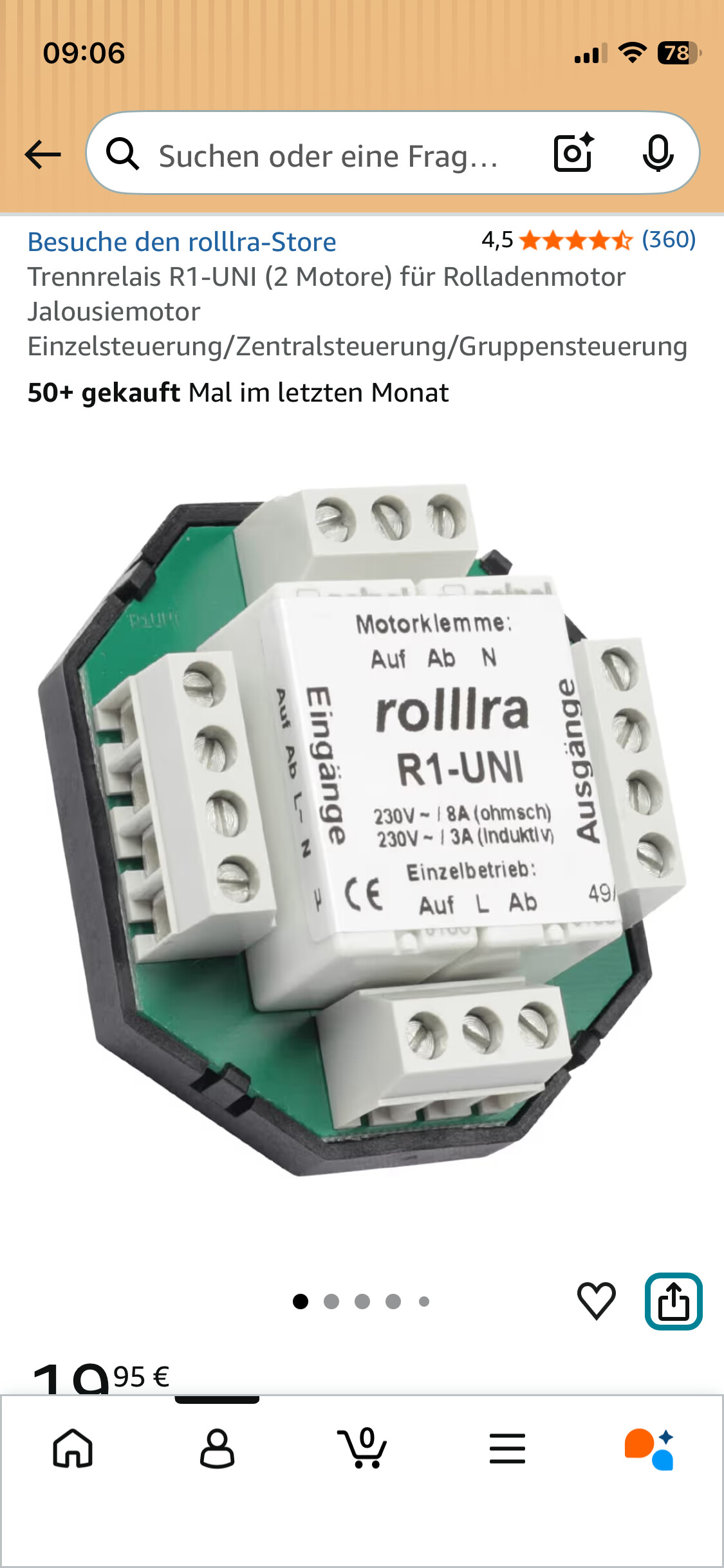

I have a problem with an Aqara Shutter Switch H2 EU controlling two roller shutter motors.
My setup is:
Aqara Shutter Switch H2 EU → R1-UNI separating relay (Trennrelais) → 2 roller shutter motors
Both motors should always move together, so I would like to keep using only one H2 switch.
The problem is the automatic end-position/load detection.
Originally, the H2 stopped after approximately 2 seconds because the load through the R1-UNI was apparently too low. I already tried adding base-load elements (Grundlastelemente), and this solved the 2-second shutdown problem.
However, calibration still does not work correctly.
I have tried Smart Calibration and Custom Calibration several times. I also set the current-based motor stop threshold as low as possible (1 W).
To test the problem further, I temporarily installed two physical ON/OFF switches in the UP and DOWN control wires between the H2 and the R1-UNI. This allows me to manually interrupt the load signal during calibration.
