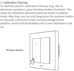

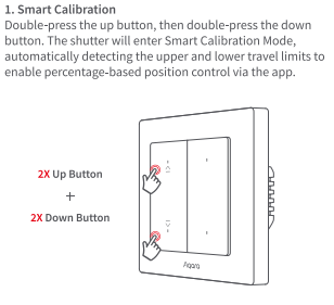

Hi. Where exactly is the problem with the calibration?
You can perform a calibration directly on the device. There’s no need to do it in a vendor-specific app. Either the “Smart Calibration” or the manual / passive calibration — see the manual:
Images Source: Shutter SwitchH2 EU User Manual
