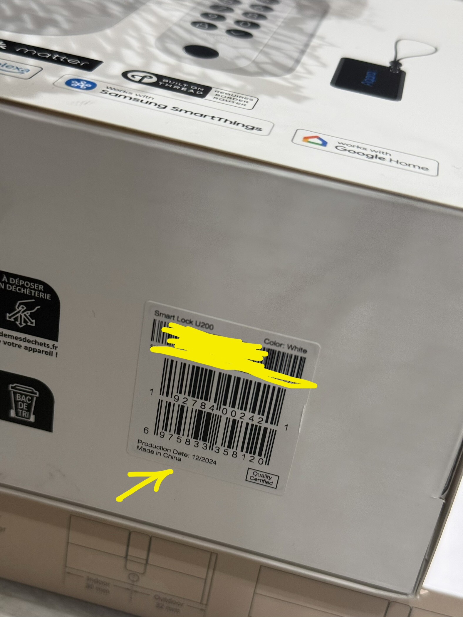

Hmmm sounds for also a little with the grease issue. Which production date is your U200?

My U200 was manufactured on 12/2024 but in my case the failure was not caused by the grease, but by the mortise lock. You can read about my misadventure here.

How can I tell? Cannot find on the box nor via the app. Can check on the lock itself within short.

It’s on the box, under the barcode

It’s on the box outside a small white sticker
