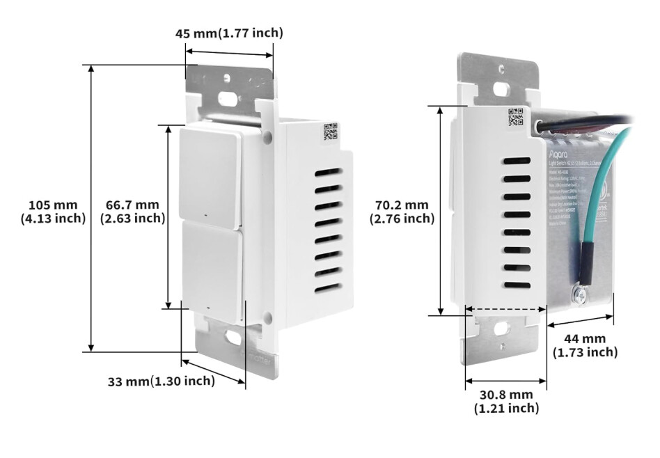

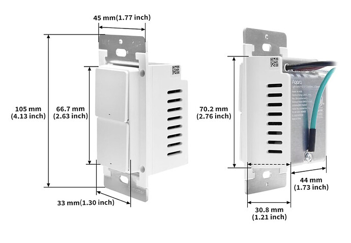

One thing I really want to do is swap out my wall switches to wired smart switches. My problem is I live in a home built in 1960. The electrical boxes are all too shallow and narrow to fit smart switches. I don’t want to use remotes. That is how I have things set up now and I want to get away from so may remotes. I have been able to change out 2 switches in a 3-gang box, because the third switch that was in it didn’t work. It was supposed to control my lamp post light, but it never worked so I removed the lamp post and switch. That was gave me a little more room to add the 2 smart switches.
I also don’t want to have to pay an electrician to swap out the boxes. That would get too pricey.
I wish Aqara would make some “small box” switches. I know it takes up room to have the smarts of it, but there are some brands that have a smaller or not as deep form factor. Zooz is one, but I would rather have Zigbee or Matter. Zooz only has Z-Wave in those versions so far.
Hi Netwitz, thank you for your interest in our product. Currently, the base of our Light Switch H2 US is indeed a bit thicker. We generally recommend two solutions: one is to replace your wall box with one that has a depth of at least 50mm, or you could try shortening the wires a bit when connecting them, which might save some space. Alternatively, you can consider our first-generation product, the Smart Light Switch, which is slightly thinner. Making our products slimmer is definitely a direction we are working hard toward in the future.
