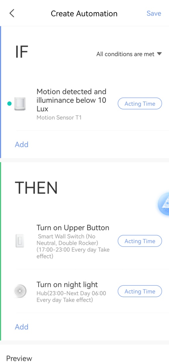

Does anyone else face this issue: turning on the main bathroom light when getting up late at night feels way too bright and harsh?
I usually sleep around 11 PM, so my requirements are:
  • Outside Sleep Hours (Before 11 PM): Turn on the main light when someone enters the bathroom.
  • During Sleep Hours (After 11 PM): Turn on only the soft night light when someone enters the bathroom.
My setup: I installed a motion sensor, a smart switch, and an M1S gateway with a built-in night light in the bathroom.
The key trick lies in configuring time periods within a single automation:
  • For the “Turn on Bathroom Main Light” action, set the active time period to 17:00 - 23:00.
  • For the “Turn on Night Light” action, set the active time period to 23:00 – 06:00.
This allows a single automation rule to intelligently switch between different lighting modes based on the time of day.

Create 2 automation and add the time in the acting time section. This way it will work.
