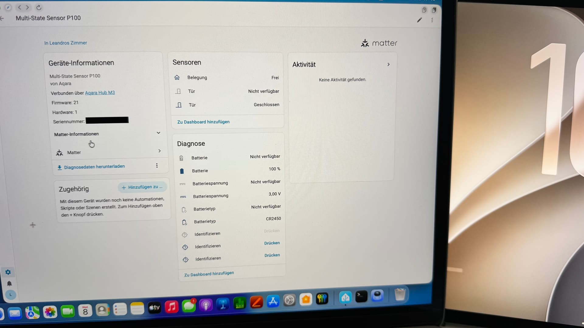

Aqara updated the way the P100 “provides” its sensors via Matter and HomeKit.
Recently, I updated my Aqara Hub M3 to the newest software (stable release).
Today, I wanted to give my P100 a new place to live and had to change the name and entities in Home Assistant for the new usage.
Every old entity in Home Assistant is now no longer available. Apple Home also doesn’t know something about the device. The old entities are gone and the new… Home Assistant adds them… Apple Home adds them as ‘brand-new’ sensors.
This also means, that your Automations may not work.
(Automations in Aqara Home will still work perfectly fine).

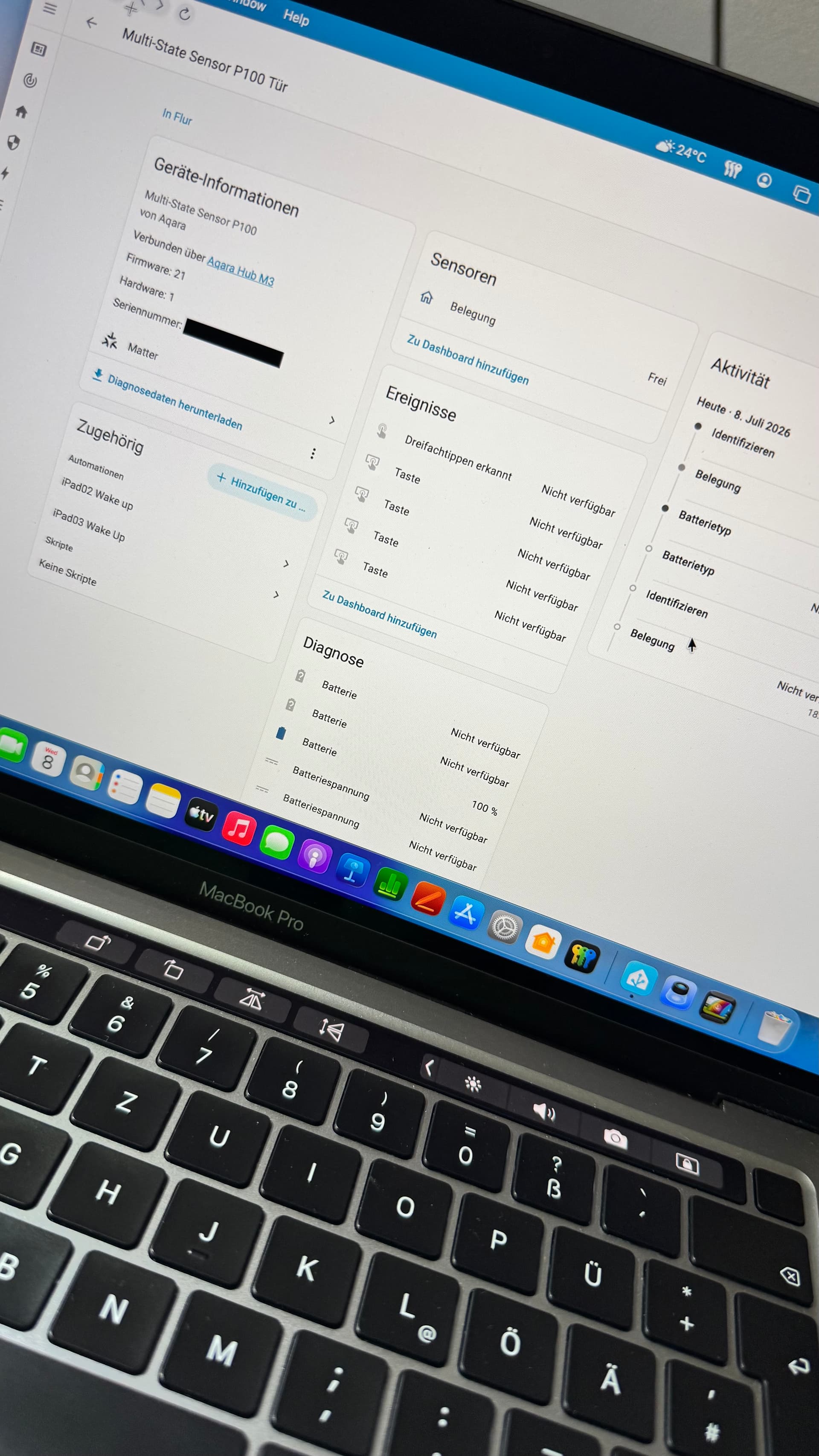

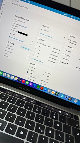

If you were using the P100 as Door/Window sensor, you get a new ‘Contact Sensor’/‘Door’ Entity.
  • the battery state, battery type, identify, …
The biggest change (for me):
If you were using the P100 with Object Monitoring (like Vibration or triple-tap detection,…), you now no longer need to deal with these ‘button’ Entities. They got replaced with classic sensors (in Home Assistant a classic ‘binary_sensor’ and in HomeKit a motion sensor).
Unfortunately, the ‘new’ sensors didn’t work and don’t show any changes. So for now, the P100 is useless in other Smart Home Systems then Aqara Home.

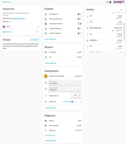

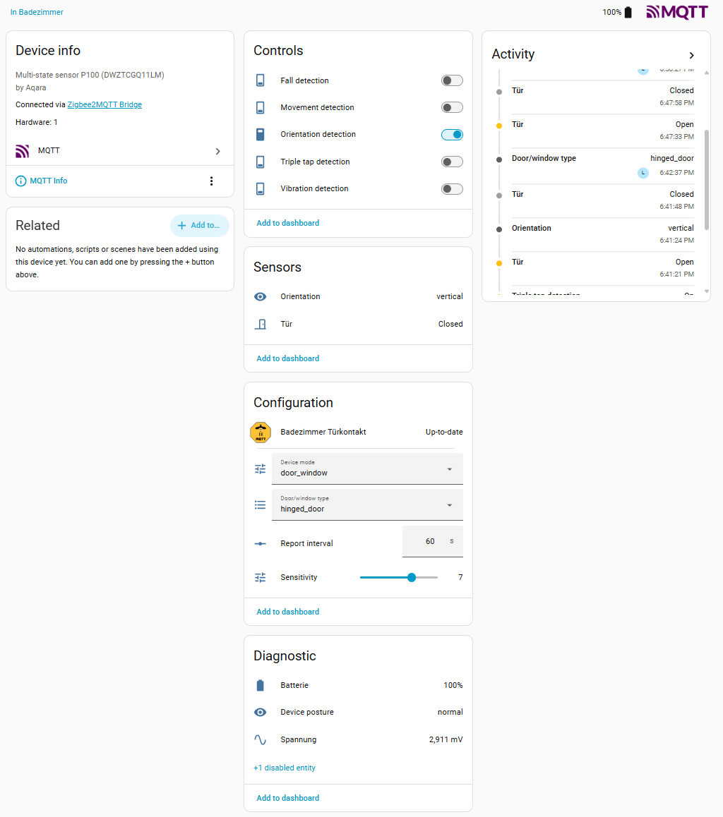

Thanks for the heads-up! Good to know, II think I’ll just stick with MQTT for now, even though I actually wanted to switch over.
I haven’t actually tested the object mode myself yet, but according to the Zigbee2MQTT documentation (Aqara DWZTCGQ11LM control via MQTT | Zigbee2MQTT), it should work without any issues.
By the way, this is what it looks like in Home Assistant:
I hope your problems get fixed soon!
