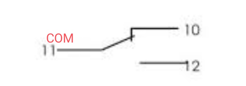

If you need a common COM for NO and NC, then such a function can be implemented in T2.
Can you please clarify? As far as I understand, the relay in the T2 is a SPST relay.
I want to implement three-way switching.
Theoretically, if you have a common COM, by selecting the interlock function you simulate NO and NC.
